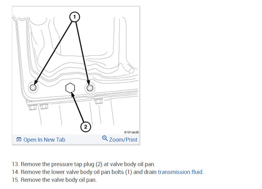

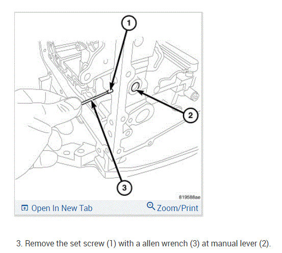

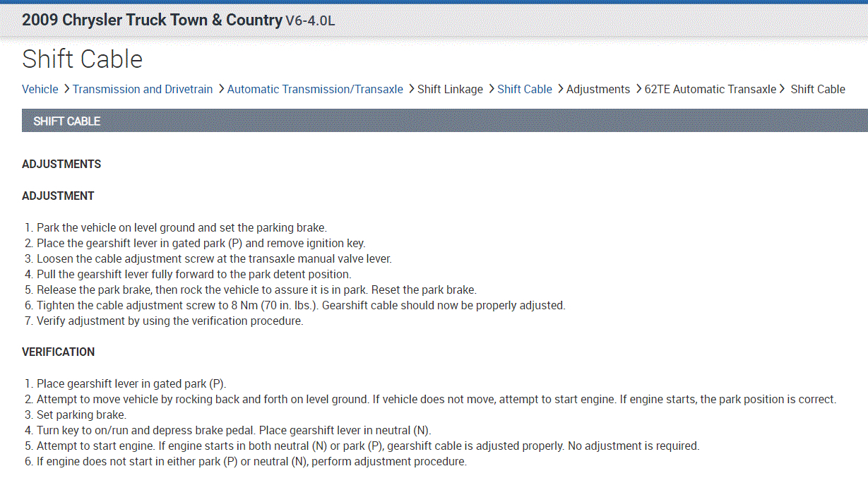

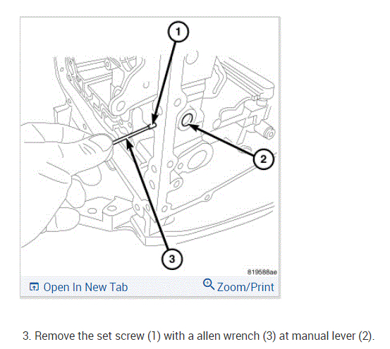

once I stick my key fob in the ignition it might start up but once I put it in neutral it starts right up with no problems.
May 8, 2021 at 5:51 AM
  • 110,244 POSTS

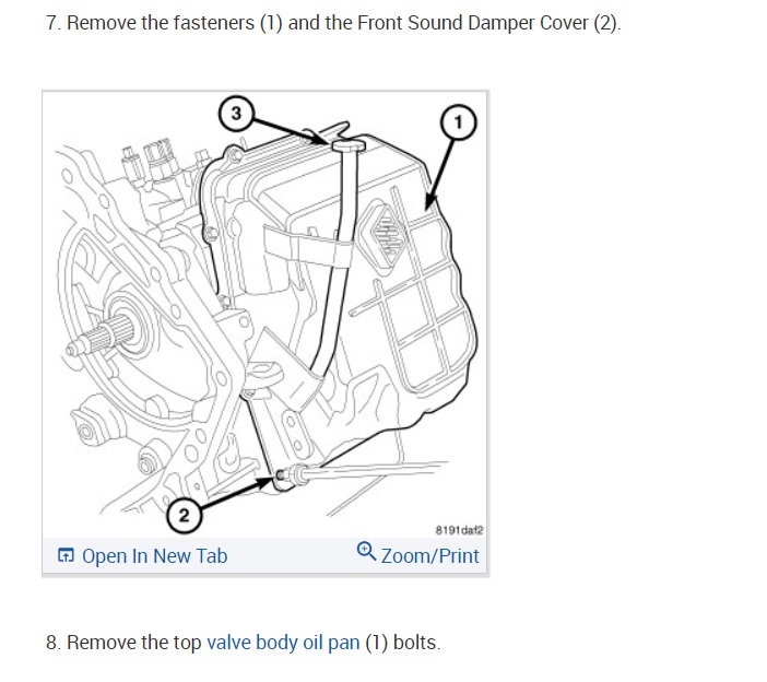

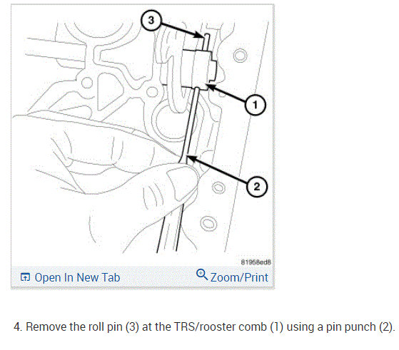

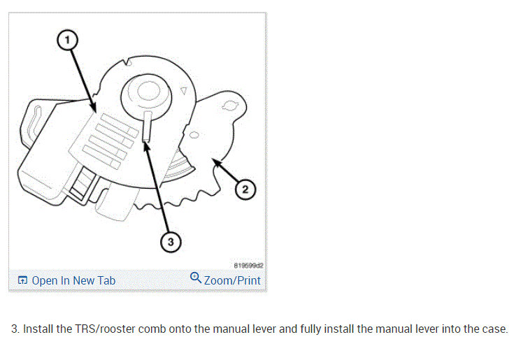

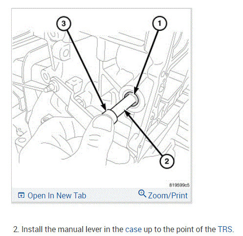

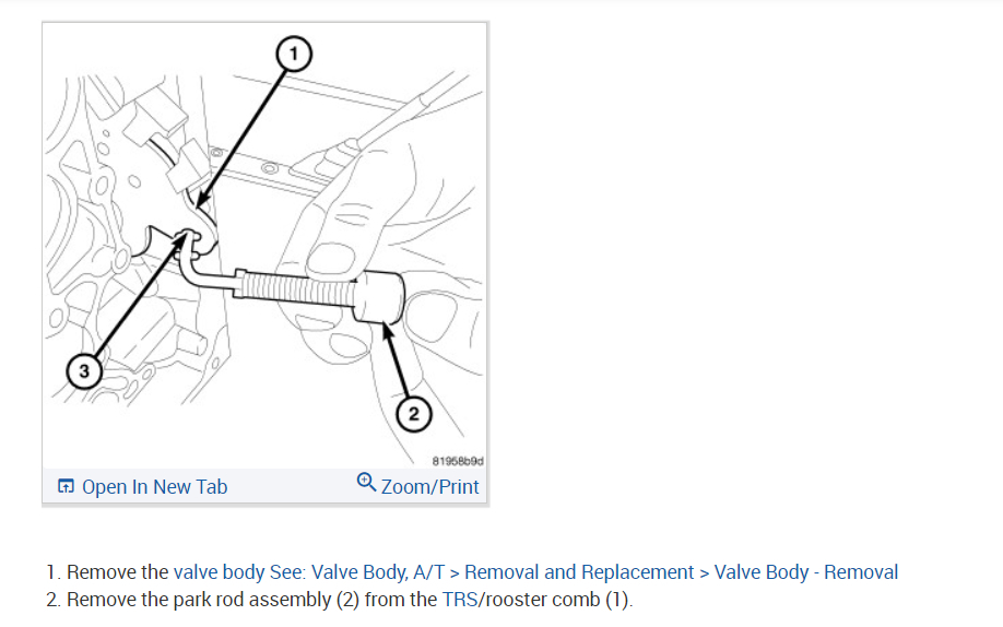

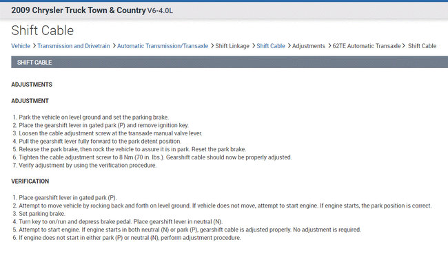

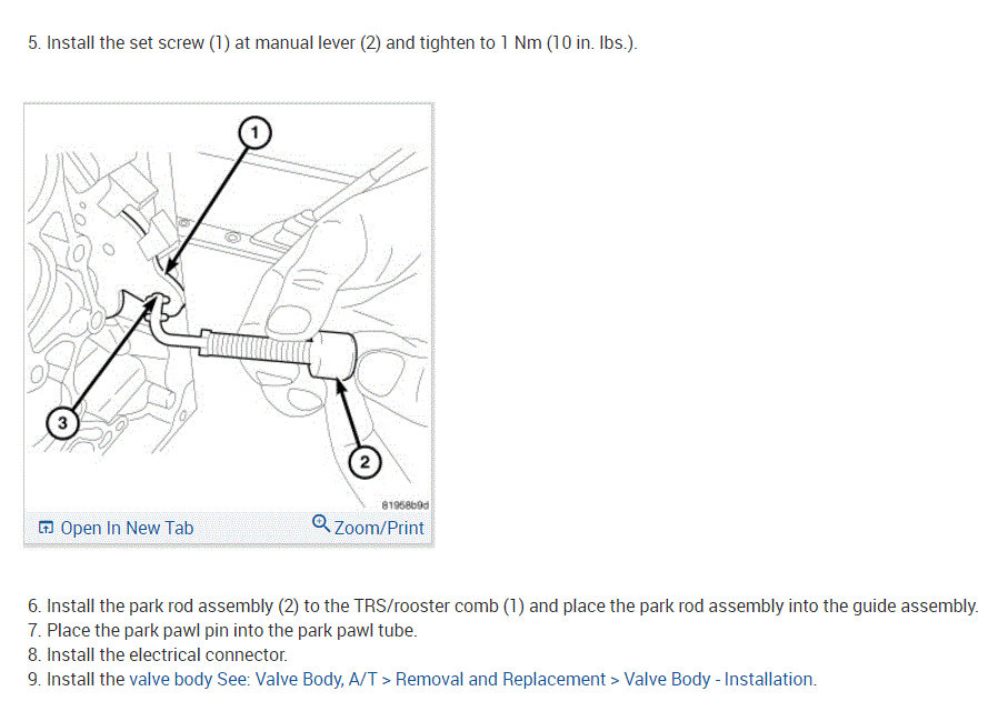

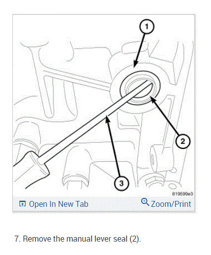

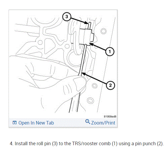

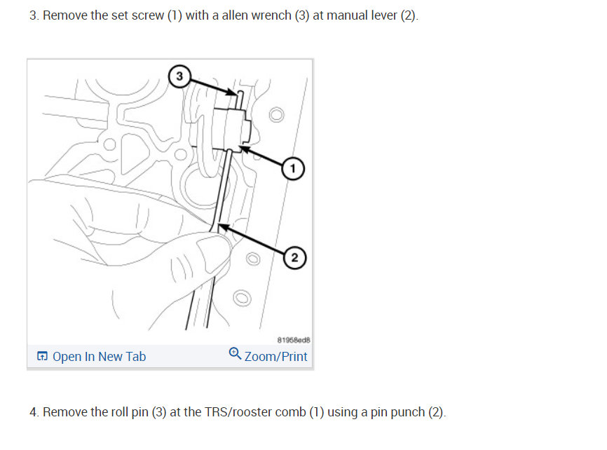

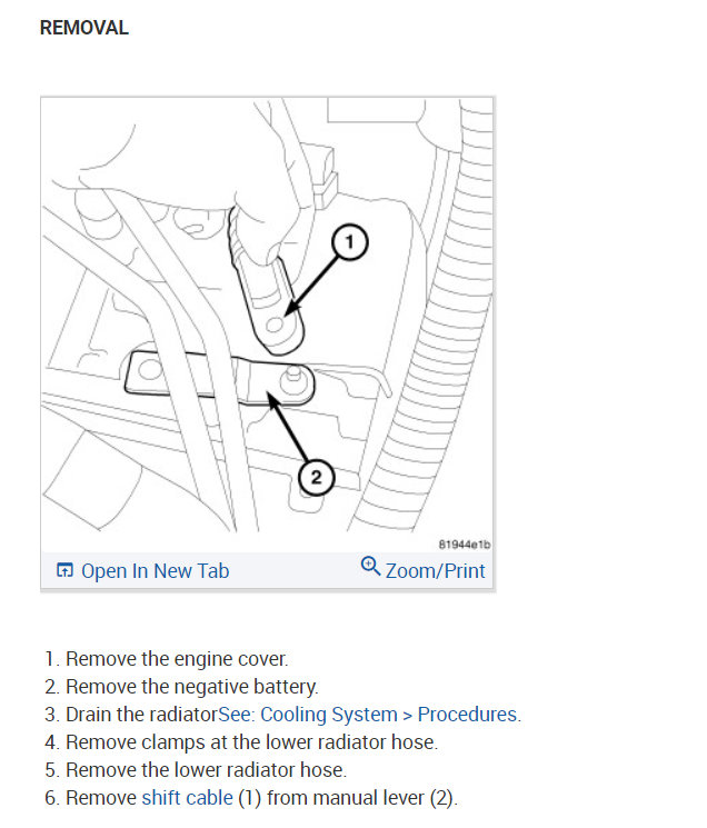

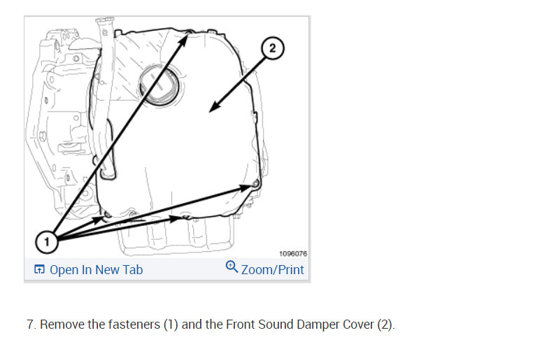

When it doesn't start, does the gear indicator show park? It could simply be a linkage issue or the sensor that you mentioned.

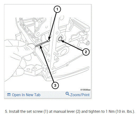

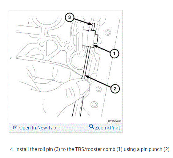

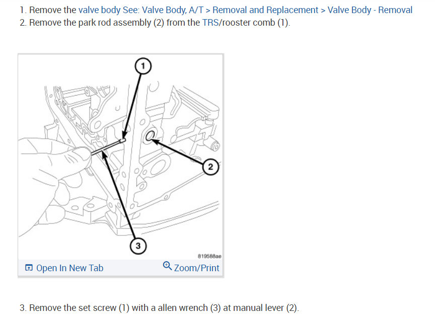

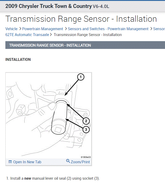

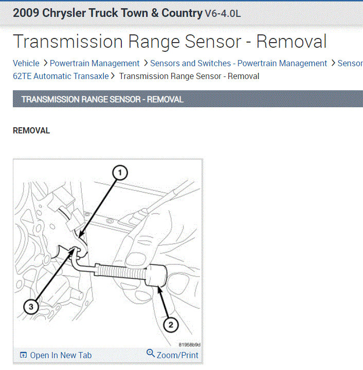

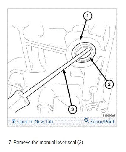

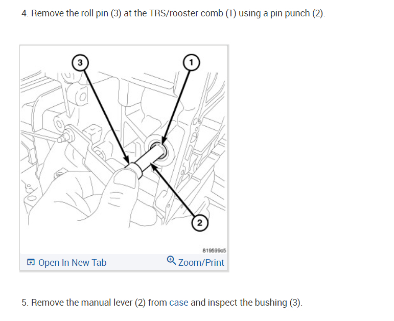

If you look at the first pic below, it explains how to adjust the shift cable. So, if it doesn't indicate park but instead shows reverse, try this first.

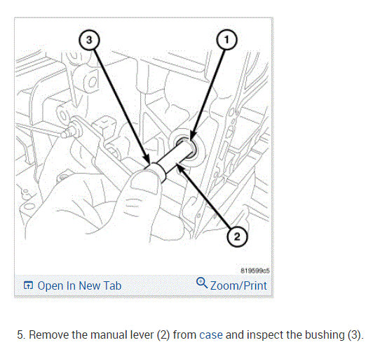

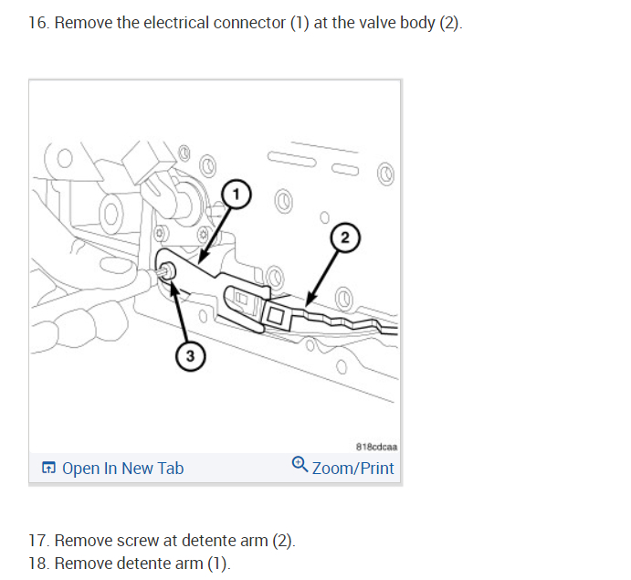

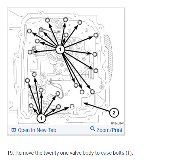

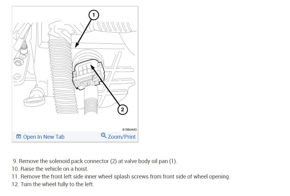

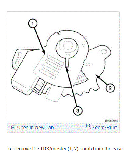

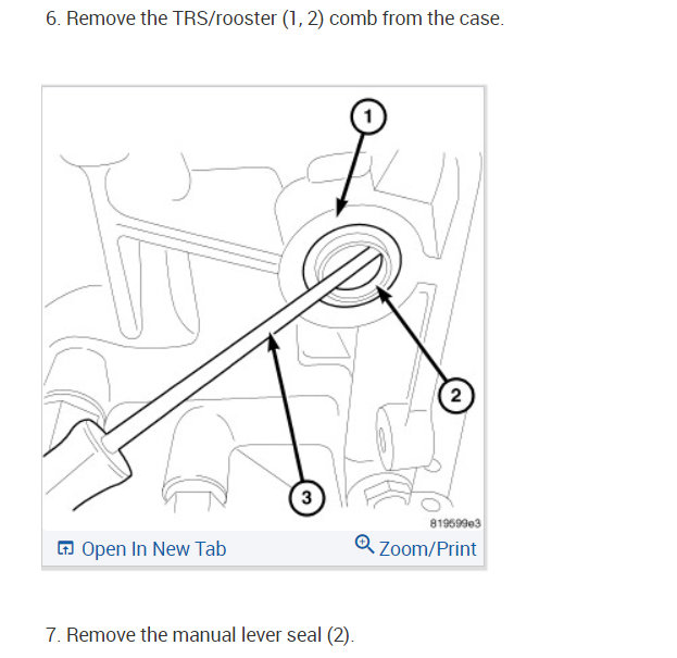

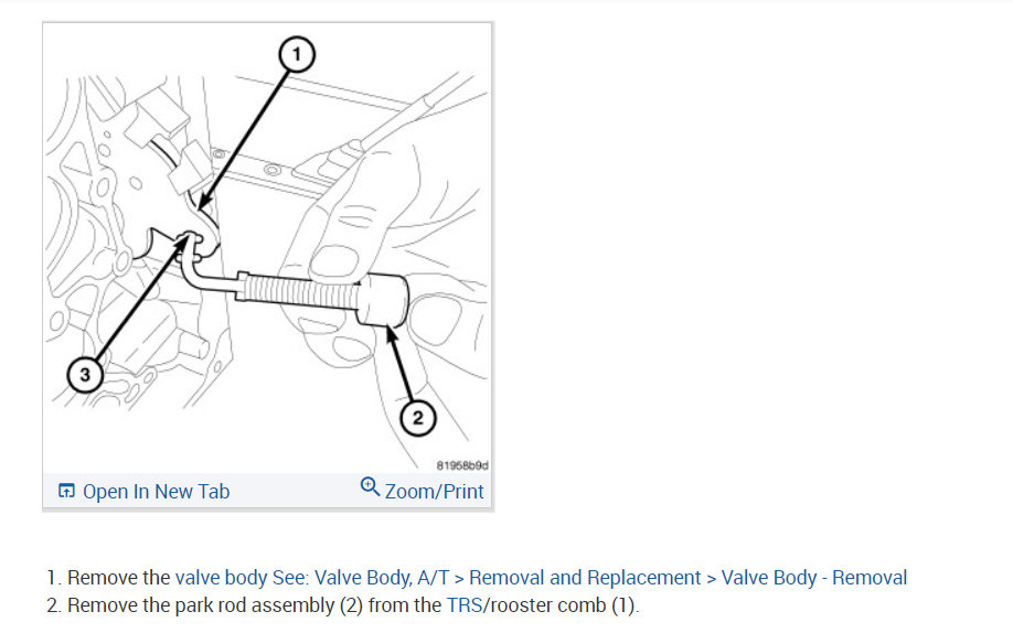

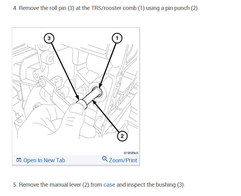

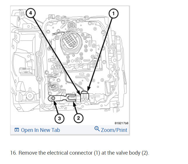

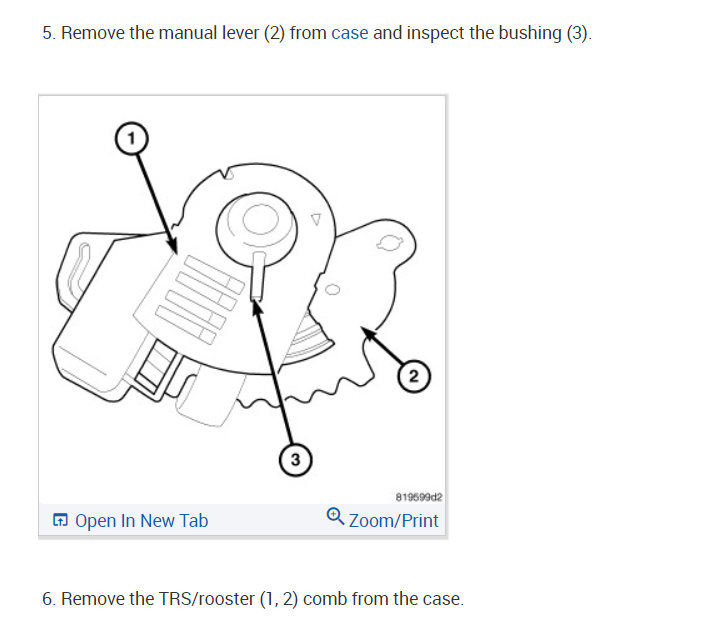

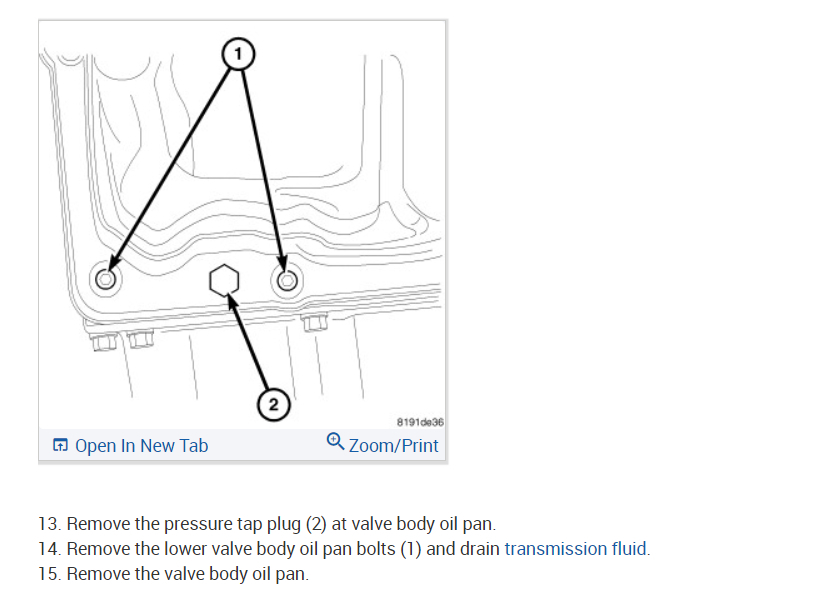

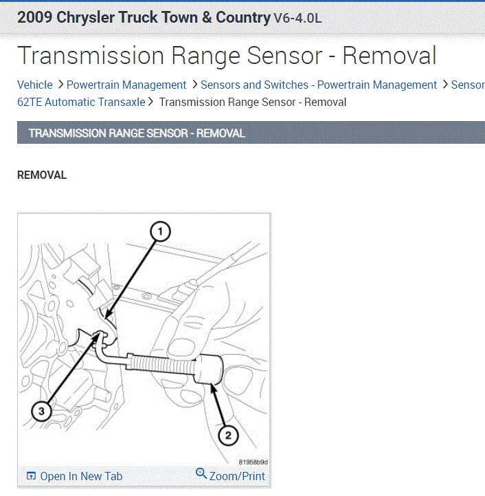

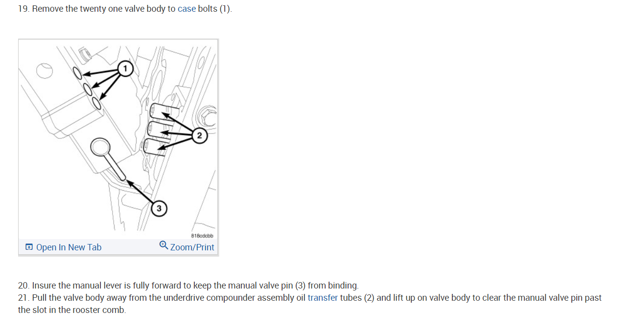

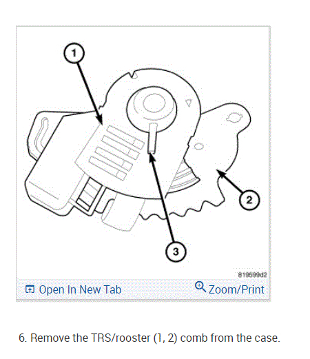

The remaining pics are the removal and replacement of the transmission range sensor. To access the range sensor, the transmission pan and valve body will need to be removed.

Yes, it shows the gear in park while trying to start.
May 8, 2021 at 10:36 PM
  • 110,244 POSTS
Okay. If the indicator is showing park, it sounds like the range sensor could have an internal fault. If you take it from park when this happens and shift through the gears and back to park, will it start? Based on what you are telling me, chances are it is the sensor.

Hi Tiffany, I just responded to the other post for replacement. LOL As far as a range sensor, the first indicators are usually the gear indicators are not operating or not correct. I mentioned in the post that if it doesn't show a P when in park and there are no lights on, the sensor is likely the cause. However, if it shows R (reverse) when you place it in park, it could be something as simple as adjusting the shift cable. I did indicate how on the other post as well.
Other symptoms can include the vehicle not starting, not shifting into the correct gear, the vehicle driving in what is called limp mode, and so on.

Good afternoon,
Yes, that is a definite possibility for this issue.
I attached the procedure with some pictures below for you. The switch is inside the transmission. The valve body has to be removed to gain access.
