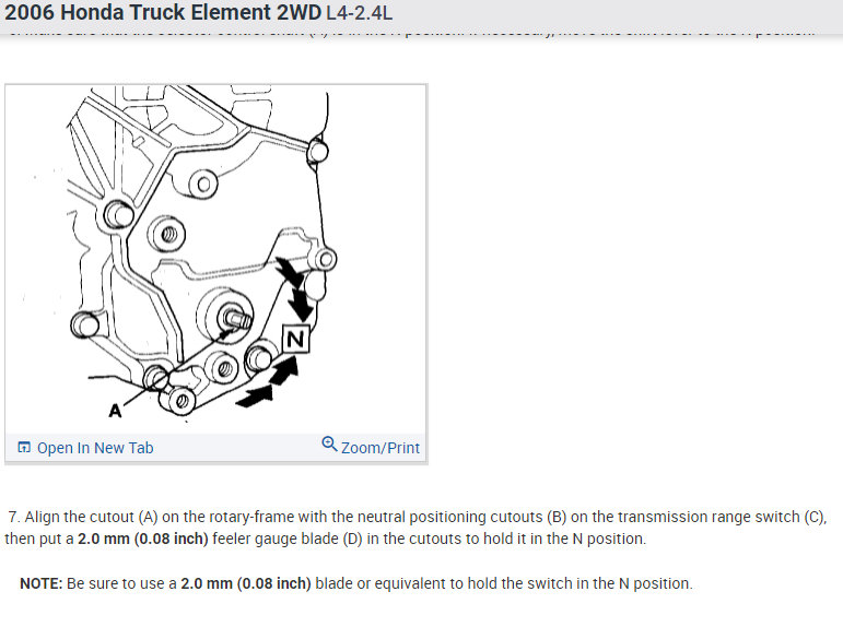

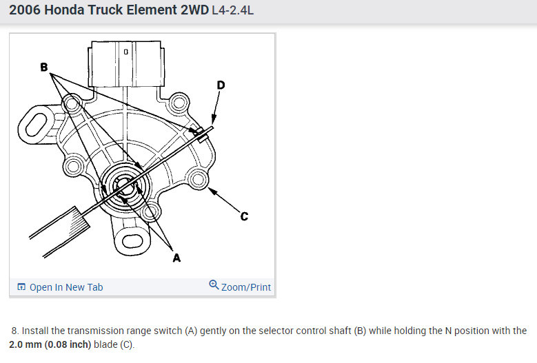

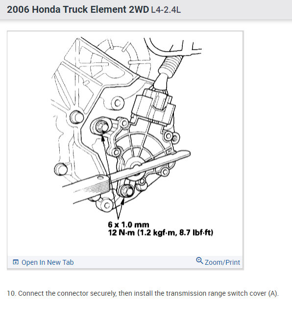

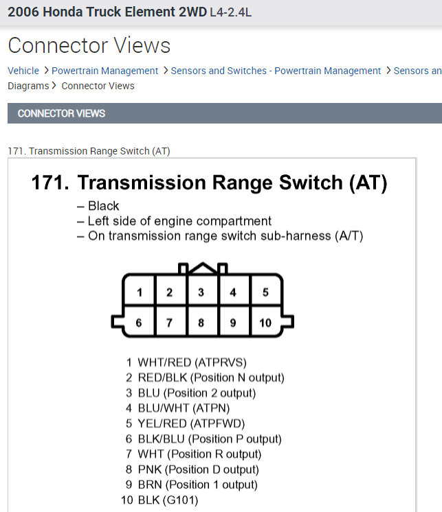

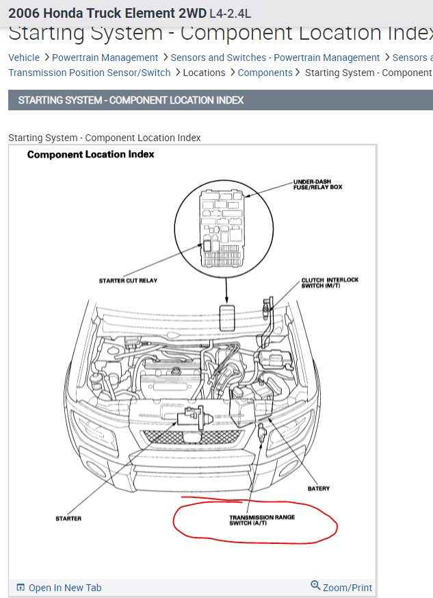

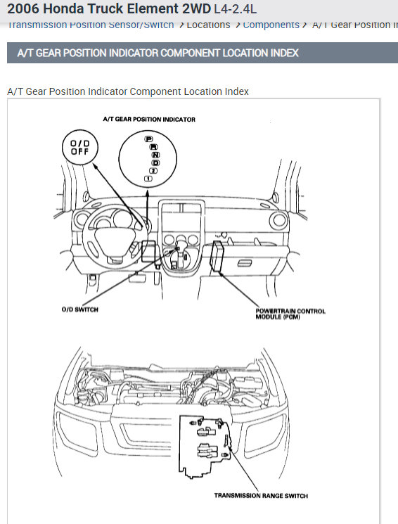

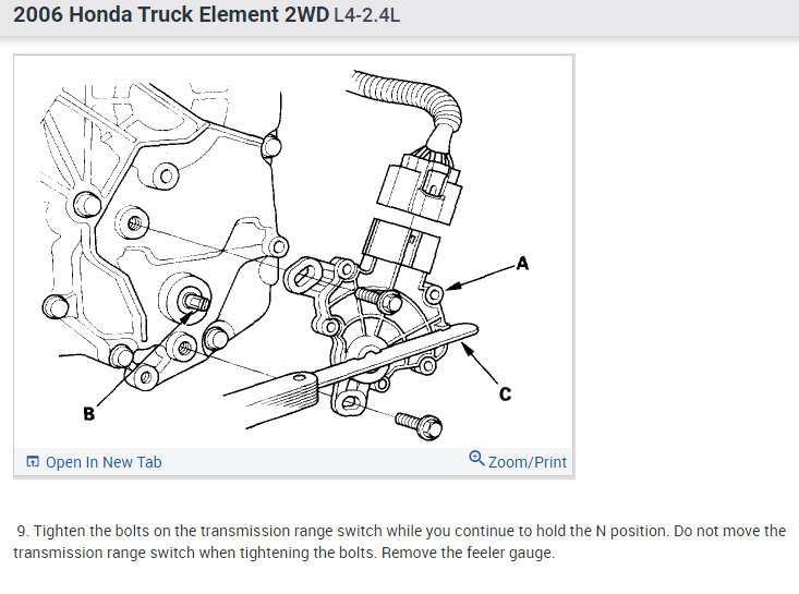

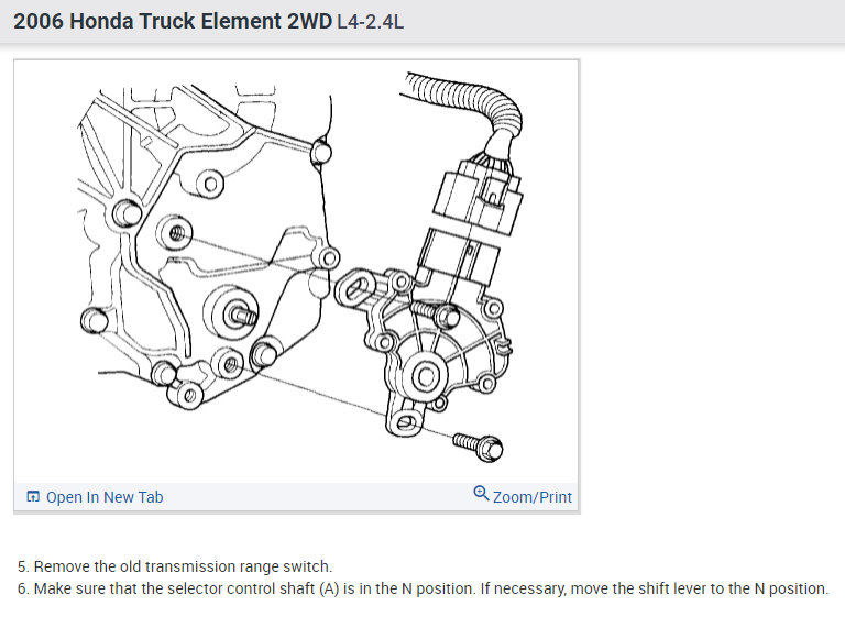

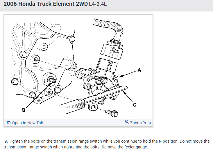

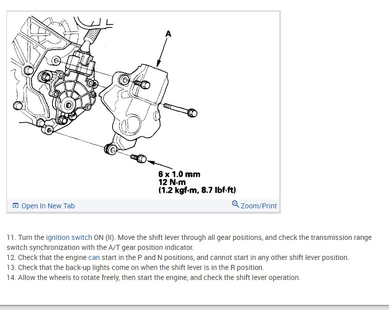

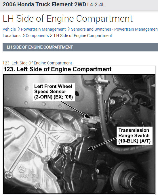

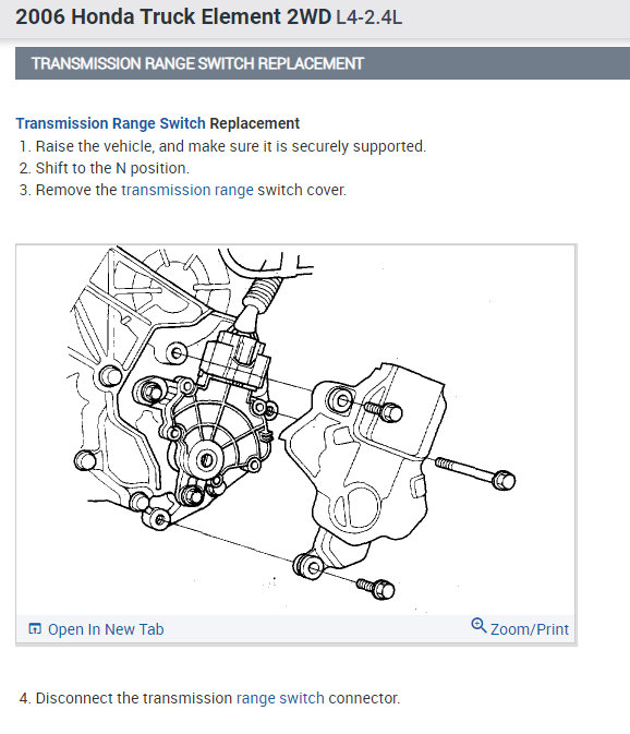

Could you tell me where to find and how to get at the Transmission Range Sensor on my vehicle listed above? A photo would be helpful.
Sep 15, 2021 at 10:23 AM
SQM
  • 6,383 POSTS
The transmission range switch is located on the right hand side of the engine compartment (when you are facing the engine), lower part.
I have attached diagrams with the location as well as replacement procedure.
