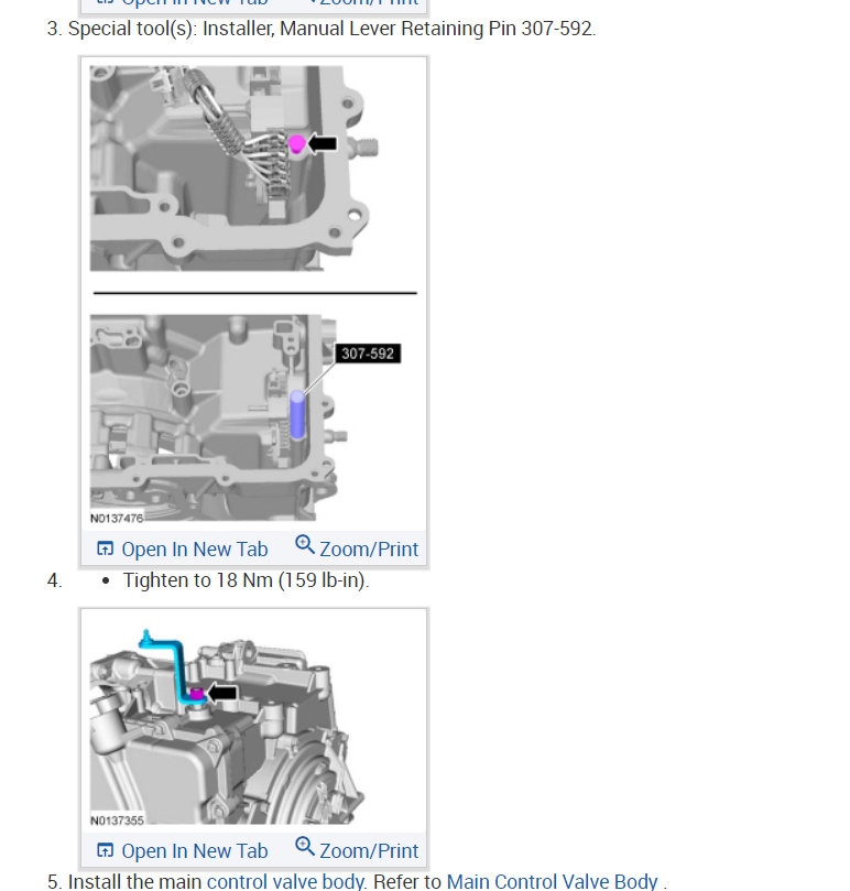

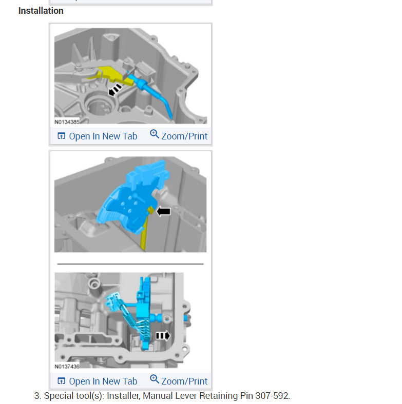

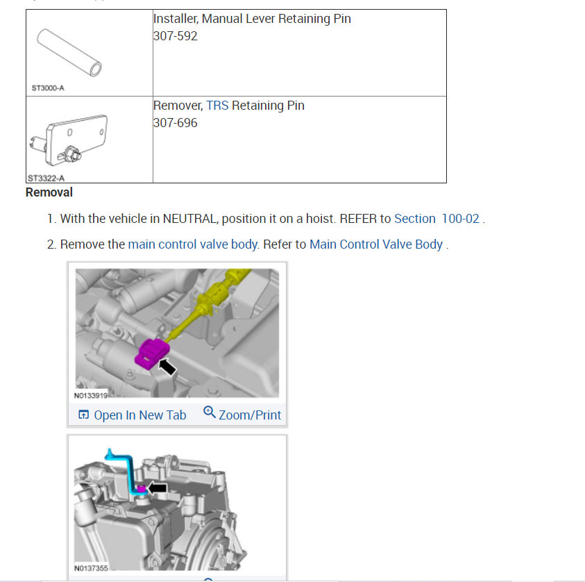

Diagnostics is saying to replace the transmission range sensor. I don’t know the location.
Apr 29, 2021 at 12:58 PM
Good morning,
I attached the procedure for you below for the transmission position switch. Check out the diagrams (Below). Please let us know if you need anything else to get the problem fixed.
