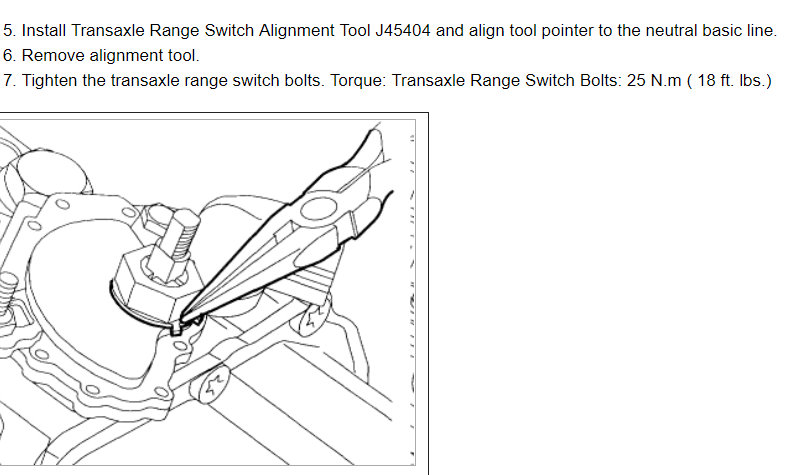

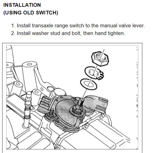

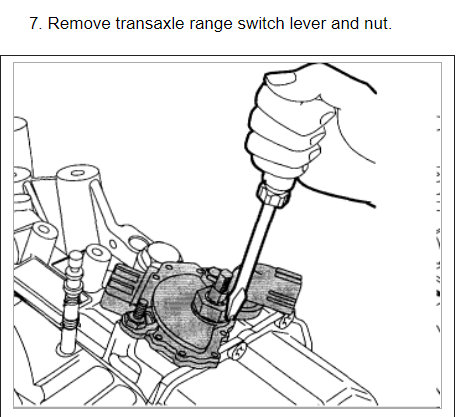

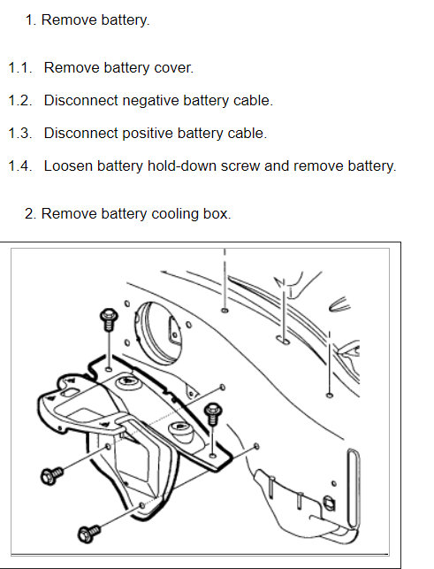

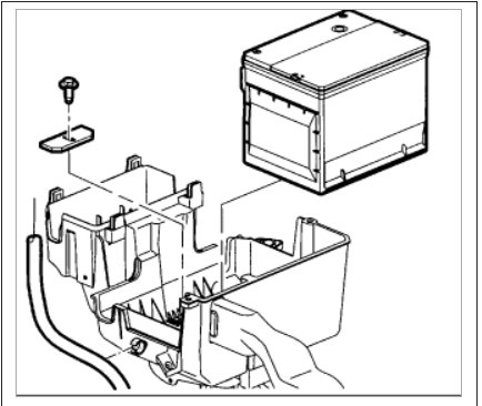

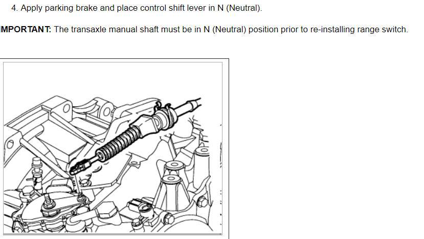

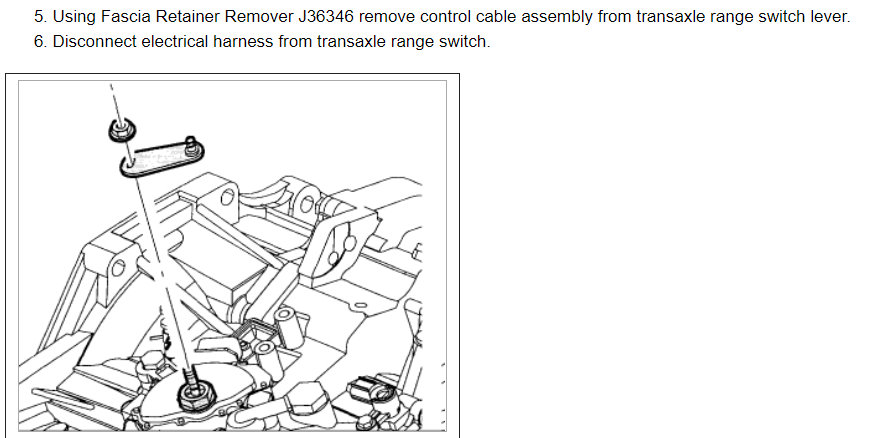

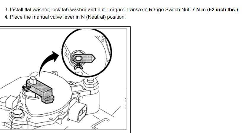

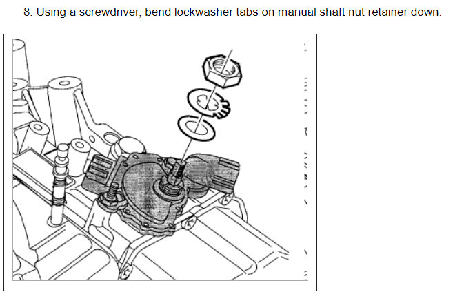

How do I change the transmission range sensor?
Sep 24, 2016 at 5:20 AM
Experienced Mechanic
55,770 POSTS
You will need to start by setting your emergency brake and disconnecting the battery. Here is a guide that will help you get started.
https://www.2carpros.com/articles/how-a-neutral-safety-switch-works
