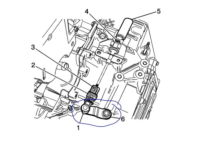

how do you disconnect the mechanical connection/fastener of the transmission range selector lever cable terminal from the transmission manual shift lever pin? I see no nut, screw, pin, or clip holding it on the transmission manual shift lever pin.
Apr 7, 2020 at 2:34 PM

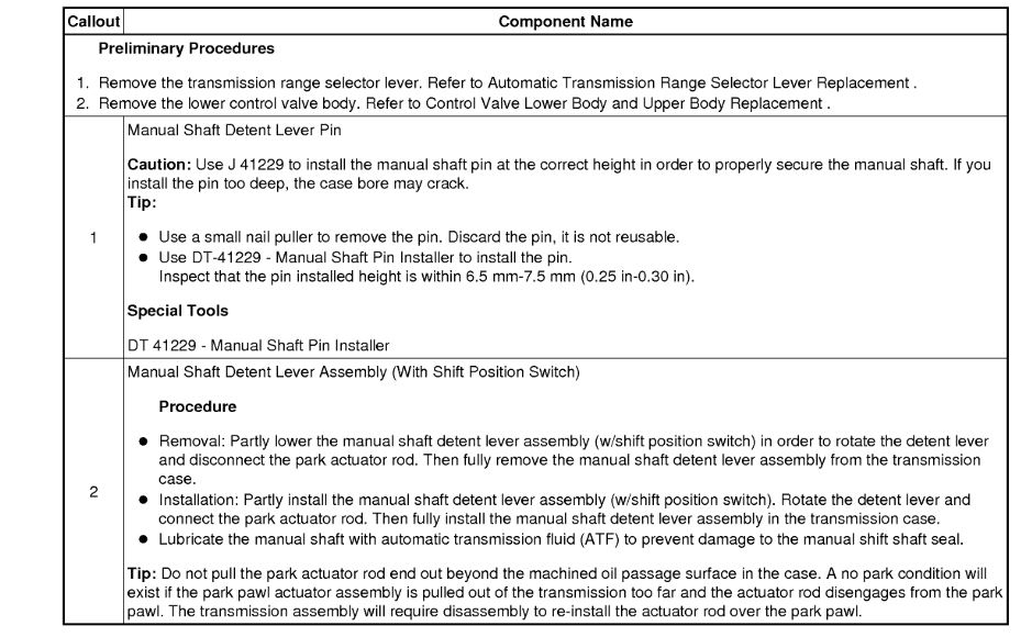

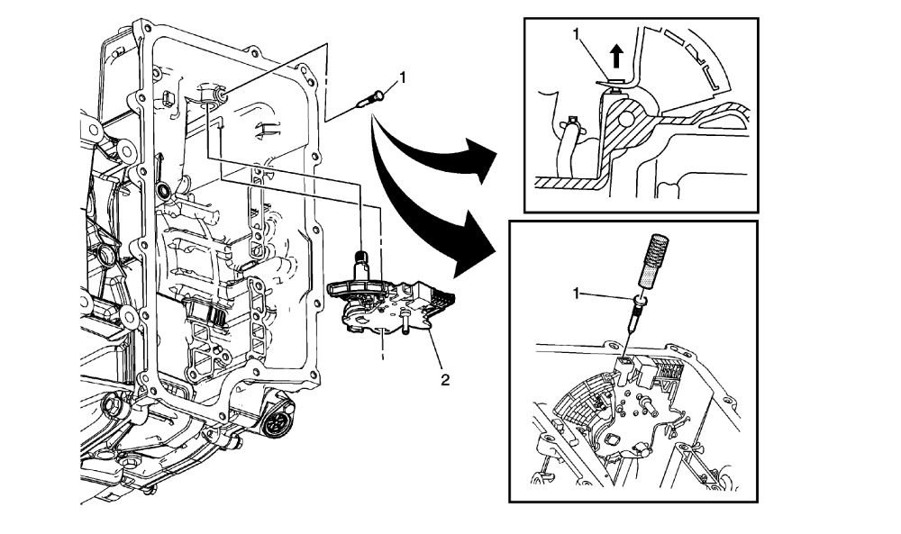

Good evening,
Is this what you are talking about? I attached pictures for you to view.

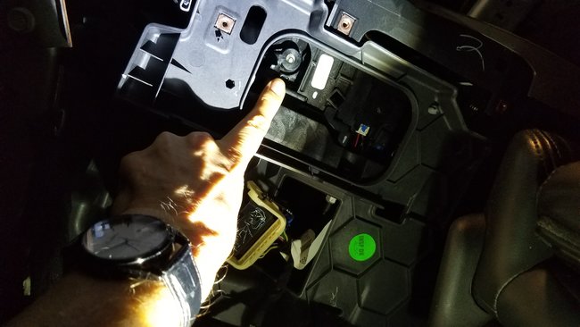

STEVEPECK
The photo is taken from the driver's side right below stick shift. I'm pointing to the connector of the cable. I do not see how it is mechanically connected and I do not wish to damage it in removal. Thank you very much for your help and I look forward to your response.

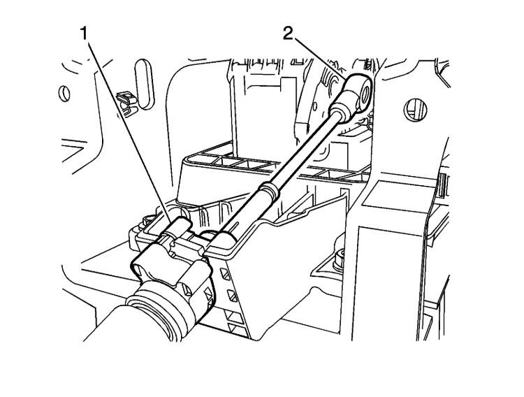

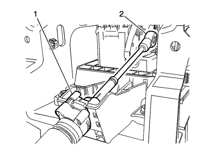

Is this the connection? There should be a retainer clip holding the cable attached.
