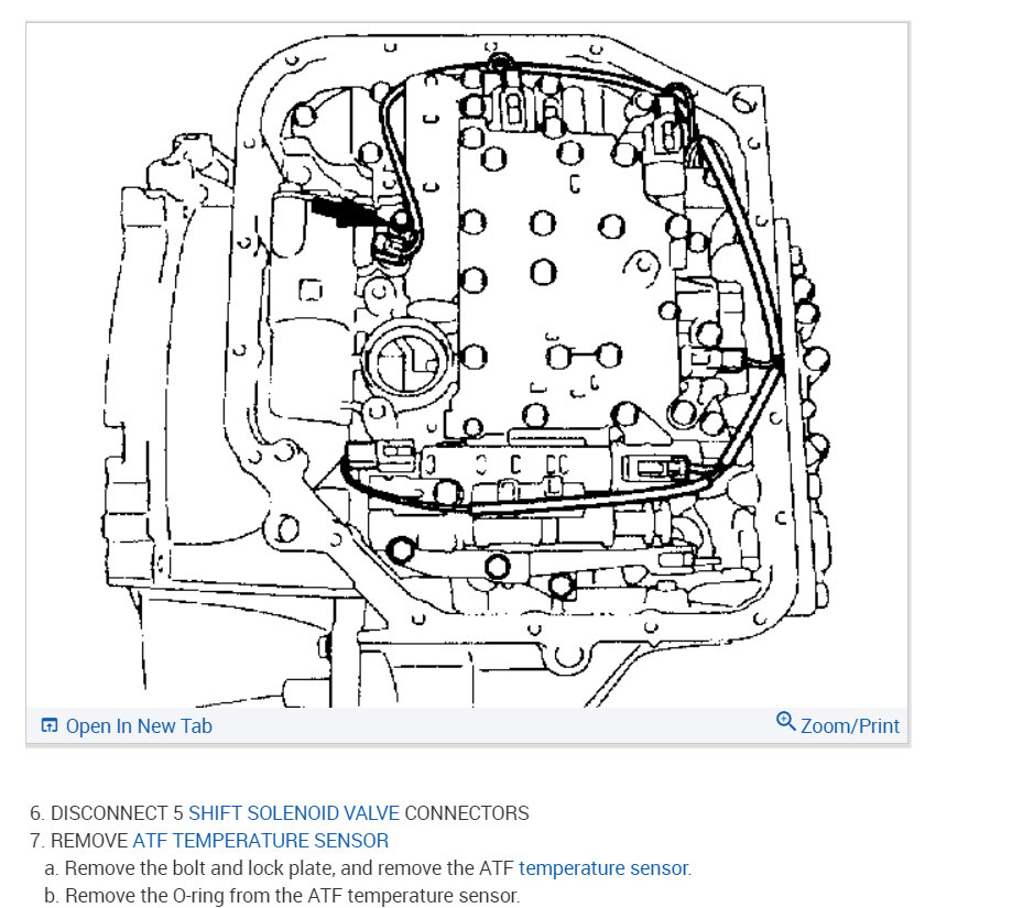

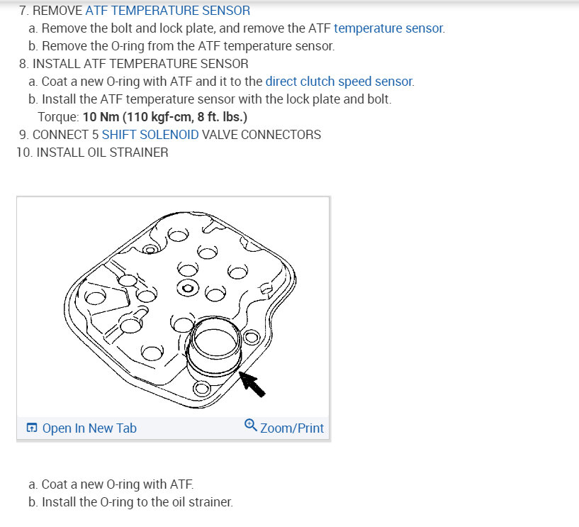

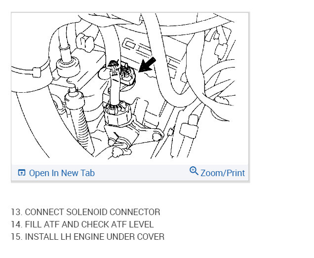

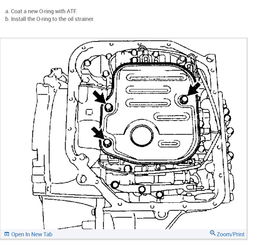

The dip stick is where you add fluid yes, it sounds like the transmission temperature sensor is not working correctly but before we replace it, we should scan the car for codes. here is a guide to help:

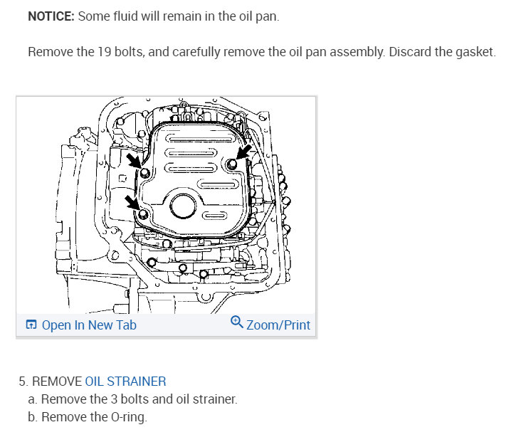

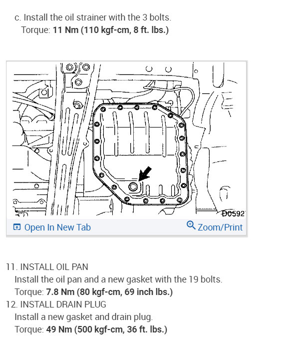

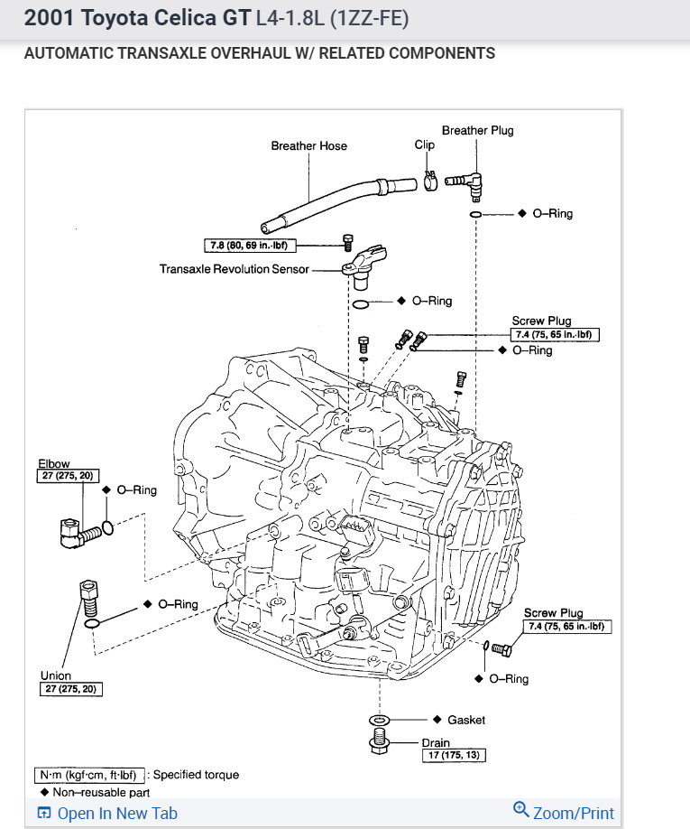

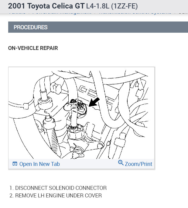

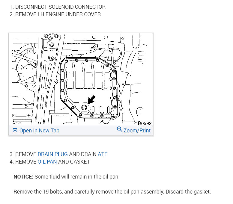

Also, I have included the how to change the temperature sensor out and i would change the filter and fluid as well. This guide can help walk you through the steps with instructions for your car in the images below as well.
Fluid Types
ATF TYPE: .................... Type T-IV
Capacities
CAPACITY: U341 Transmission
Dry Fill: .................... 6.9 liters (7.3 US qts.)
Drain and Fill: .................... 2.9 liters (3.1 US qts.)
It could be the revolution sensor as well; the scan should have a code for it if that is the problem. Check out the images (below). Please let us know what you find. We are interested to see what it is.
