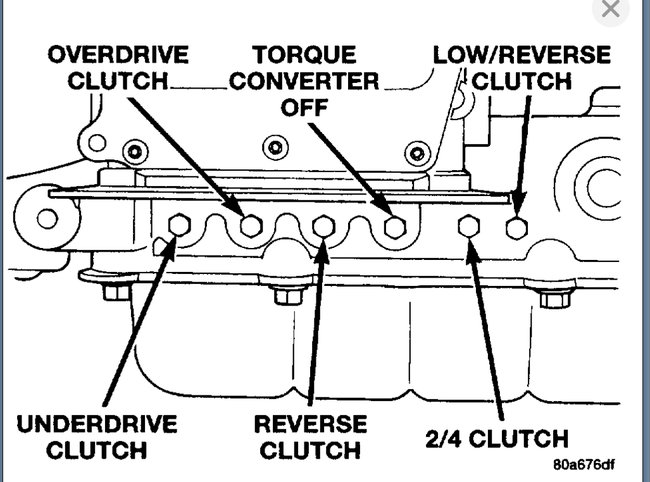

As for the next step after this, we need to actually test the pressure to find out if there is a restriction or the more likely issue that there is a pressure issue/pump issue, or a leak that is preventing the pump from building pressure.
You can rent a pressure gauge from the parts store but here is a diagram of the test ports.
I would get the pressure of each one in park, drive, and reverse and see what they are.

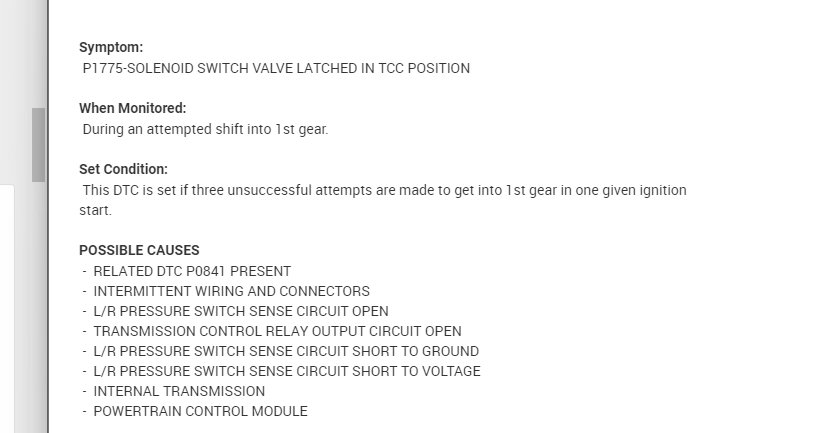

I will drop the engine and replace the torque converter clutch. I want to ask, could this be the reason why the vehicle had been giving this code long ago p1775: solenoid switch valve latched in torque converter clutch position, causing the vehicle to drag at wide open throttle but if you press the throttle slightly, it will move and shift upward gears?
May 29, 2022 at 5:14 PM

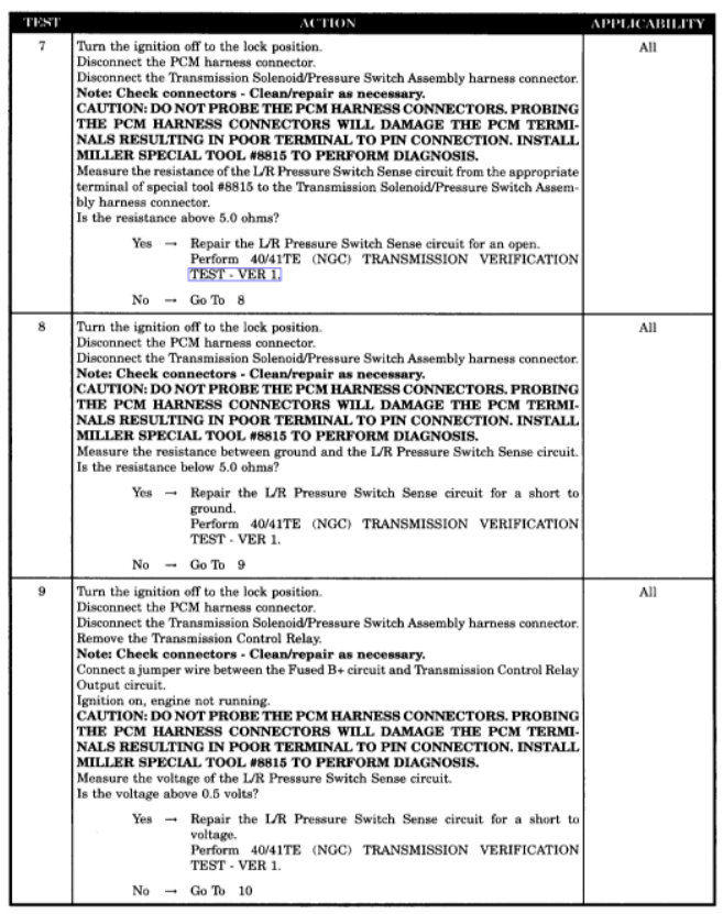

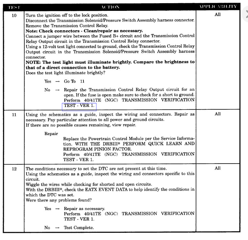

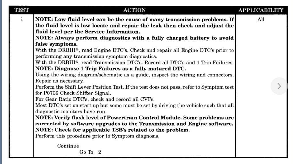

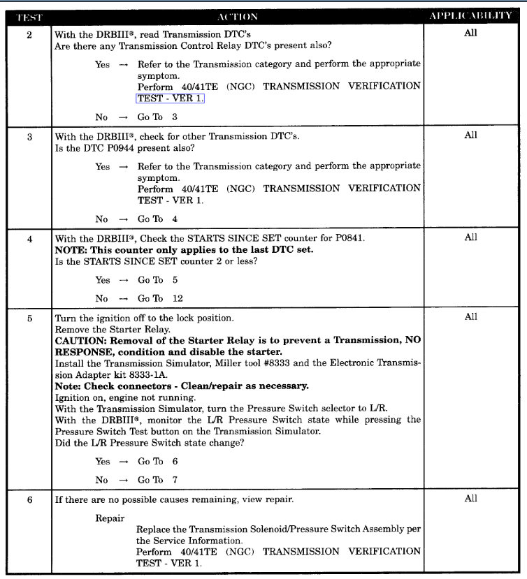

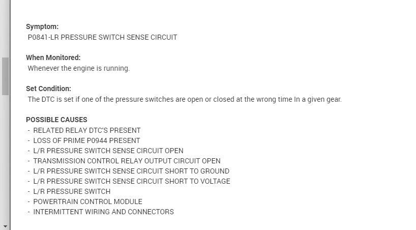

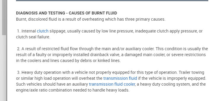

The short answer is yes to all of this. The P1775 leads you to check the P0841 first which you have as well.
So basically, we have an internal leak somewhere and if the converter is making noise, then that would be the likely cause.
As for the pump failing, yes that will normally whine in all gears and is worse when accelerating. A very common failure on this transmission but this sounds like a converter. When you go wide open or accelerate hard at highway speeds and it doesn't accelerate then this is usually due to the converter clutch slipping.
I attached all this info below.
