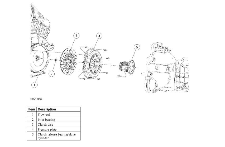

Just bought the car listed above (V6) and a week later it won't move once in gear. Goes into gear smoothly just won't move. Trying buy parts but not sure what to buy. Any input would be appreciated.

JOHN CHRISTOPHER DELGADO
What would be your opinion about the flywheel or pressure plate being the cause?
May 6, 2019 at 11:30 PM
Sorry, did not know t was a stick shift.
Yes, the clutch sounds like the issue.
