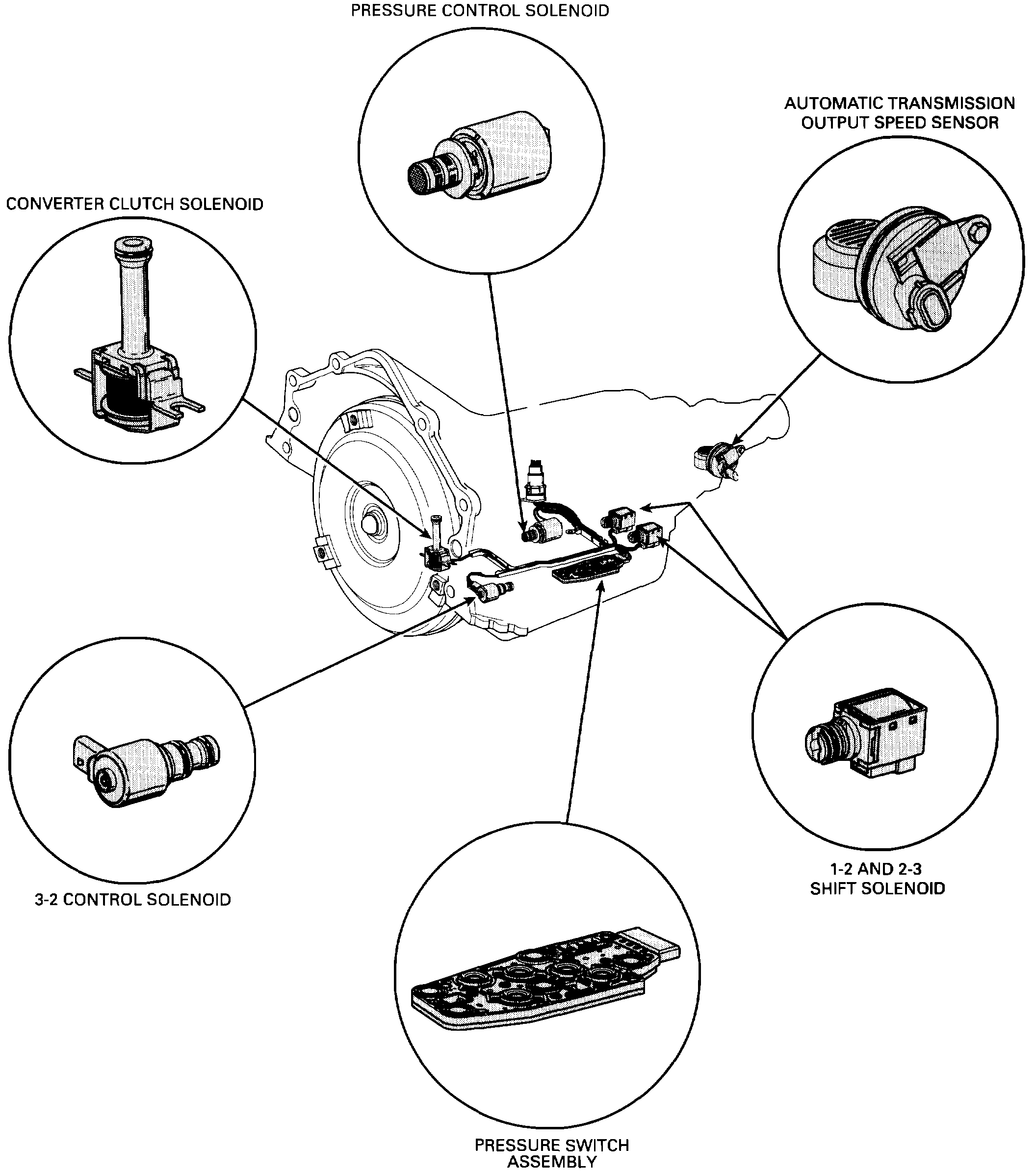

Since it is working (cold) the first suspect I have is line pressure. There is a pressure control/regulator solenoid that may be failing. The pressure regulator solenoid is attached to the control valve body within the transmission. I attached a picture for you to see where (approximately) it is located.

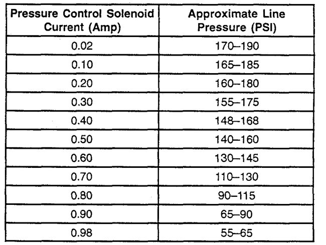

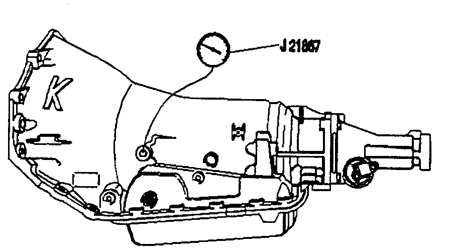

Here are the directions for testing line pressure. Picture 2 shows where the line pressure tap is for the transmission and picture 3 shows what pressures should be based on gear selection and a specific temperature.

- Install or connect the oil pressure gage at the line pressure tap.

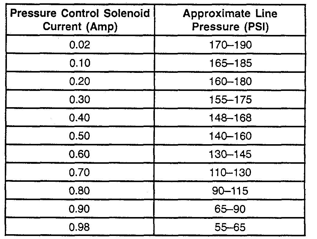

7. Access the PCS Control test on the TECH 1 scan tool.
8. Increase DESIRED PCS in 0.1-amp increments. Read the corresponding line pressure on the pressure gage. Allow the pressure to stabilize for five seconds after each current charge.
9. Compare your data to the Drive-Park-Neutral line pressure chart below.
If your pressure readings differ greatly from the line pressure chart, refer to the DIAGNOSIS CHARTS.
The TECH 1 scan tool is only able to control the pressure control solenoid in Park and Neutral with the vehicle stopped. This protects the clutches from extremely high or low pressures in Drive or Reverse ranges. (pic3)
The pressures in the table assume an engine speed of 1500 RPM and a temperature of 66° C (150° F). The pressure will vary with a change in temperature.
