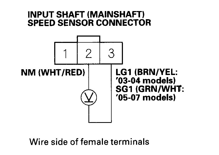

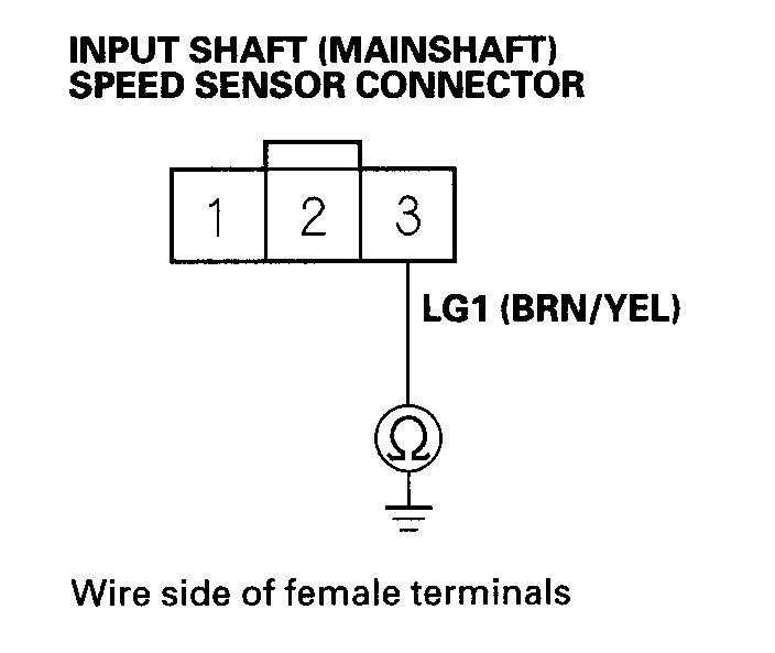

Installed a new engine into the car listed above. New engine under 50,000 up to old transmission with 189,000. No leaks or bad wires. All gears work except reverse. Put it into reverse and it acts like it's in neutral. Drove it in drive and now the d is flashing and engine is on. Checked the code with obd reader and it's throwing po716 code. So if I change the transmission input/turbine speed sensor should the reverse start working?

This specific code is caused by an electrical issue and not a mechanical one. I suspect if you replace the input speed sensor, it will do the same thing. I have a feeling something isn't fully connected or a wire was damaged during the engine install. It could be related to a ground issue with the PCM.
What I suggest is to follow the directions which are specific diagnostics for this code. The pictures below correlate with the directions.
_____________________________________
2007 Honda Accord L4-2.4L
DTC Troubleshooting
Vehicle ALL Diagnostic Trouble Codes ( DTC ) Testing and Inspection P Code Charts P0716 DTC Troubleshooting
DTC TROUBLESHOOTING
DTC P0716: Problem in Input Shaft (Mainshaft) Speed Sensor Circuit
NOTE:
- Before you troubleshoot, record all freeze data and any on-board snapshot, and review General Troubleshooting Information.
- This code is caused by an electrical circuit problem and cannot be caused by a mechanical problem in the transmission.

7. Turn the ignition switch OFF.
8. Jump the SCS line with the HDS.
9. Disconnect PCM connector A (31P) and the input shaft (mainshaft) speed sensor connector.
10. Check for continuity between PCM connector terminal A8 and body ground, and between PCM connector terminal A9 and body ground.
pic 1
Is there continuity?
YES - Go to step 11.
NO - Repair open in the wires between PCM connector terminals A8, A9, and ground (G101), or repair poor ground (G101), then go to step 31.

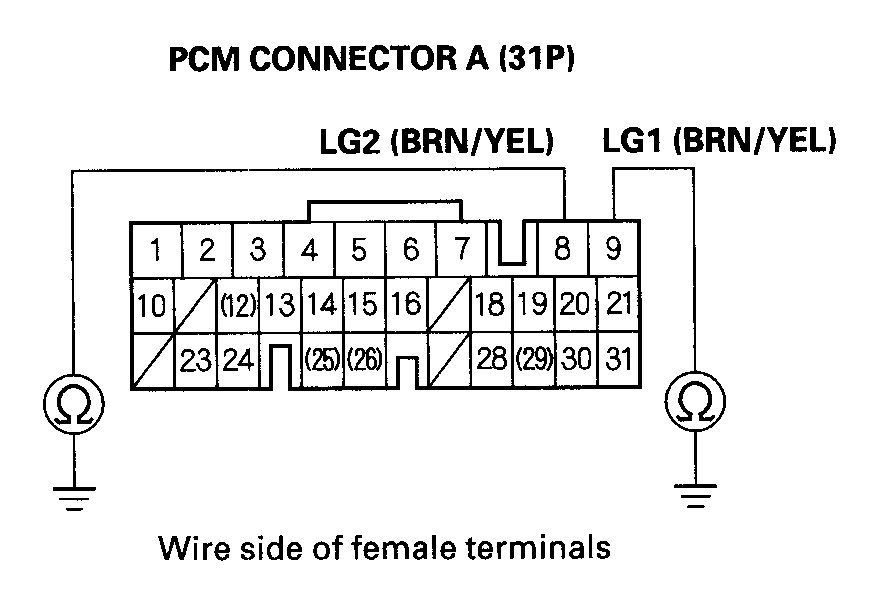

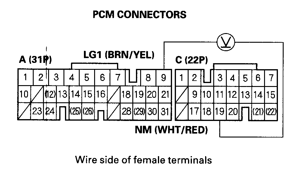

11. Connect PCM connector A (31P).
12. Turn the ignition switch ON (II).
13. Measure voltage between input shaft (mainshaft) speed sensor connector terminal No. 1 and body ground.
pic 2
Is there about 5 V?
YES - Go to step 14.
NO - Go to step 26.

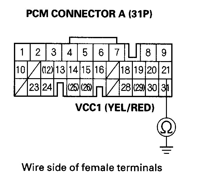

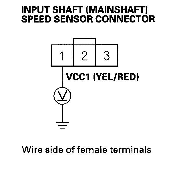

14. Turn the ignition switch OFF.
15. Disconnect PCM connector C (22P).
16. Check for continuity between input shaft (mainshaft) speed sensor connector terminal No. 2 and body ground.
pic 3
YES - Repair short to body ground in the wire between PCM connector terminal C19 and the input shaft (mainshaft) speed sensor, then go to step 31.
NO -
- Go to step 18.

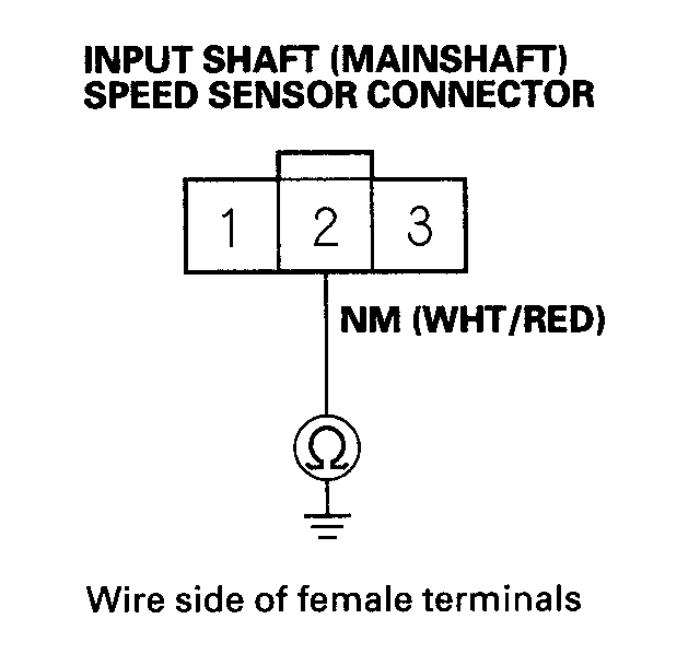

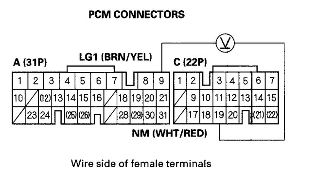

17. Check for continuity between input shaft (mainshaft) speed sensor connector terminal No. 3 and body ground.
pic 4
YES - Connect PCM connector C (22P), and go to step 20.
NO - Repair open in the wire between the input shaft (mainshaft) speed sensor and ground (G101), then go to step 31.

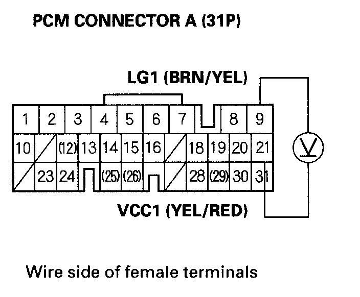

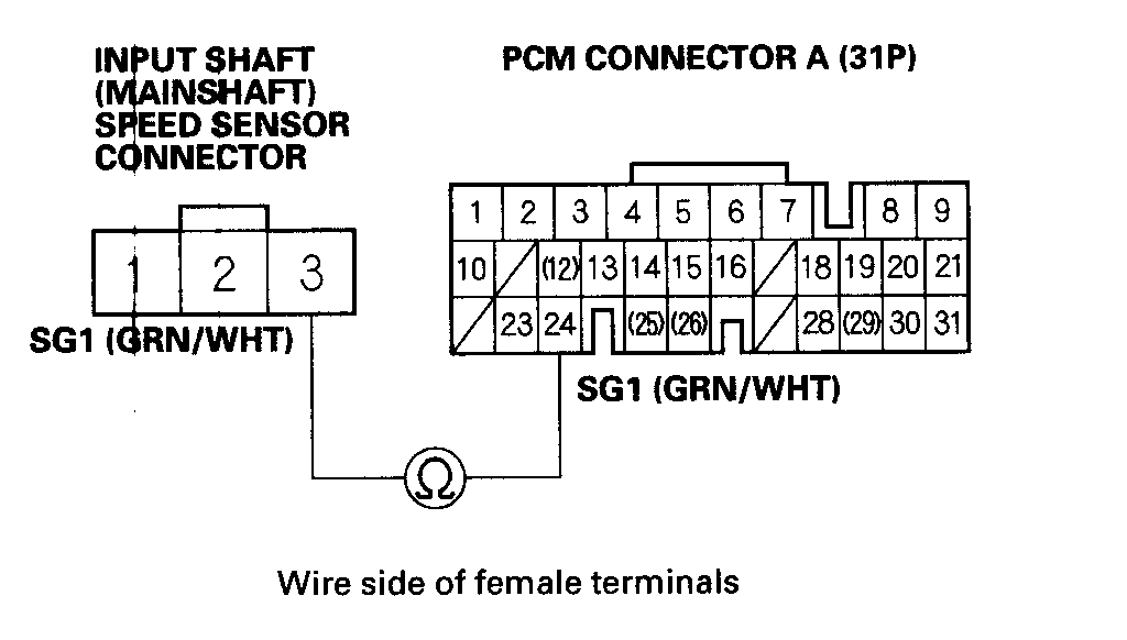

18. Disconnect PCM connector A (31P).
19. Check for continuity between input shaft (mainshaft) speed sensor connector terminal No. 3 and PCM connector terminal A24.
pic 5
YES - Connect PCM connectors A (31P) and C (22P), and go to step 20.
NO - Repair open in the wire between the input shaft (mainshaft) speed sensor and PCM connector terminal A24, then go to step 31.

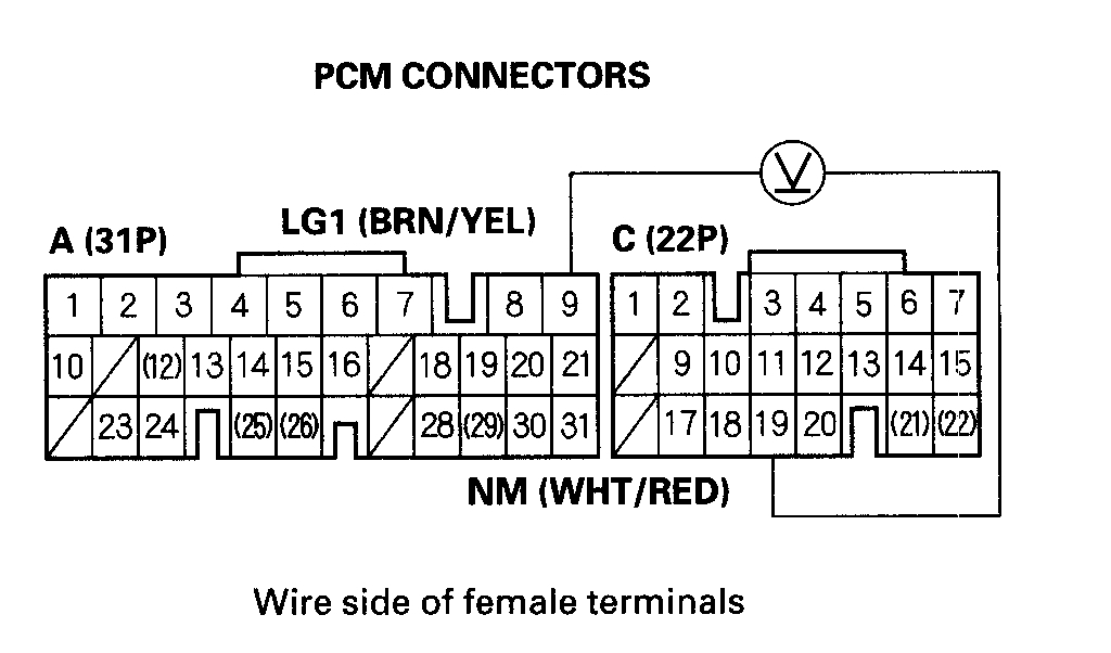

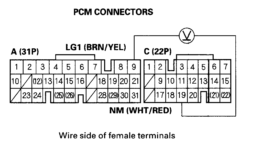

20. Turn the ignition switch ON (II).
21. Measure voltage between input shaft (mainshaft) speed sensor connector terminals No. 2 and No. 3.
pic 6
Is there about 5 V?
YES - Go to step 22.
NO - Go to step 30.
