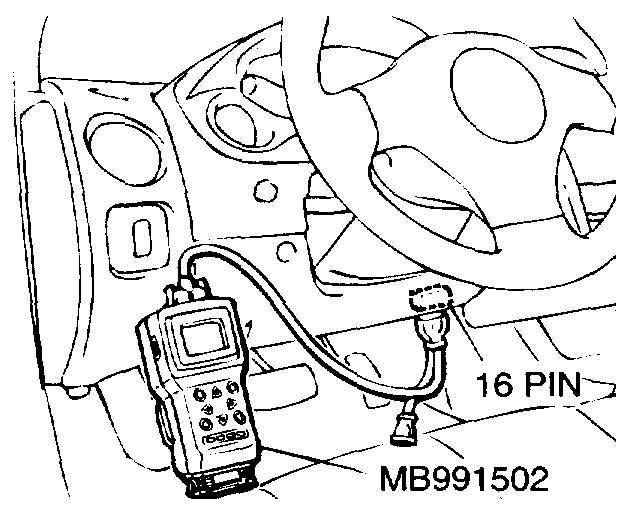

my transmission revs from 2,000 to 3,000 rpm's before shifting to 3rd gear. sometimes it hard shifts. now its starting to go into limp mode and staying in 3rd gear with the neutral light flashing. the code reads gear 4 ratio incorrect (p0734). the shift solenoids were changed and the input and output sensors were also changed.

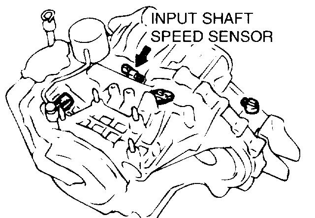

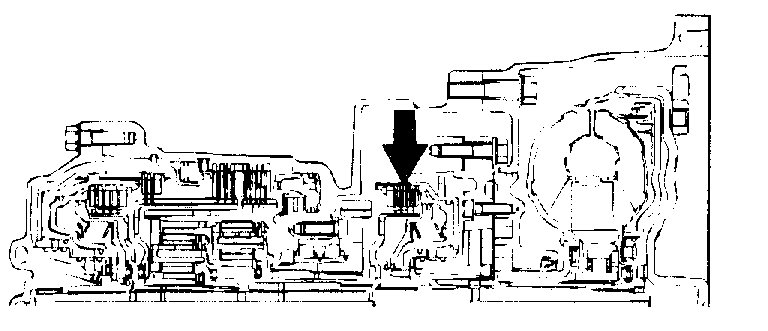

This has nothing to do with the shift solenoids. There is a variation in speed between the input and output speed sensors. Here is how it works:
If the output from the output shaft speed sensor multiplied by the 1st gear ratio is not the same as the output from the input shaft speed sensor after shifting to 1st gear has been completed, diagnostic trouble code number "41" is output. If diagnostic trouble code number "41" is output four times, the transmission is locked into 3rd gear as a fail-safe measure, and the "N" range light flashes once per second.
There are several things that can cause it to set. See below.

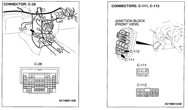

Here are the diagnostics related to a code 44 (po734) They are extensive. The attached pics correlate with the directions.
______________________________
2003 Mitsubishi Eclipse L4-2.4L SOHC
DTC 44
Vehicle ALL Diagnostic Trouble Codes ( DTC ) Testing and Inspection Manufacturer Code Charts Transmission Control System DTC 44
DTC 44
pic 1
pic 2
DTC 44: 4th Gear Incorrect Ratio

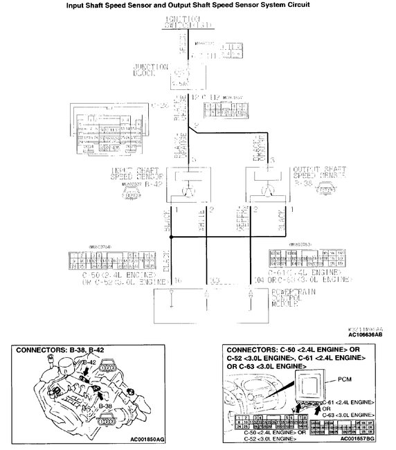

CIRCUIT OPERATION
- A coil built into the input shaft speed sensor generates pulse signal of 0 (-> 5 volts at both ends of this coil when the input shaft rotates. The pulse signal frequency increases with the rise in input shaft speed.
- Both ends of the coil are connected to the PCM (terminals 16 and 103) via the input shaft speed sensor connector (terminals 1 and 2).
- The PCM detects the input shaft speed with the signal input to terminal (terminal 103).
- A coil built into the output shaft speed sensor generates pulse signal of 0 (-> 5 volts at both ends of this coil when the output shaft rotates. The pulse signal frequency increases with the rise in output shaft speed.
- Both ends of the coil are connected to the PCM (terminals 16 and 104) via the output shaft speed sensor connector (terminals 1 and 2).
- The PCM detects the output shaft speed with the signal input to terminal (terminal 104).
TROUBLESHOOTING HINTS (The most likely causes for this code to be set:)
- Malfunction of the input shaft speed sensor
- Malfunction of the output shaft speed sensor
- Malfunction of the PCM
- Malfunction of the underdrive clutch retainer
- Malfunction of the transfer drive gear or driven gear
- Malfunction of the low-reverse brake system (for code number"41," "46")
- Malfunction of the underdrive clutch system (for code number"41," "42,""43")
- Malfunction of the second brake system (for code number "42," "44")
- Malfunction of the overdrive clutch system (for code number"43," "44")
- Malfunction of the reverse clutch system (for code number"46")
- Noise generated

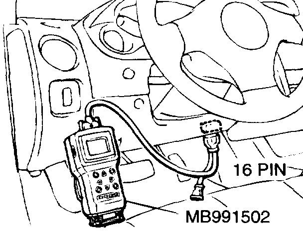

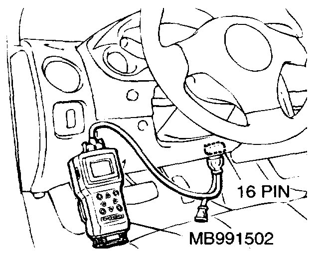

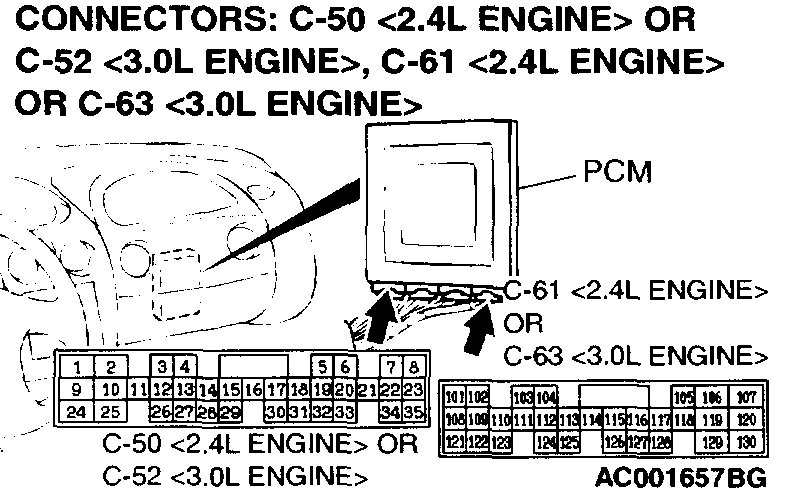

STEP 1. Using scan tool MB991502, check the A/T diagnostic trouble code.
CAUTION: To prevent damage to scan tool MB991502, always turn the ignition switch to the "LOCK" (OFF) position before connecting or disconnecting scan tool MB991502.
pic 3
1) Connect scan tool MB991502 to the data link connector.
2) Turn the ignition switch to the "ON" position.
3) Read the A/T diagnostic trouble code.
4) Turn the ignition switch to the "LOCK" (OFF) position.
Q: Is A/T diagnostic trouble code numbers "22" or "23" output?
YES: Refer to code number 22: Input Shaft Speed Sensor System, or refer to code number 23: Output Shaft Speed Sensor System.
NO: Go to Step 2.

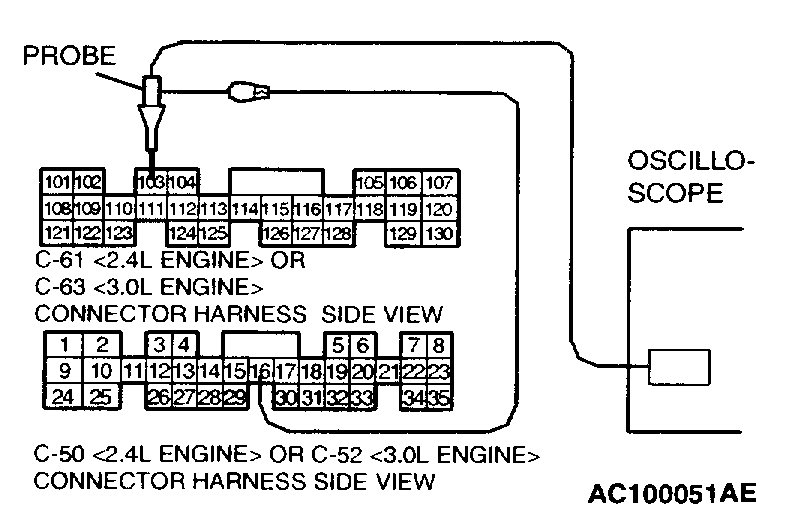

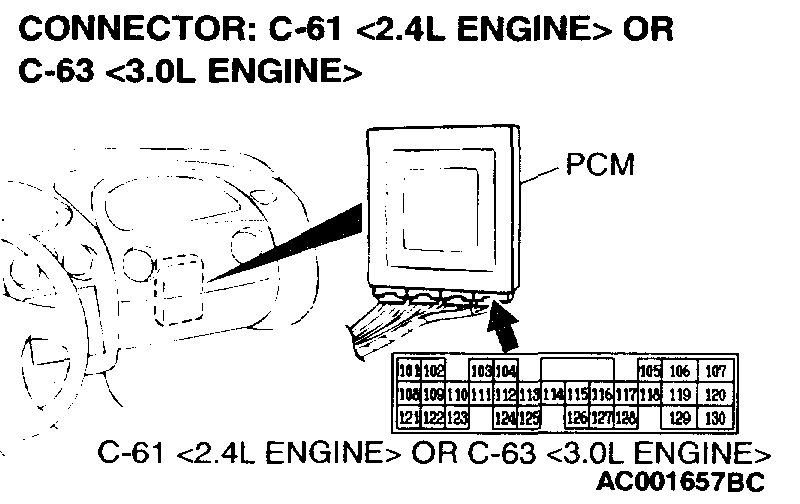

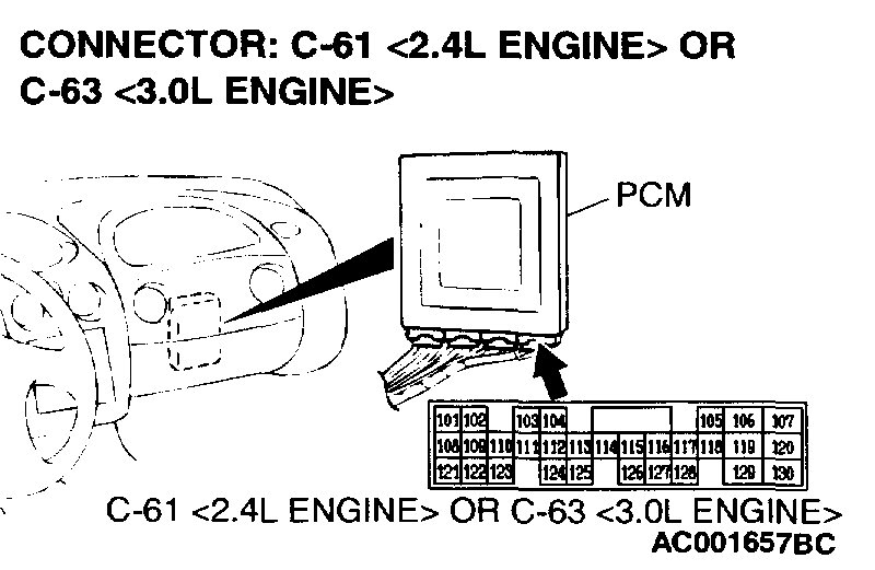

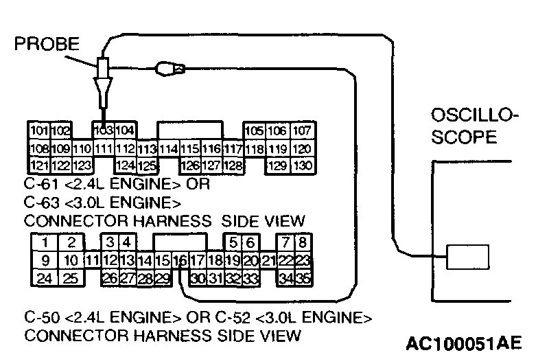

STEP 3. Using the oscilloscope, check the waveform at PCM connectors C-50 (2.4L Engine> or C-52 (3.0L Engine> and C-61 (2.4L Engine> or C-63 (3.0L Engine> by backprobing.
pic 5

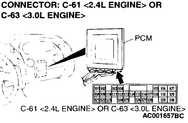

1) Do not disconnect connectors C-50 (2.4L Engine> or C-52 (3.0L Engine> and C-61 (2.4L engine> or C-63 (3.0L Engine>.
pic 6

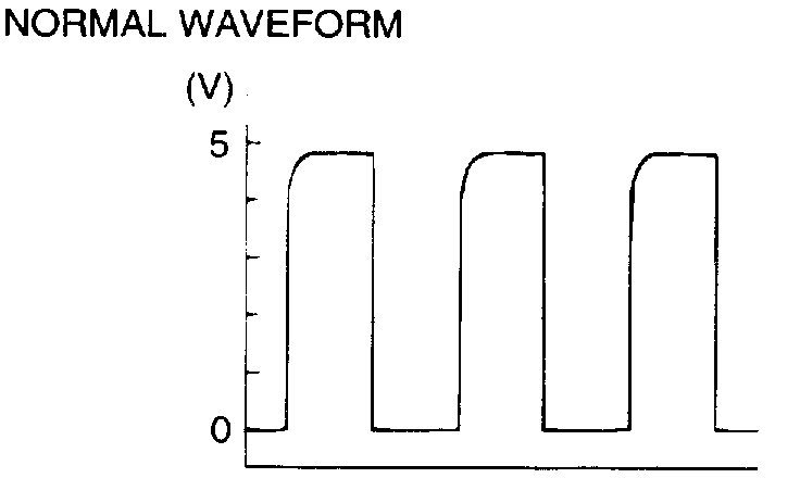

2) Connect an oscilloscope probe to PCM connector C-50 (2.4L Engine> or C-52 (3.0L Engine> terminal 16 and to PCM connector C-61 (2.4L engine> or C-63 (3.0L Engine> terminal 103 by backprobing.
3) Start the engine and run at constant speed of 50km/h (31 mph). (Gear range: 3rd gear)
pic 7

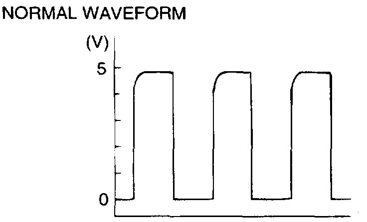

4) Check the waveform.
- The waveform should show a pattern similar to the illustration. The maximum value should be 4.8 volts and more and the minimum value 0.8 volts and less. The output waveform should not contain electrical noise.
5) Turn the ignition switch to the "LOCK" (OFF) position.
Q: Is the waveform normal?
YES: Go to Step 8.
NO: Go to Step 4.

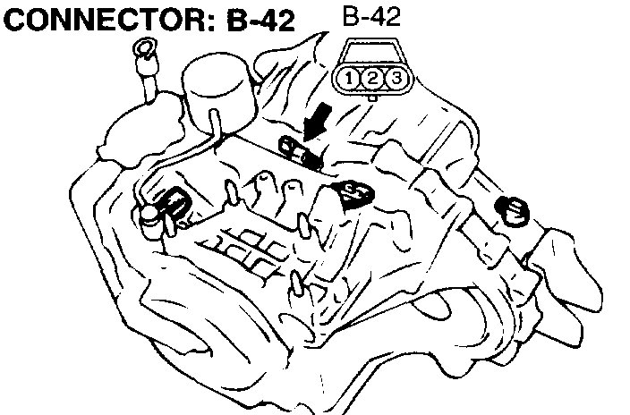

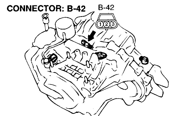

STEP 4. Check connectors B-42 at input shaft speed sensor and C-61 (2.4L Engine> or C-63 (3.0L Engine> at PCM for damage.
pic 8
pic 9
Q: Are the connectors in good condition?
YES: Go to Step5.
NO: Repair or replace the defective connector(s).
STEP 5. Check harness for damage between input shaft speed sensor connector B-42 terminal 2 and PCM connector C-61 (2.4L Engine> or C-63 (3.0L Engine> terminal 103.
pic 10
pic 11
Q: Is the harness wire in good condition?
YES: Go to Step 6.
NO: Repair it.

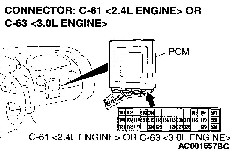

STEP 8. Using the oscilloscope, check the waveform at PCM connectors C-50 (2.4L Engine> or C-52 (3.0L Engine> and C-61 (2.4L Engine> or C-63 (3.0L Engine> by backprobing.
pic 14
pic 15
2) Connect an oscilloscope probe to PCM connector C-50 (2.4L Engine> or C-52 (3.0L Engine> terminal 16 and to PCM connector C-61 (2.4L engine> or C-63 (3.0L Engine> terminal 104 by backprobing.
3) Start the engine and run at constant speed of 50 km/h (31 mph). (Gear range: 3rd gear)
pic 16
YES: Go to Step 13.
NO: Go to Step 9.

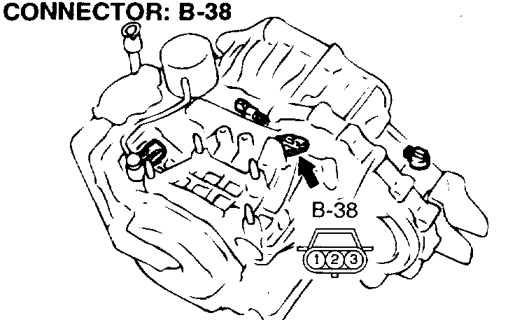

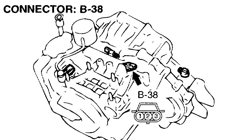

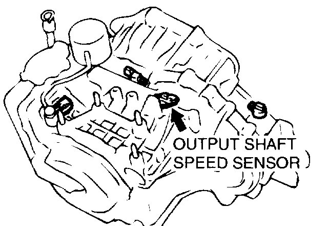

STEP 9. Check connectors B-38 at output shaft speed sensor and C-61 (2.4L Engine> or C-63 (3.0L Engine> at PCM for damage.
pic 17
pic 18
YES: Go to Step 10.
STEP 10. Check harness for damage between output shaft speed sensor connector B-38 terminal 2 and PCM connector C-61 (2.4L Engines or C-63 (3.0L Engines terminal 104.

STEP 11. Replace the output shaft speed sensor.
pic 21
1) Replace the output shaft speed sensor.

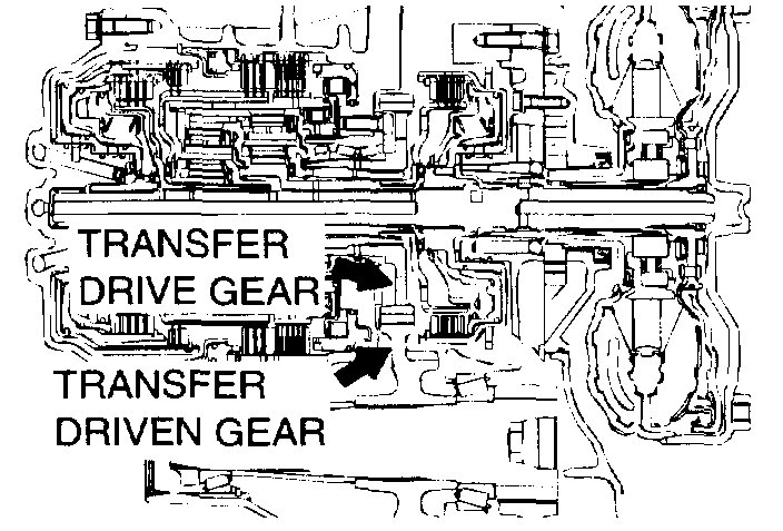

STEP 12. Replace the transfer drive gear or driven gear.
pic 22
1) Replace the transfer drive gear or driven gear.
2) Test drive the vehicle.
3) Check for A/T diagnostic trouble code.
Q: Is the A/T diagnostic trouble code output?
YES: The A/T diagnostic trouble code may have set due to external Radio Frequency (RFI), possibly caused by cellular phone activity, after market components installed on the vehicle, etc.
NO: The inspection is complete.

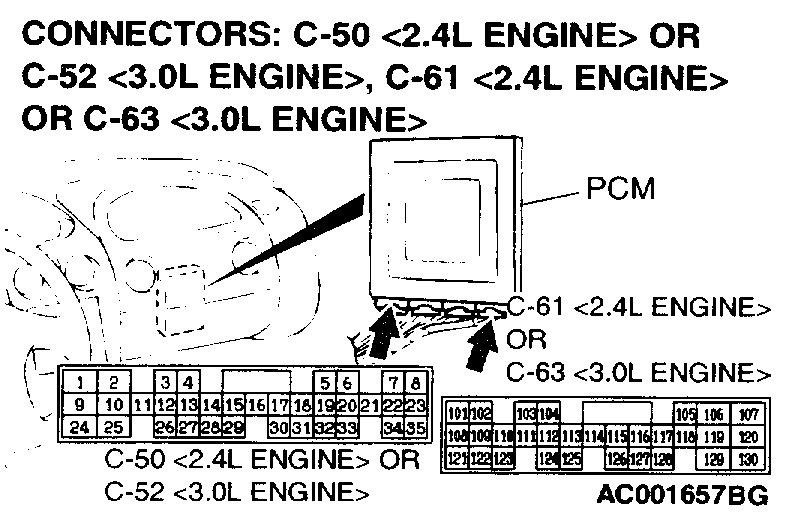

STEP 13. Replace the PCM.
1) Replace the PCM.
YES: Go to Step14.

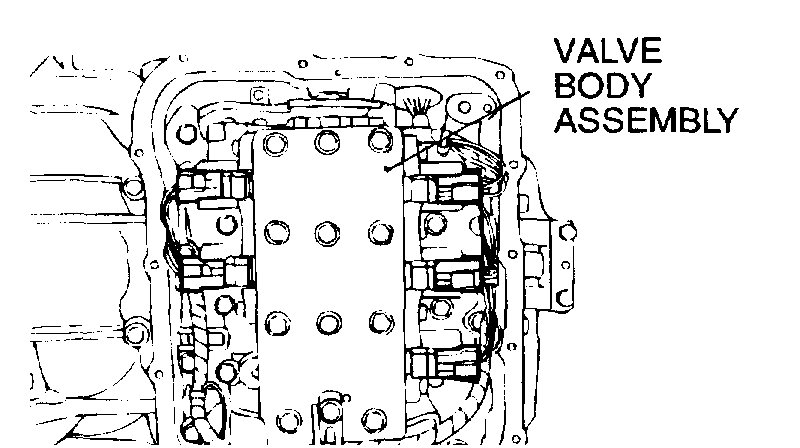

STEP 14. Replace the valve body.
pic 24
1) Replace the valve body.

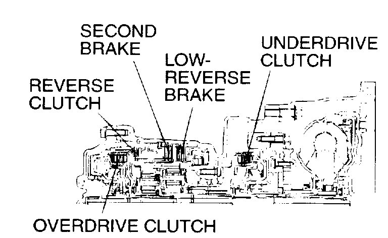

STEP 15. Overhaul the A/T.
pic 25
1) Replace the following parts.
- If DTC No.41, No.42, No.43 are output individually or in a group, replace the underdrive clutch.
- If DTC No.43, No.44 are output individually or in a group, replace the overdrive clutch.
- If DTC No.46 is output, replace the reverse clutch.
- If DTC No.41, No.46 are output individually or in a group, replace the low-reverse brake.
- If DTC No.42, No.44 are output individually or in a group, replace the second brake.
- If DTC No.41 is output, replace the One-Way Clutch (OWCL).
Q: Is the A/T diagnostic trouble code output again?
