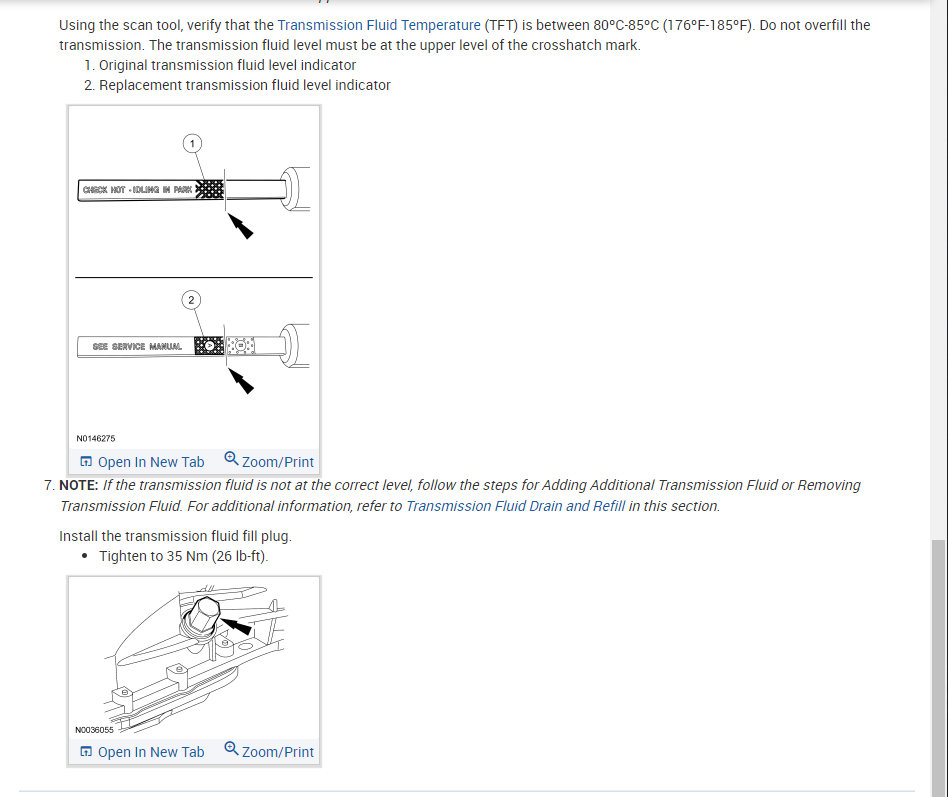

This sounds like a fluid issue so the fact that you just changed it, I am thinking that the fluid is low. Does this issue seem to happen more when taking curves, sitting on a hill, or accelerating?
If so the fluid is what would know you are not flat on the ground so it is going to go to one side of the pan away from the pickup and so it sucks air.

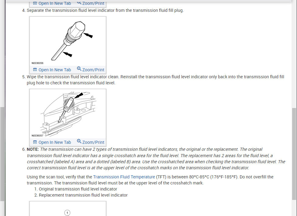

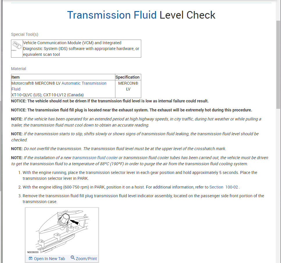

Let's check the fluid level and I would suggest trying to just put another quart in the unit just to make sure. Below is the process to check the fluid on the USA version of your vehicle.
Please let us know what you find with this. Thanks
