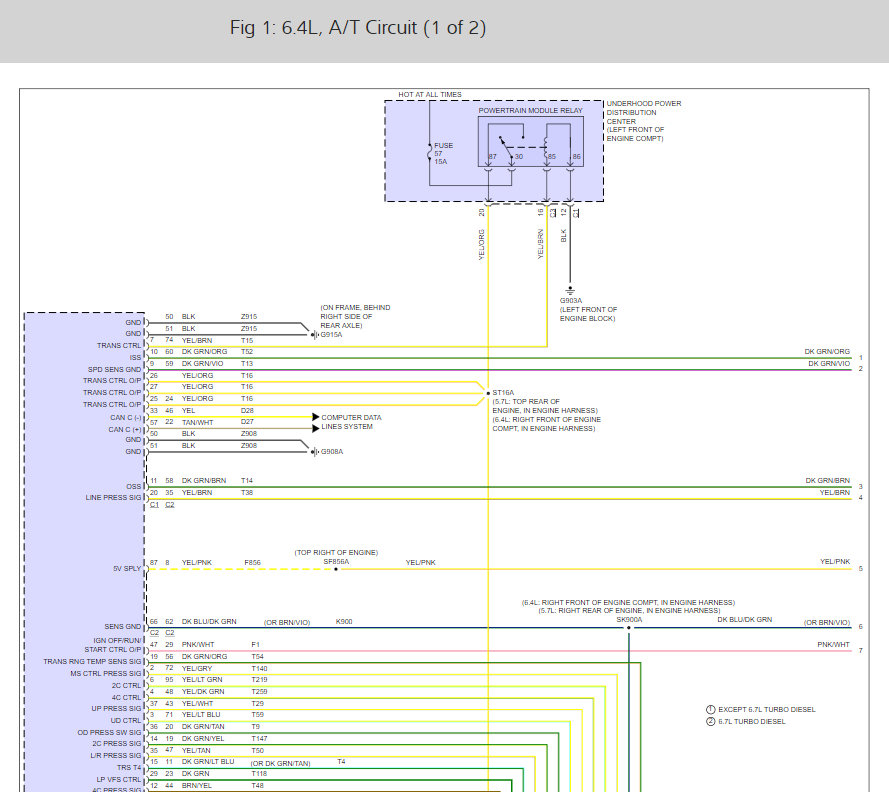

Only way transmission would work right would be to put into fourth gear manually. It would shift 1 through 6 like it is supposed to but overdrive did not work. Now must put into third gear manually and if it tried to shift into fourth it would act like it was in neutral and the only way to get it to work would be to stop and shut off the truck and restart it and put it into third manually.

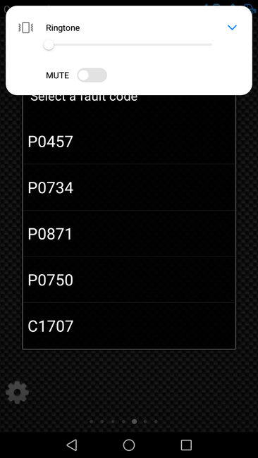

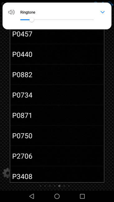

Yes. The two newest codes are gear 4 ratio and low pressure sensor c circuit.
Oct 9, 2018 at 1:30 PM
  • 55,746 POSTS
Can I get the code numbers please? It sounds like the input shaft sensor is not working right or you have a shift solenoid that is shorted out. Please let me know.
Oct 12, 2018 at 4:19 AM

I did that. The 2 codes that popped up after I cleared them and drove was p0871 and either p0882 or p0871. I will do it again.

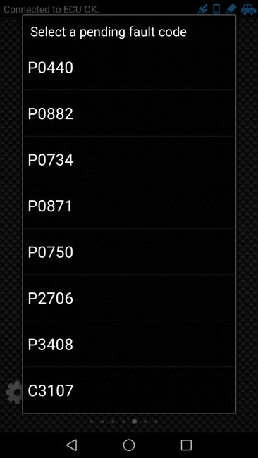

Excellent. Now start the engine and shut it off and run the codes do not drive it.
Oct 26, 2018 at 3:32 AM
ROCKY RATLIFF
  • 17 POSTS
Okay. I did that and still no codes.
Oct 27, 2018 at 5:03 AM
  • 55,746 POSTS

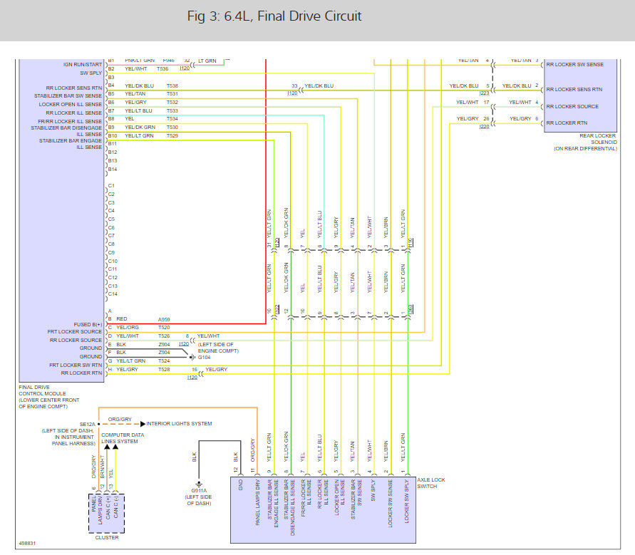

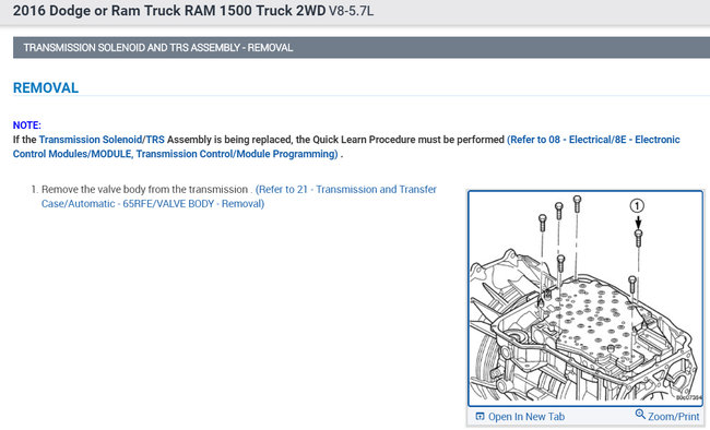

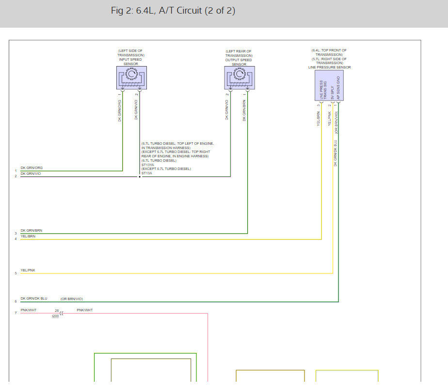

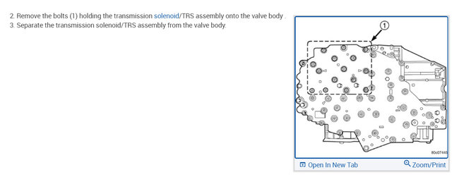

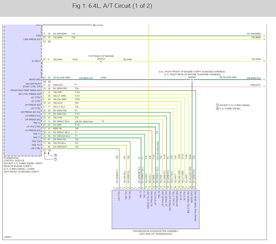

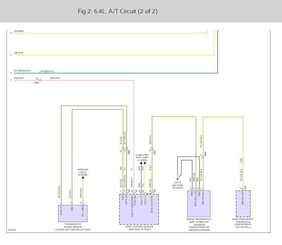

Okay cool, so we got p0882 and p0871 both transmission related codes. I have seen the TRS go bad causing the codes but we should do a pin th pin to make sure the connection are all good. Here is a guide to help us with that and the transmission wiring diagrams so you can see how it works with instructions on how to change out the TRS.

I seen that one of the pictures was for a 1500. I wanted the make sure that it didn't make a difference.
Oct 29, 2018 at 5:28 PM
  • 55,746 POSTS
They should be the same, let me know if the colors do not match up but they should.

Where is the trs located at?
Oct 30, 2018 at 11:08 AM
  • 55,746 POSTS
Check out the diagrams above, it looks like the TRS is located in the valve body.
Oct 31, 2018 at 4:21 AM
ROCKY RATLIFF
  • 17 POSTS
Is everything the same as the 65 rfe as the 66 rfe? The diagram shows it is a 65 rfe. My transmission is a 66 rfe.

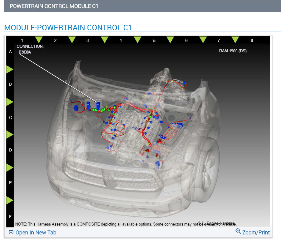

The transmission started acting up shifting into fifth and sixth. It acted like it went into limp mode. So I checked transmission fluid. When I did I noticed that the dip stick tube was broke into where it bolts onto housing. If I put transmission into fourth gear manually it shifted just fine. But overdrive did not work. Then it started acting up when it shifted into fourth. Now it only works if you shift it into third manually. If it shifts into fourth, the RPM's go up like it is slipping and you cannot get it to shift out of fourth. The only way to get it to work again is to stop put truck into park and turn ignition of and restart truck.
Nov 1, 2018 at 8:26 AM
  • 55,746 POSTS

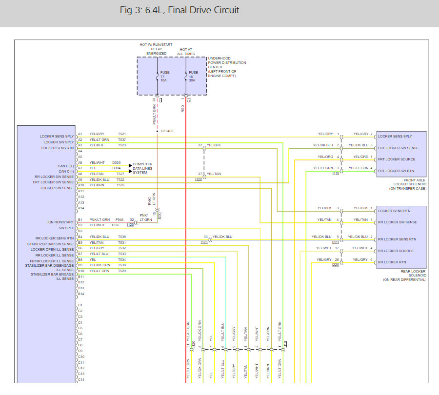

It sounds like the transmission is going out or the PCM, but we should do a pin to pin test using the wiring diagrams from earlier and follow this guide to confirm.
If you want to try the PCM here is the location you can get a programmed unit from eBay.

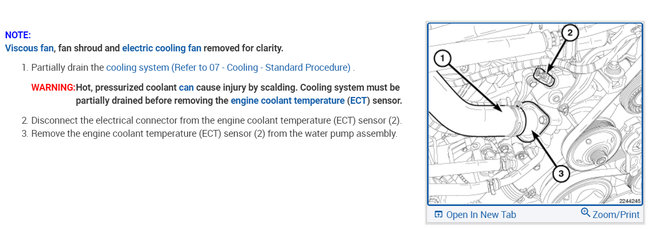

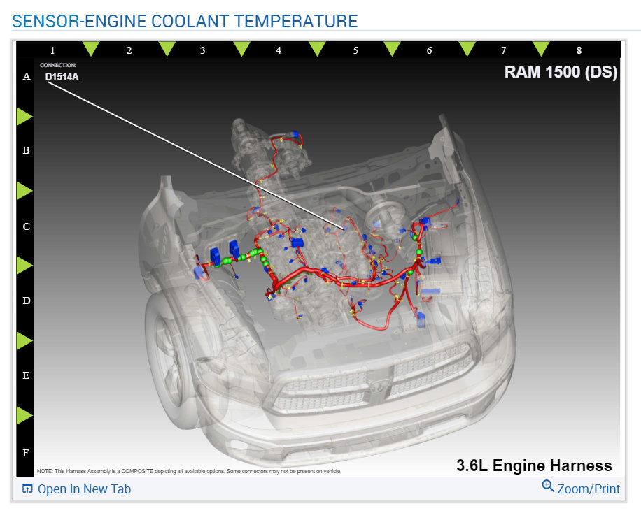

I cleared codes. P0118 pops up when I turn key on and run codes.
Nov 6, 2018 at 3:34 AM
  • 55,746 POSTS
That is for the engine coolant sensor which can cause all kinds of issues. Let's check the connection at the sensor if all looks okay replace the sensor. Here is a guide to walk you through the steps and the location of the sensor for your truck below:
https://www.2carpros.com/articles/coolant-temperature-sensor-cts-replacement
Clear the codes when completed. Check out the diagrams (below). Please let us know what happens.
