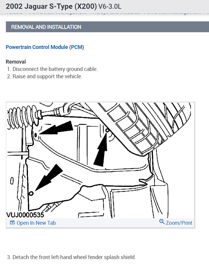

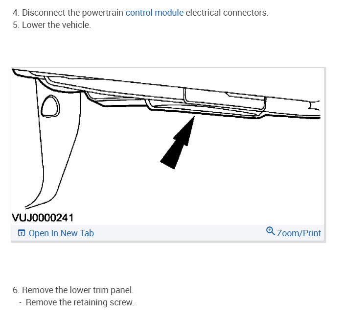

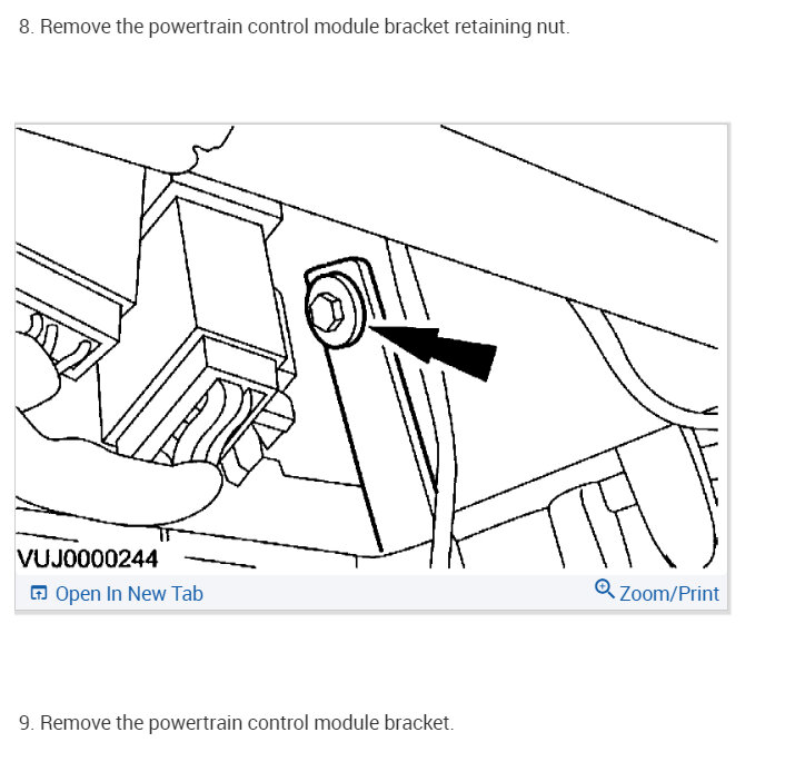

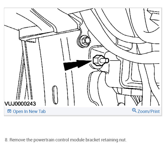

The fact that it fixes itself when you reset the system is telling us the PCM is bad, but we should run the codes to see if any are stored, this guide can help:

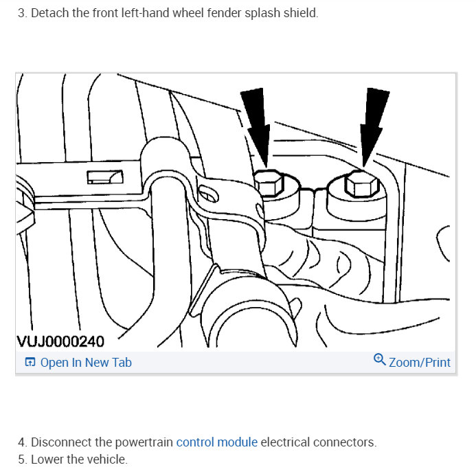

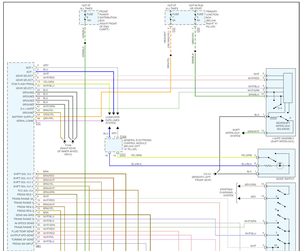

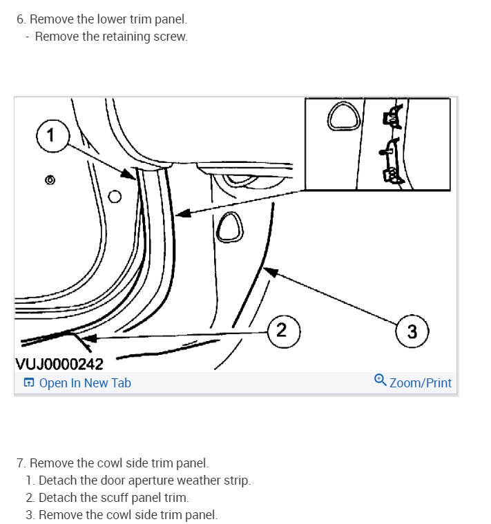

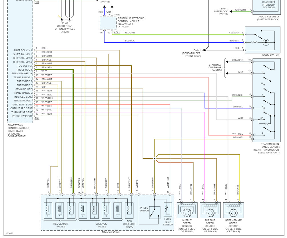

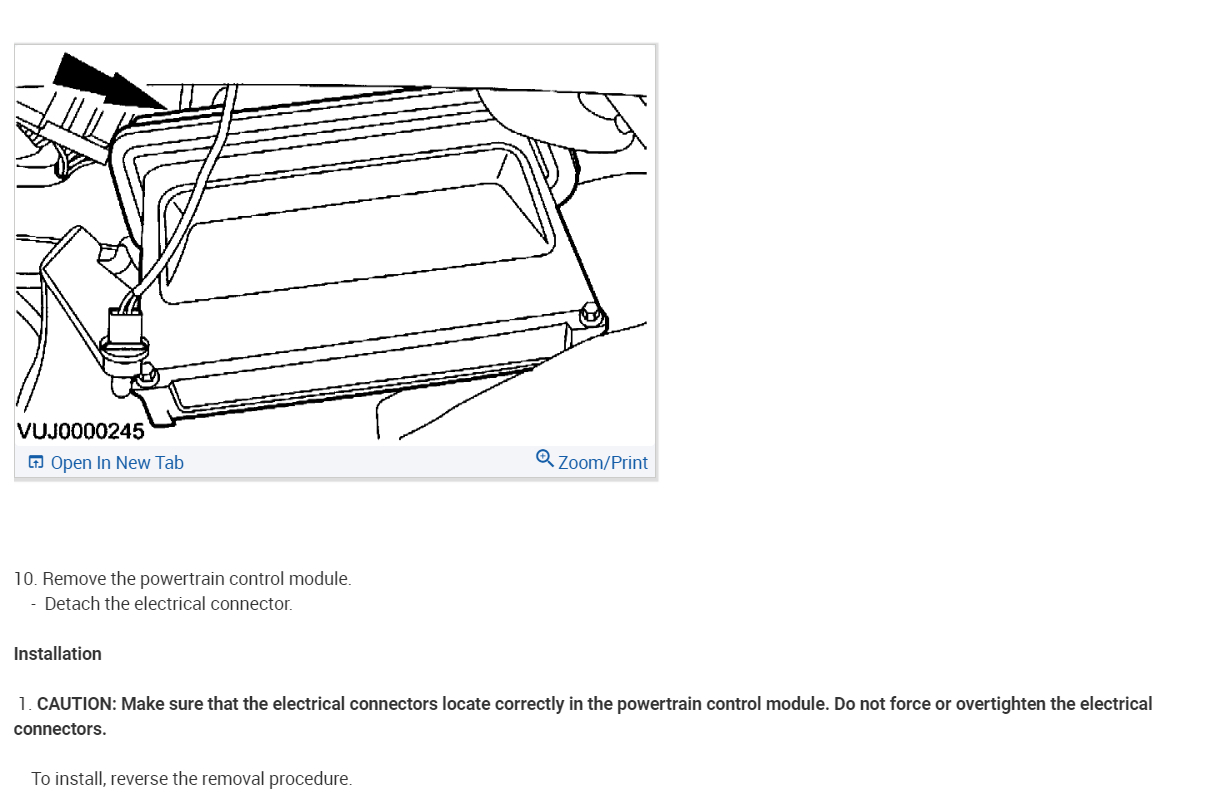

Here is how to change the PCM out, you can get a preprogrammed unit by searching Google or Ebay. Check out the images (below). Please let us know what you find. Here are the transmission wiring diagrams as well.

Thanks for the advice. So much I'm about to take it out now. Can I get this one fixed? Can I get a used one. I have a parts car that has one still in it. Can I use this one? Do I have to get it programed before installing it? Or after? Or at all? Thanks in advance.

You can get a used one, but it will need to be programmed or you can send yours in to be tested or you can get a preprogrammed used unit, so it is your choice.
