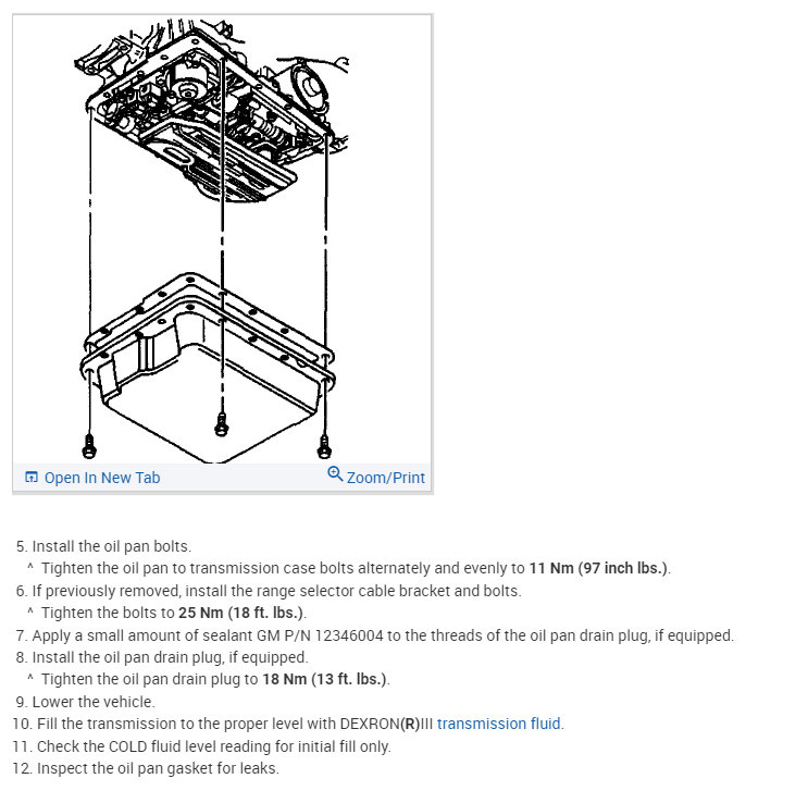

Where is the transmission drain plug located?
2003 GMC ENVOY
250,000 MILES • 4.2L • V6 • 4WD • AUTOMATIC
GIBBONS ALLISON ANGIE
Transmission problems.
Jun 2, 2022 at 10:31 PM
SQM
  • 6,383 POSTS

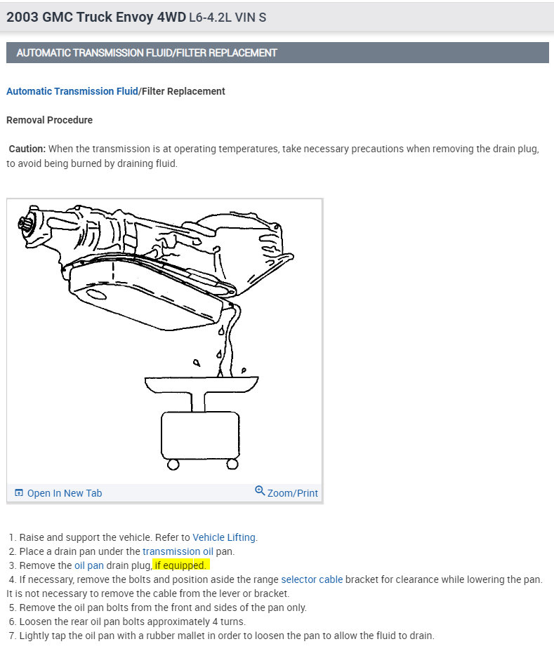

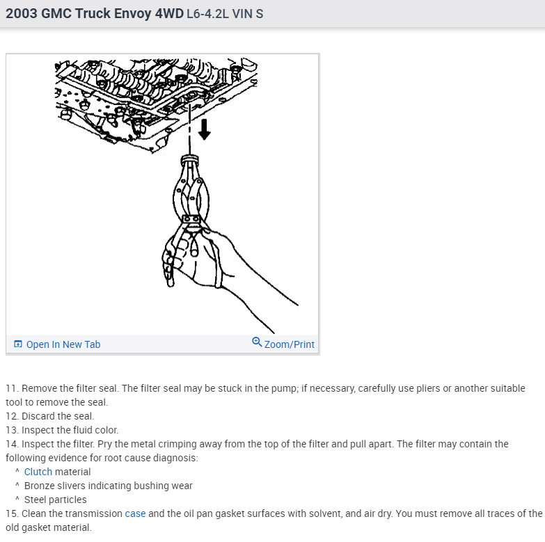

The drain plug is located on the transmission pan.
Keep in mind some of these Envoys did not come equipped with a drain plug for the transmission (depending on the manufacturing plant).

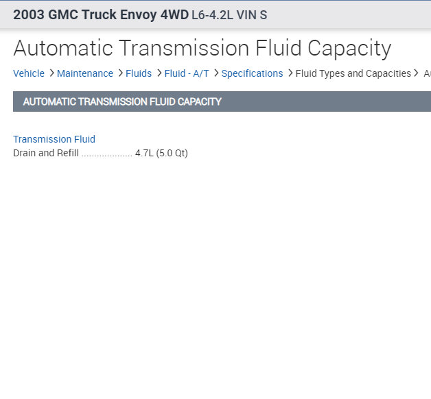

If you are looking to change the fluid, it takes 5 quarts of Dexron III.

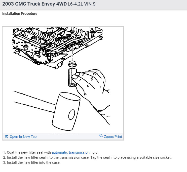

I have attached the transmission fluid change procedure below for your reference.
Let me know of any questions.
