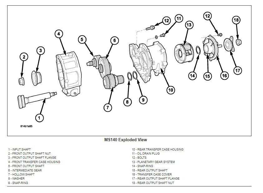

None of the fault codes you provided point towards any possible transmission issues.
They all point towards O2 sensor problems.
I think there might be a possible issue in the transfer case.
A mechanical part like the input shaft could be stripped/broken.
See exploded view of transfer case below.
Cheers, Boris

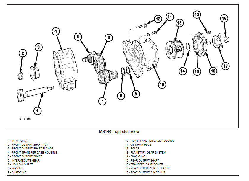

How will I know if my transfer case is messed up? so, say I have it out on the bench what kind of tests can I run?
Jan 21, 2023 at 3:07 PM
BORIS K
  • 836 POSTS
I would suggest checking if you rotate the input shaft on the transfer case that the output shafts also rotate, items 3 and 17
See image below, input shaft is item 1
If no rotation can be seen next, I would strip the transfer case and inspect the input shat spline into the hollow shaft, item 7, and that the intermediate gear, item 6, is not damaged.
Cheers, Boris
