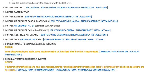

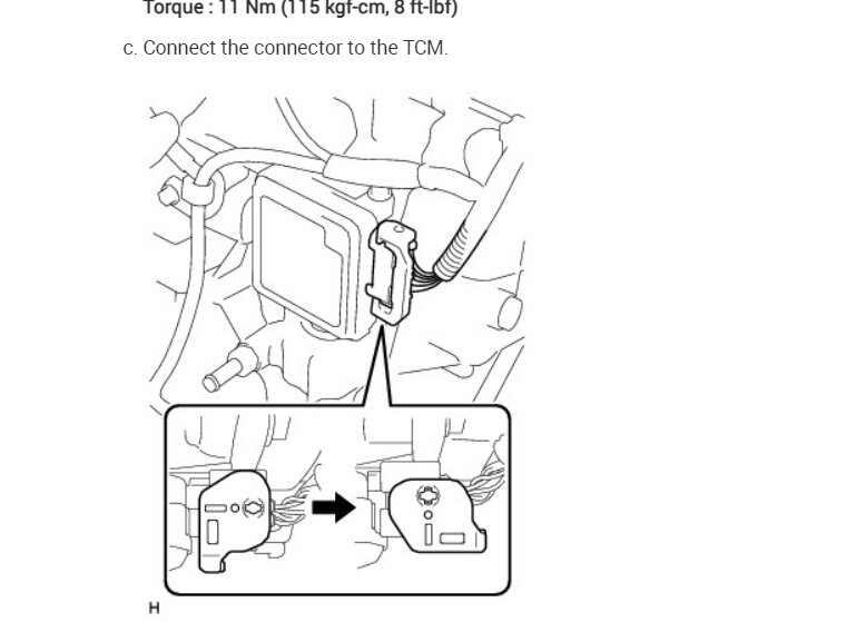

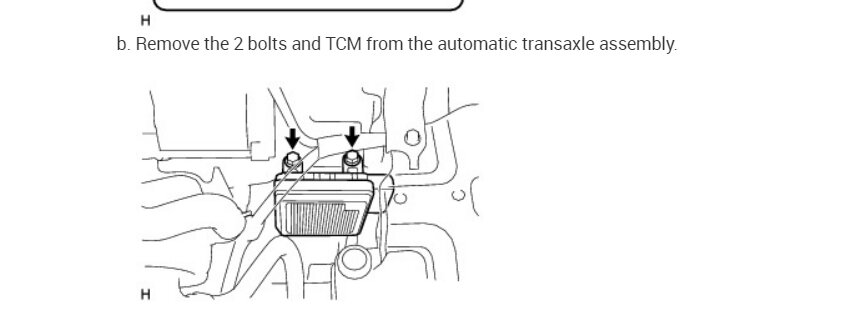

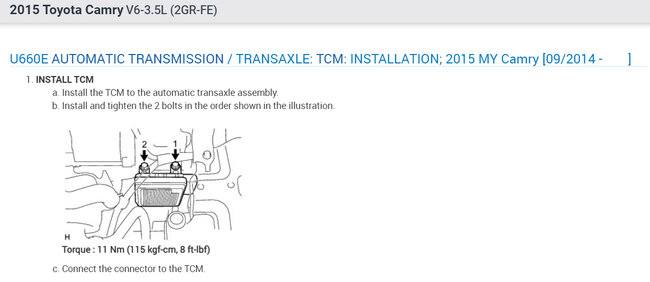

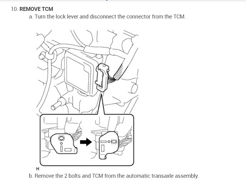

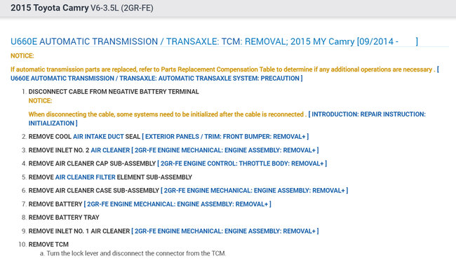

Here is how to change out the TCM in case you need it in the images below.
