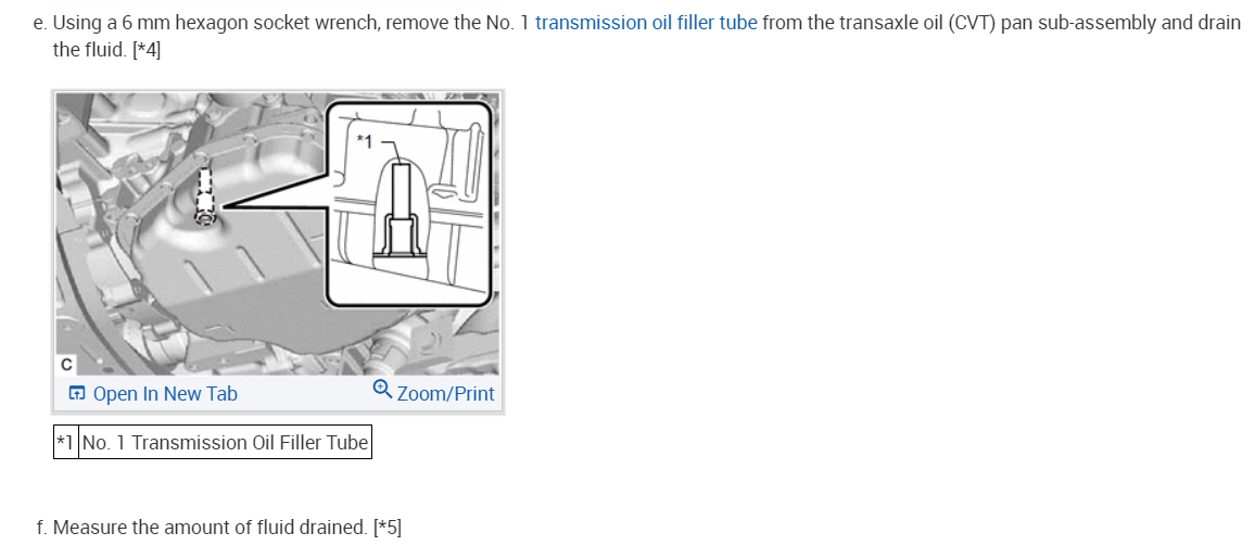

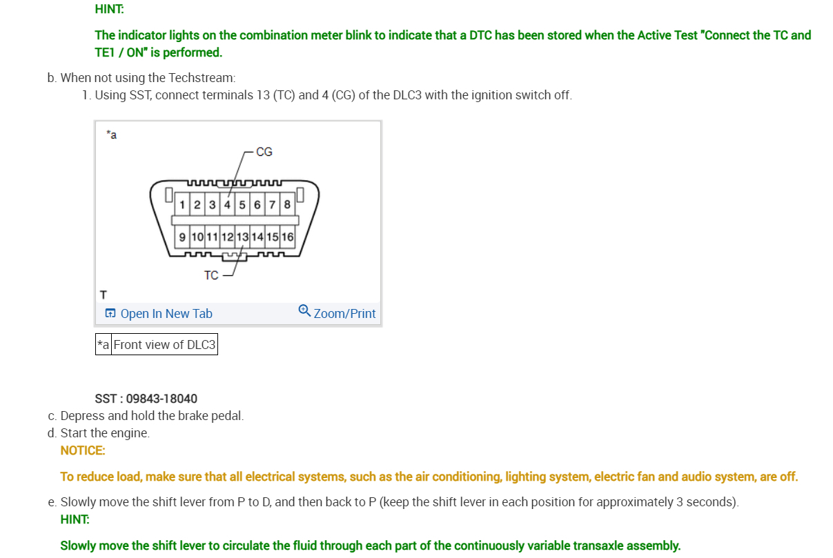

On drive the car switches into a kind of over drive thereby revving the car hardly and then driving becomes nearly impossible. The problem is becoming persistent.
Jul 12, 2023 at 8:37 PM
  • 55,381 POSTS

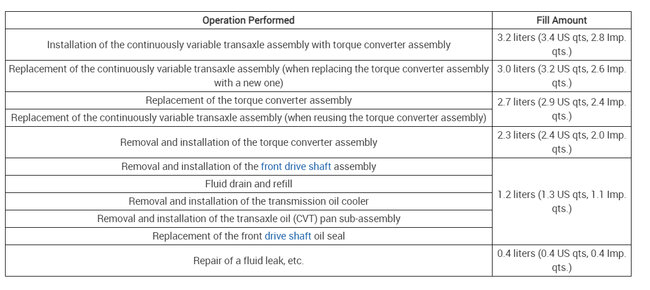

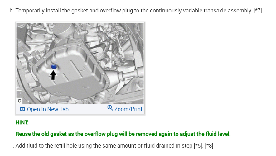

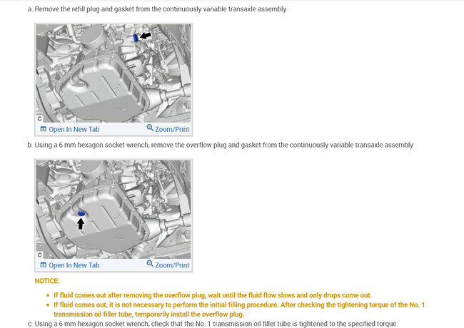

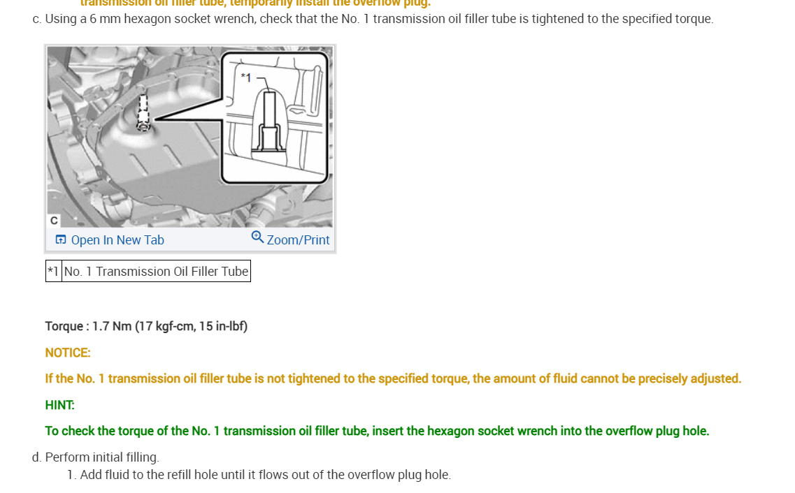

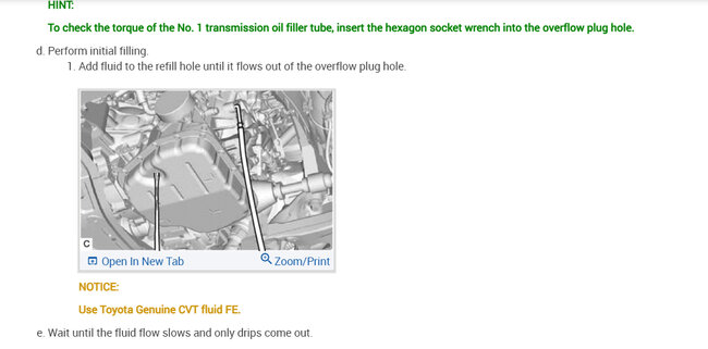

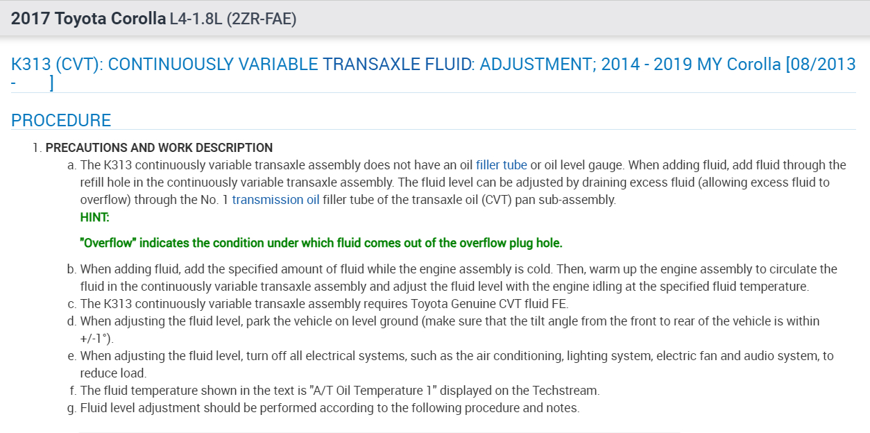

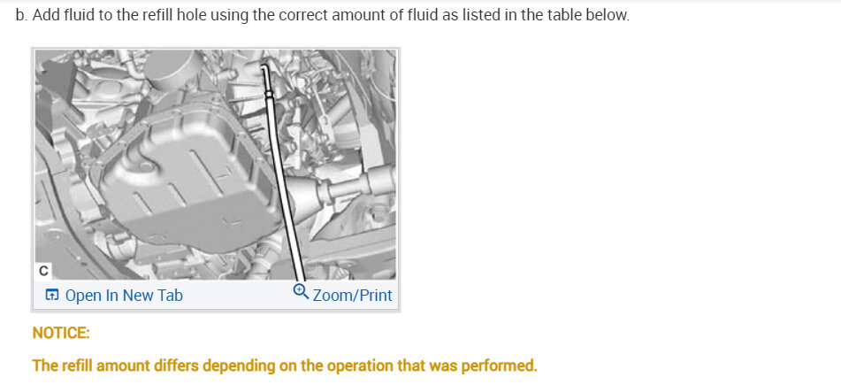

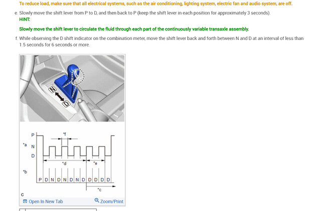

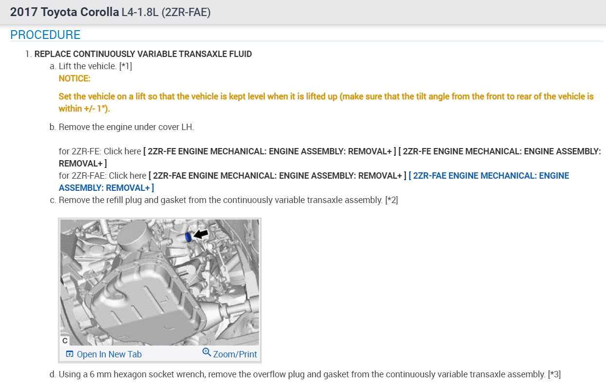

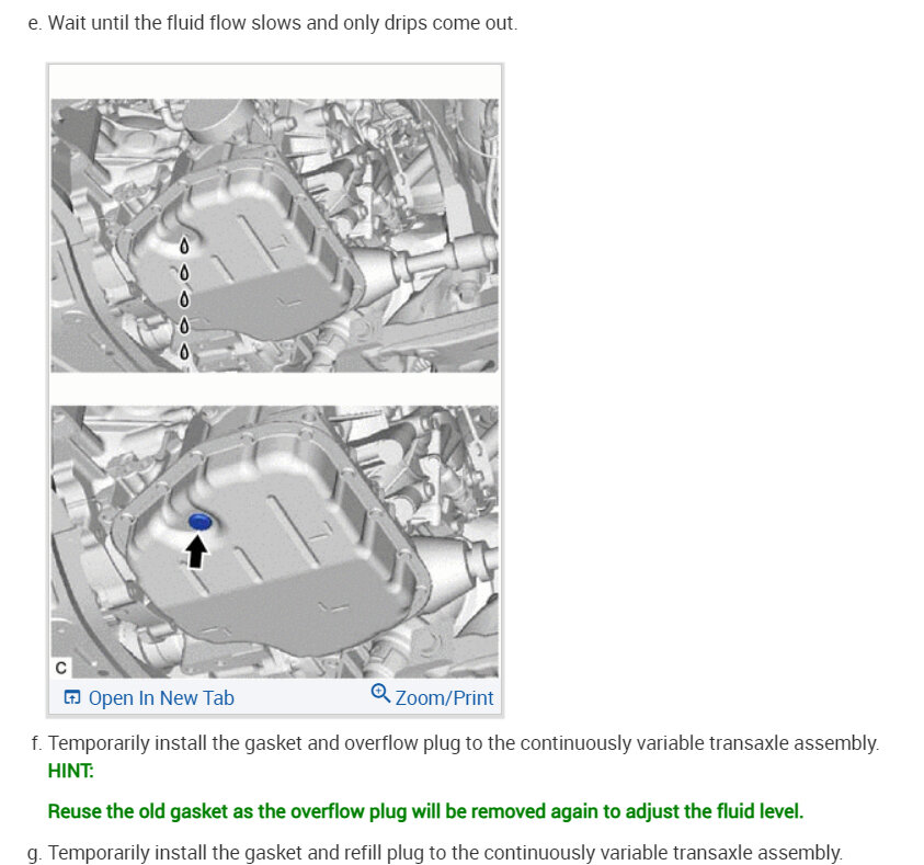

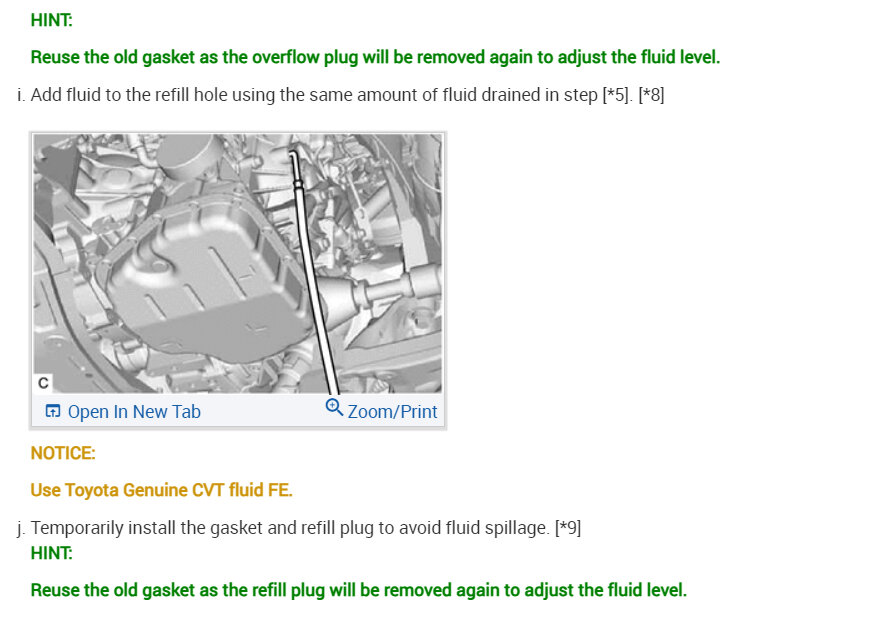

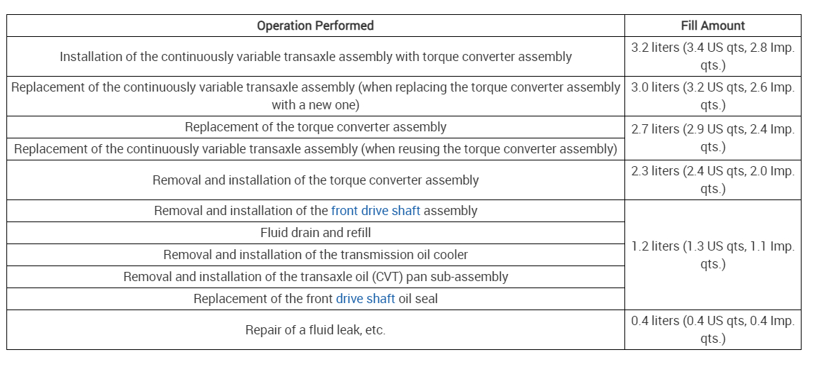

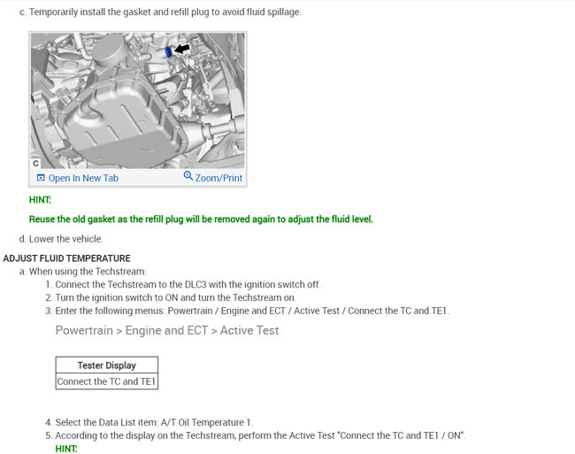

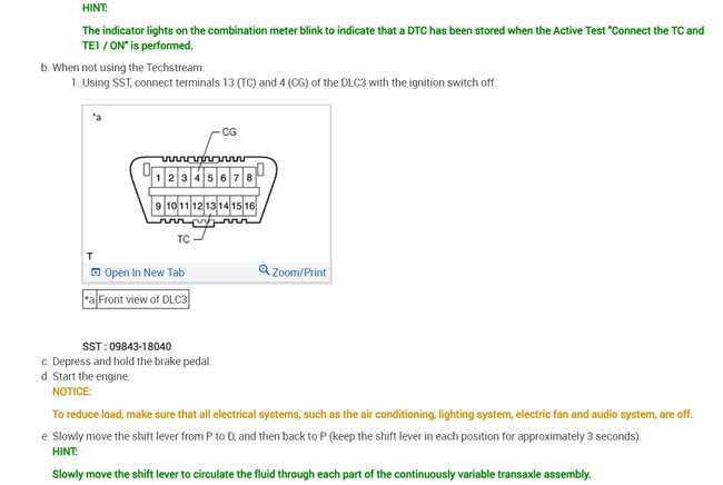

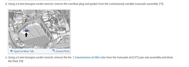

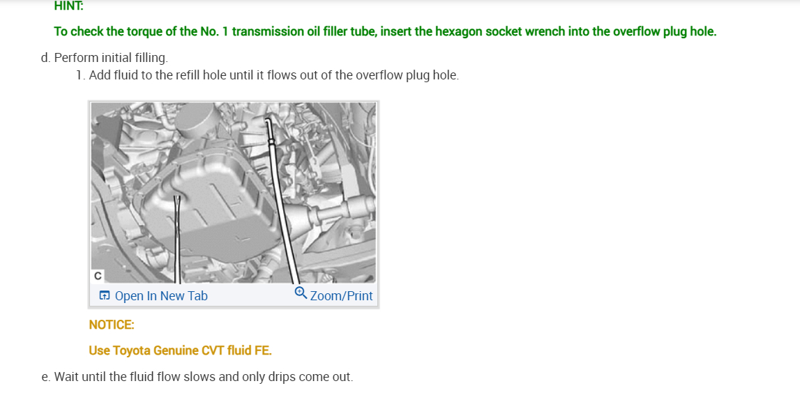

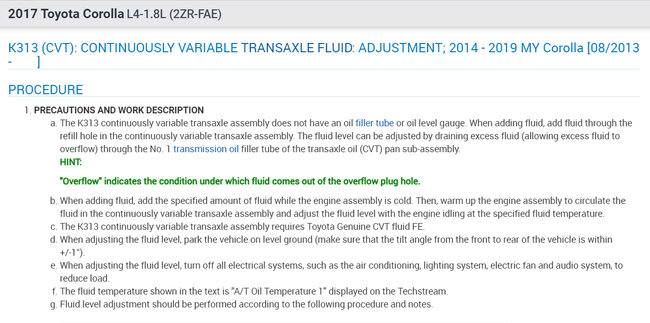

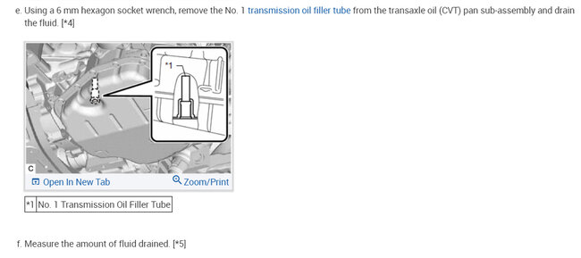

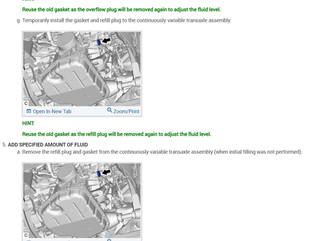

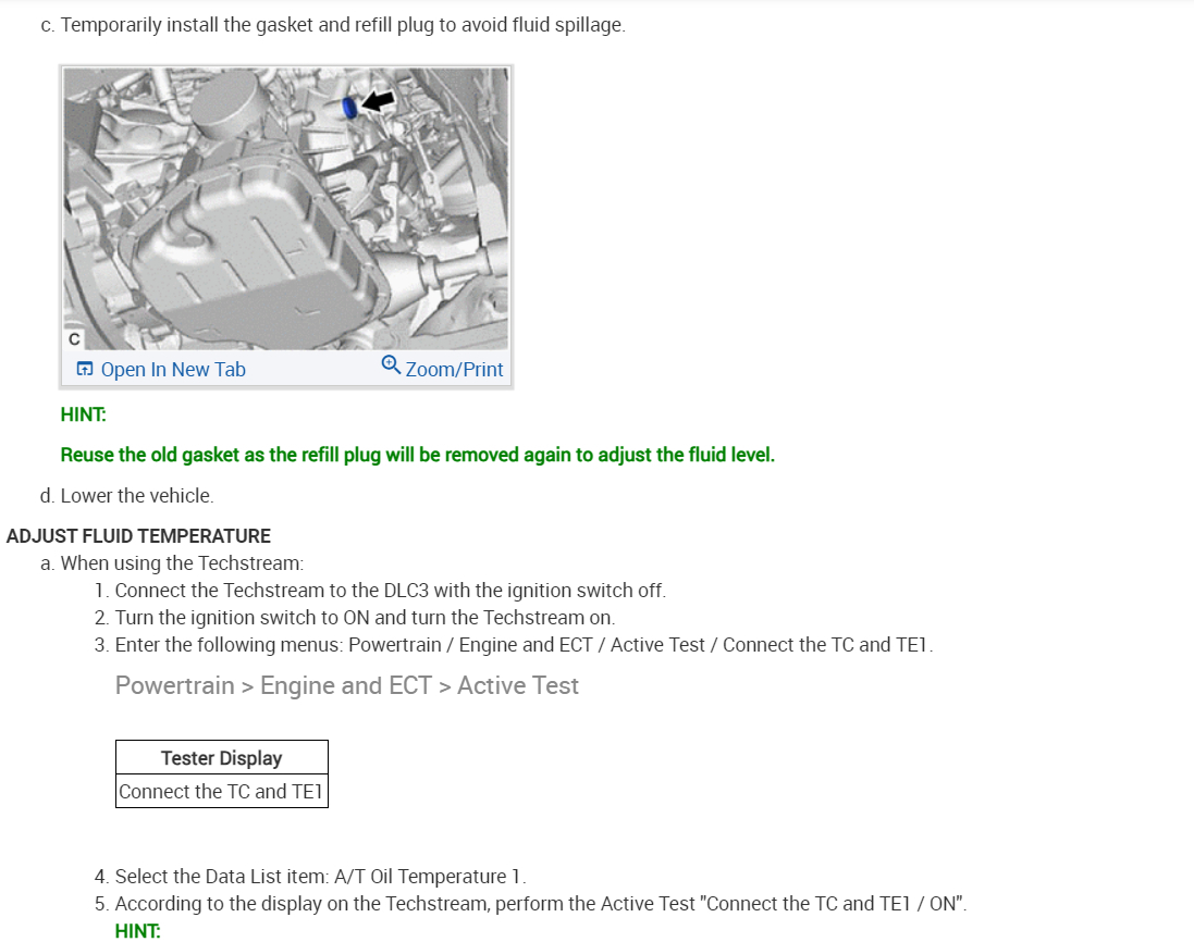

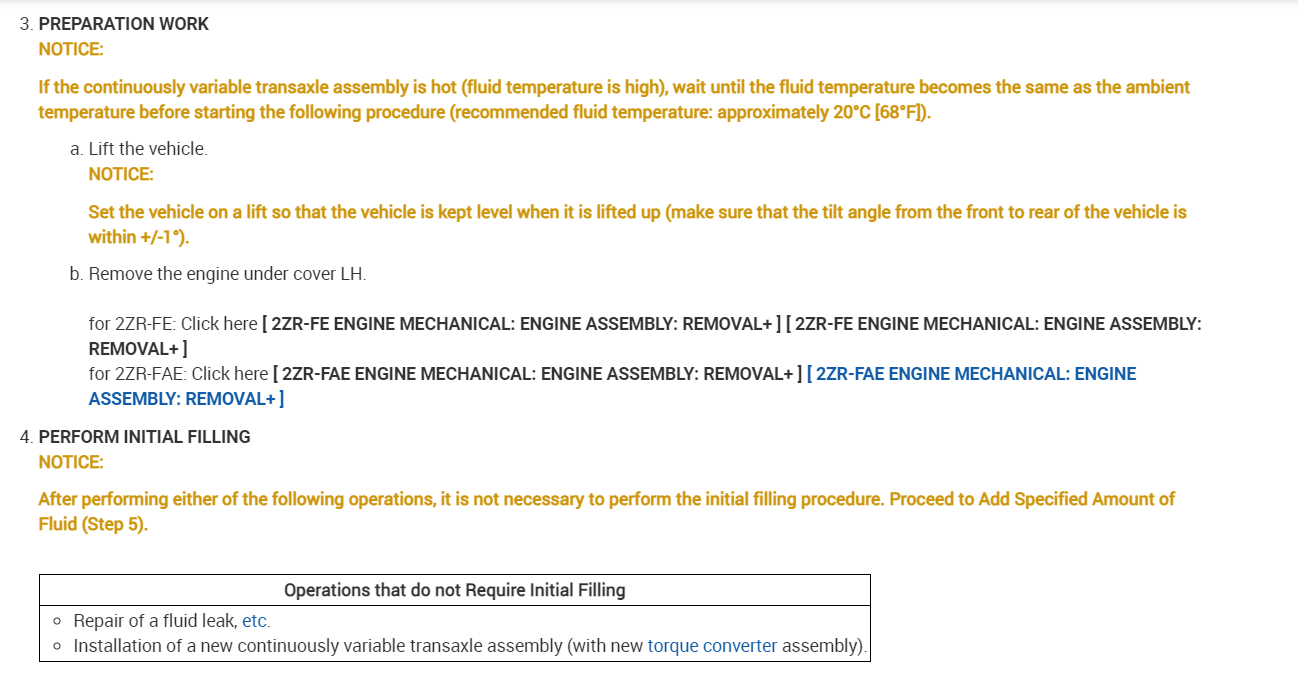

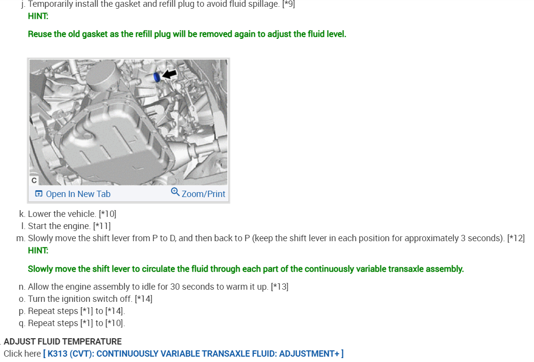

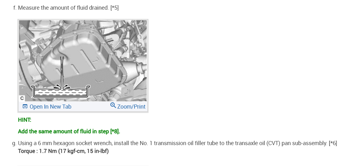

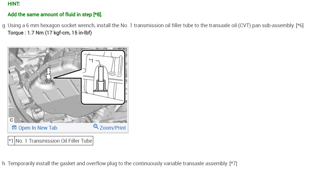

The first thing I would do is change the transmission fluid, here is a guide to help and instructions for your car in the images below:
https://www.2carpros.com/articles/how-to-check-and-add-transmission-fluid
and
let's run the codes as well to see if anything comes up.
