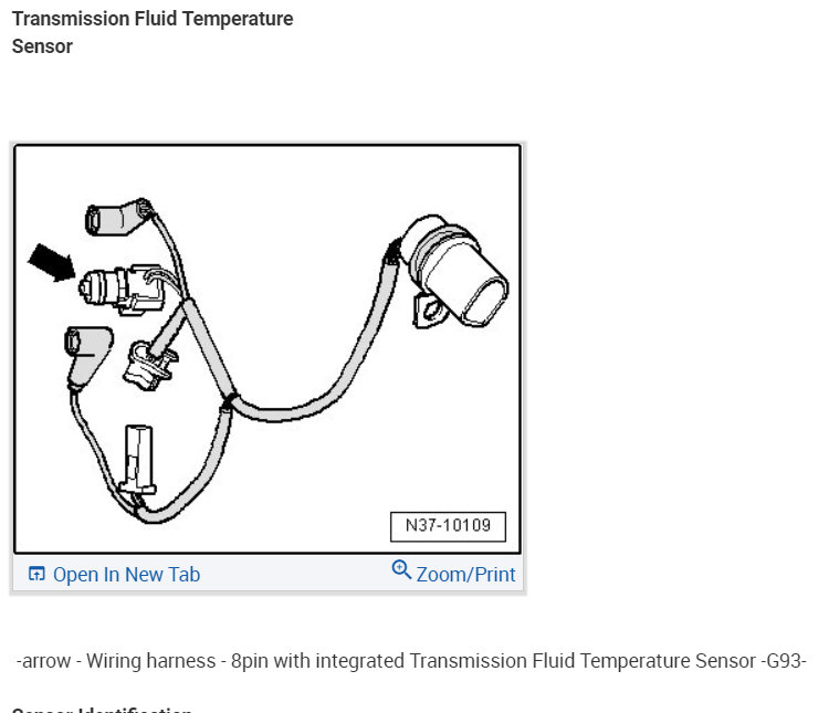

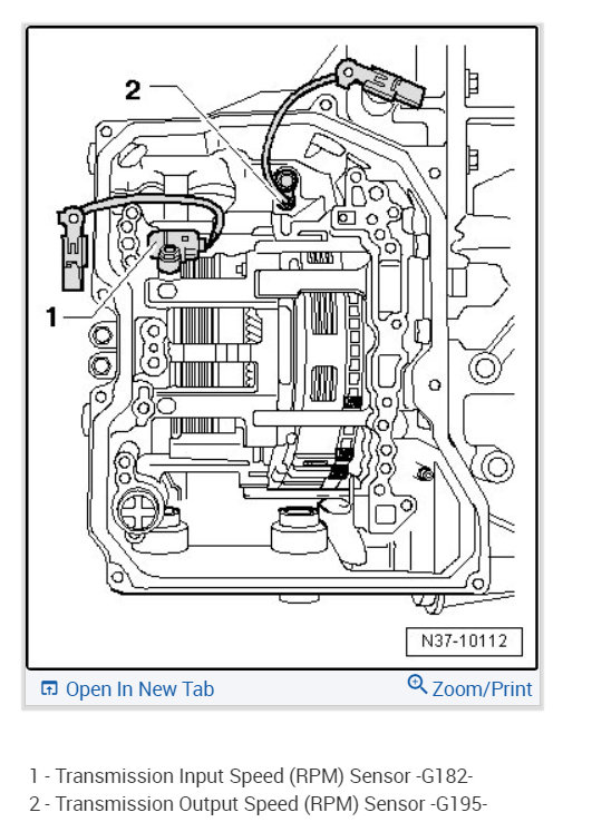

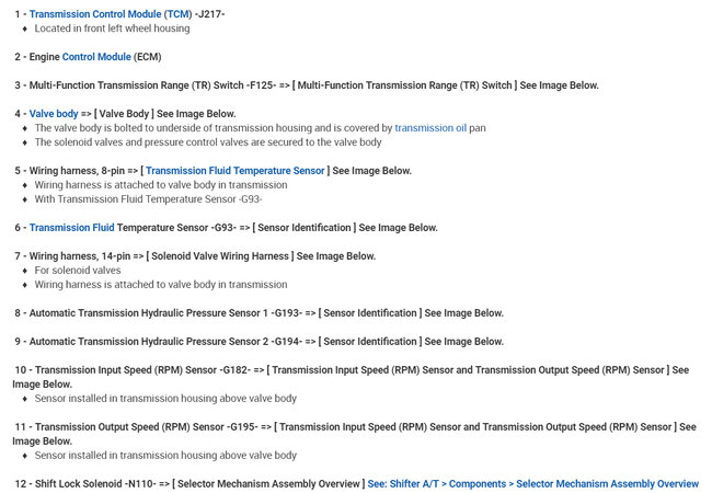

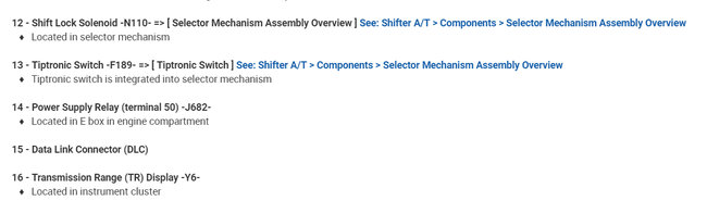

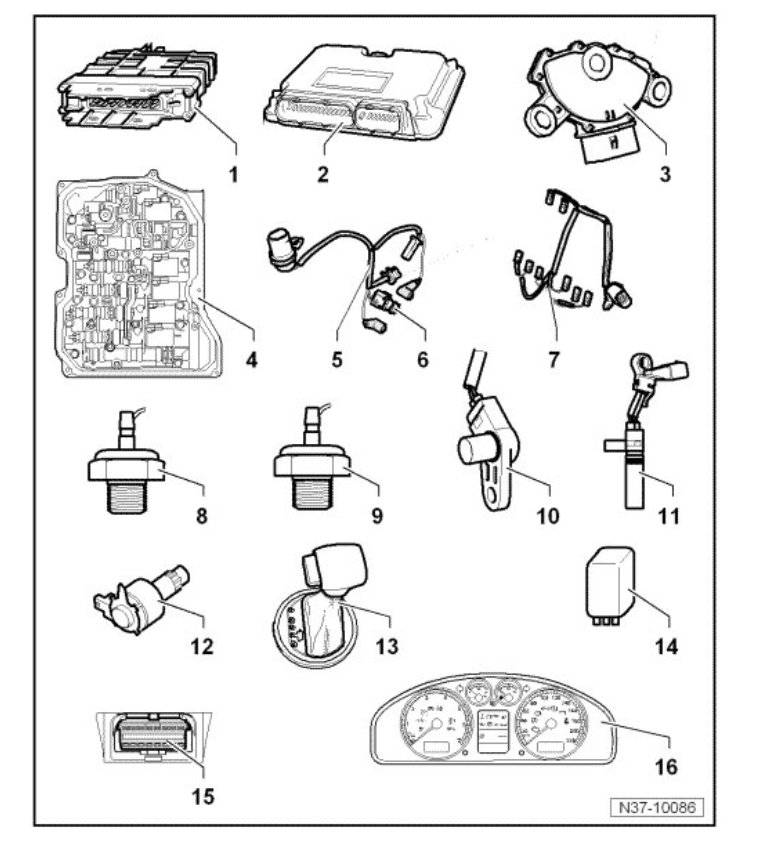

It sounds like you have an input shaft speed sensor that needs to be replaced. To be sure here is a guide to help check the codes with the input shaft speed sensor location below. I have also included the components of the transmission so you can see how it works.
