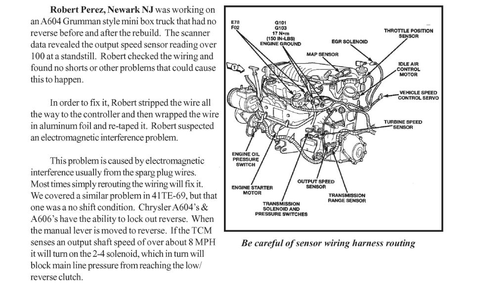

Good morning.
Did you have the new one flashed or programmed to the cars VIN?
If you did not that would cause this issue if you did not have this issue prior to the repair.
Found an article from someone from Chrysler on this issue.

Good evening.
Did this issue exist prior to the PCM replacement?
Does the fluid smell burned or is it discolored?
It sounds like a mechanical issue as engagement is mechanical, not electrical.
