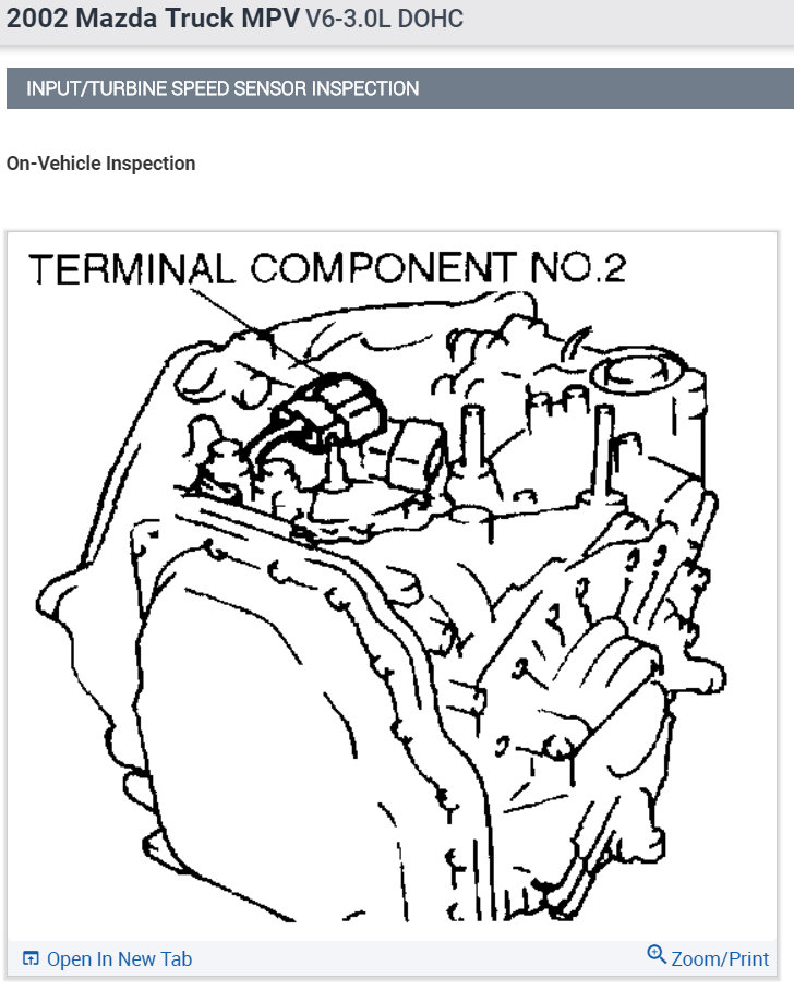

No issues with the transmission the other night I kind of pulled out in front of some one close so I kind of gunned it it shifted hard in second then it kind of started bucking so I let off and pulled over. It was like the transmission was in not in gear. I shut it off let it set ten minutes it went back in gear went fifty feet then quit. So I had it towed home. Fluid is full and clear.

This sounds like the input shaft speed sensor is not working right but to be sure lets run the codes to see what comes up.

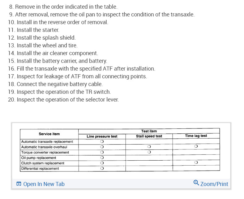

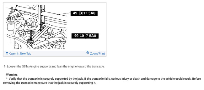

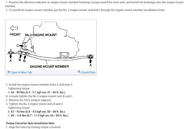

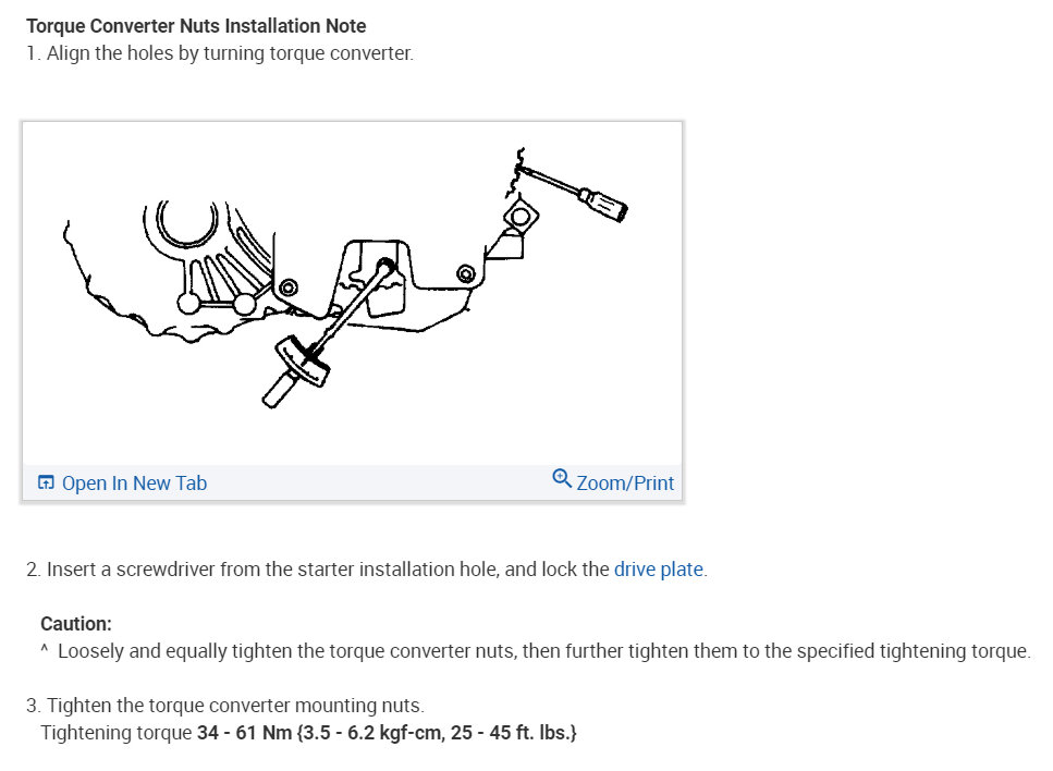

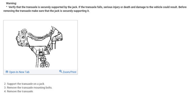

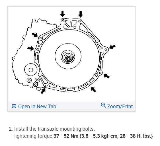

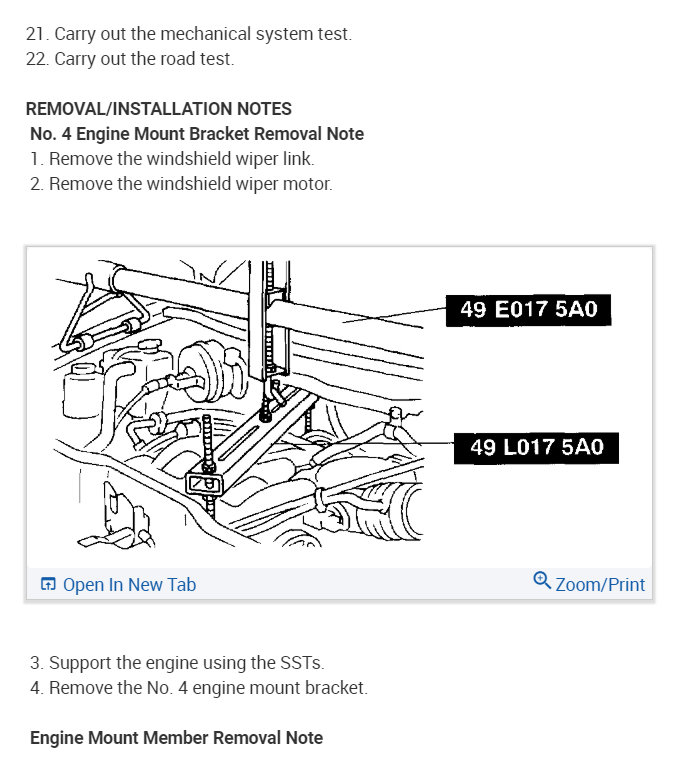

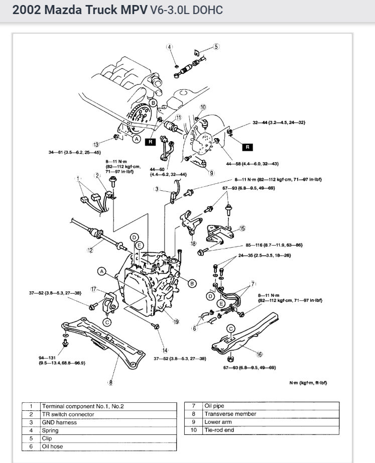

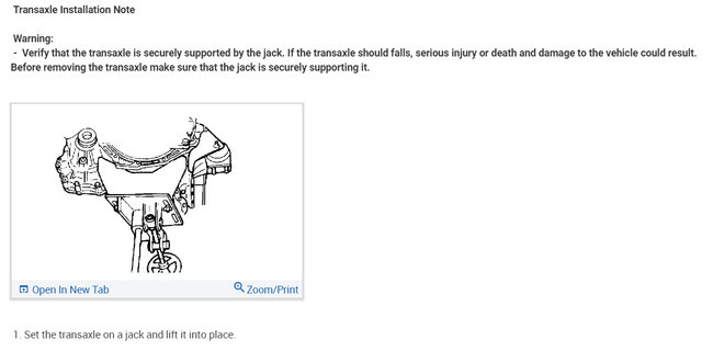

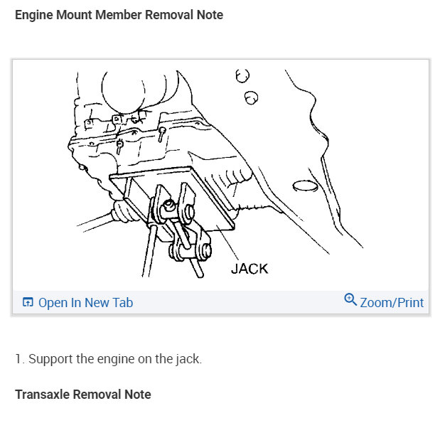

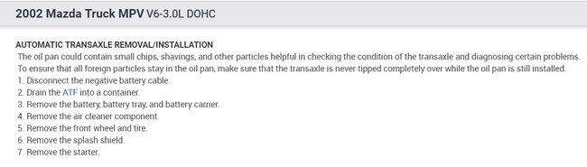

Even though you do not have a code for it I would try an input shaft speed sensor. If that does not fix it the transmission is probably bad.
Here is a video that will help you see what to do to get the transmission out (different car but the process is the same) and diagrams below to show you on your car:
