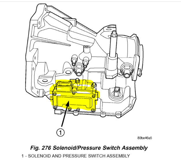

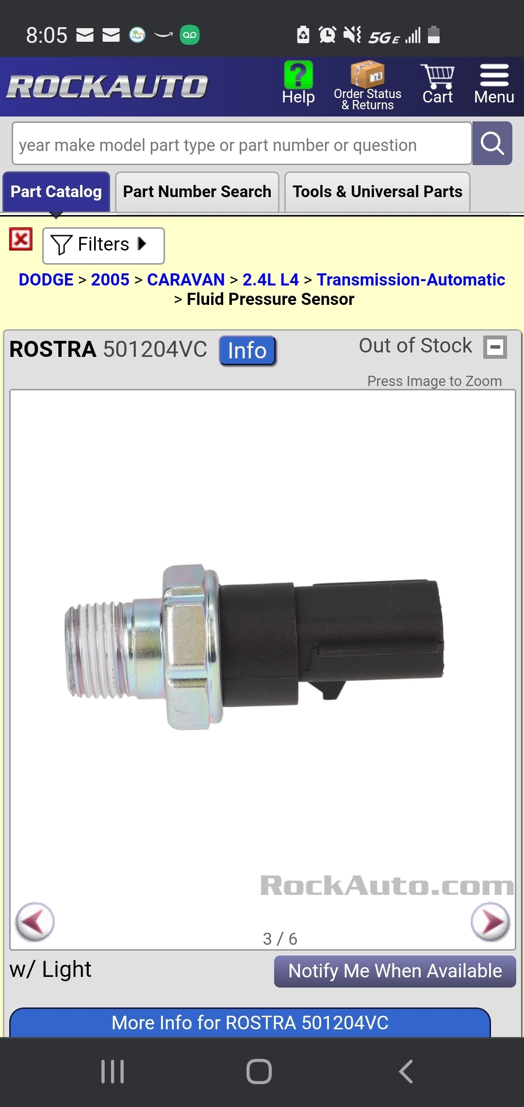

Hello, I need help. I am trying to find the location of the transmission pressure switch for my vehicle listed above. I have been unable to find any information online. Thanks in advance!
Oct 22, 2024 at 10:15 AM
  • 110,244 POSTS
The PCM/TCM relies on three pressure switches to monitor fluid pressure in the L/R, 2/4, and OD hydraulic circuits. These components are integral to the solenoid/pressure switch. The pressure switches can only be serviced by replacing the assembly. (see pic below)
Let me know what codes you have so I can better pinpoint what you are dealing with.
See pic below.

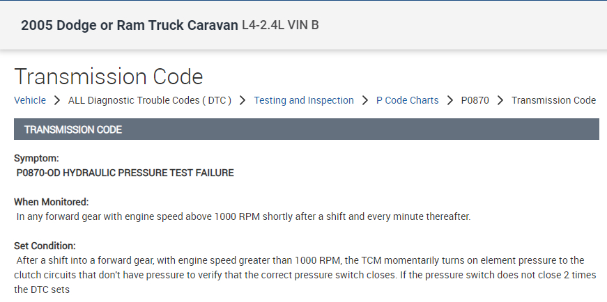

The codes are P0700 and P0870. Thank you
Oct 23, 2024 at 12:29 PM
  • 110,244 POSTS

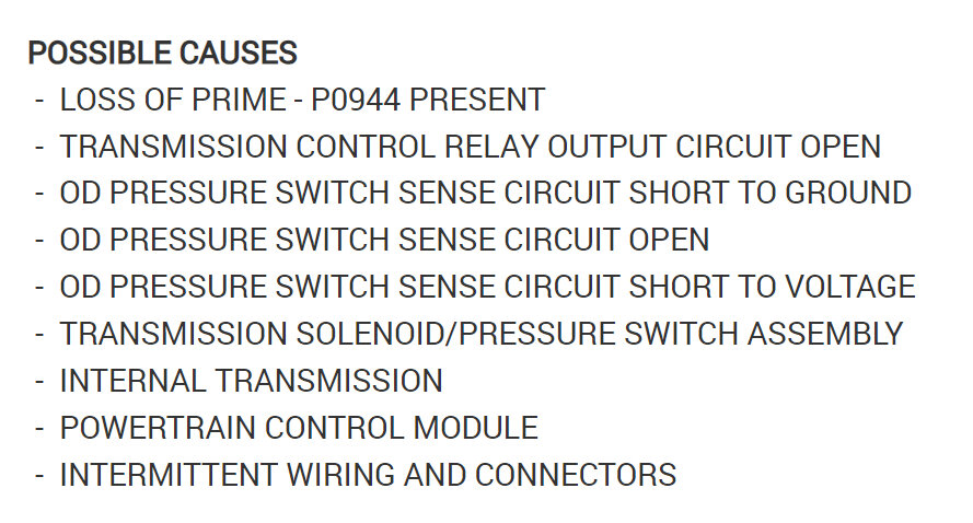

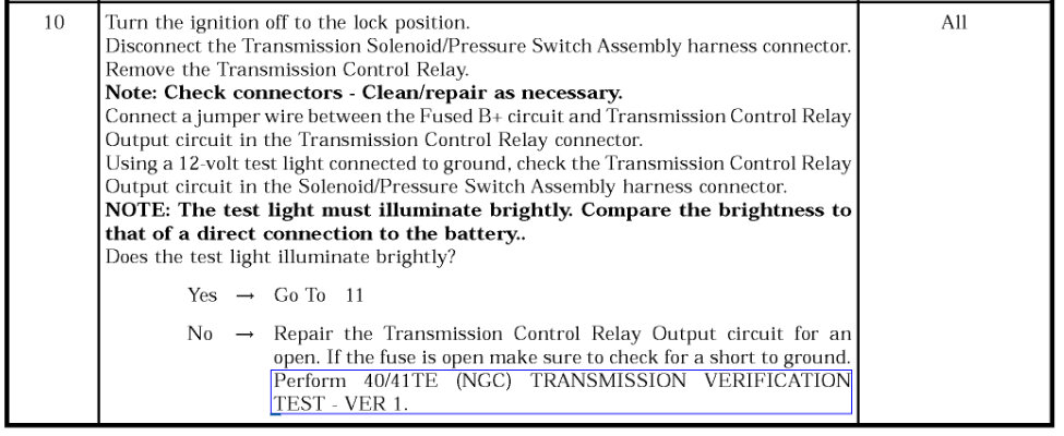

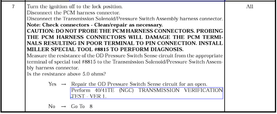

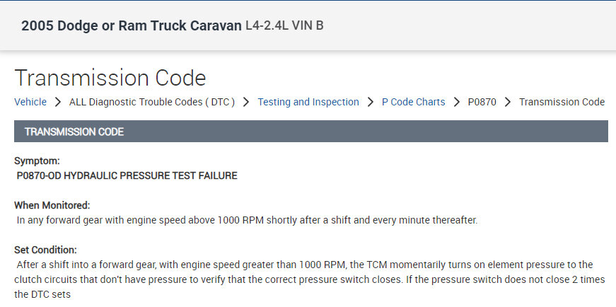

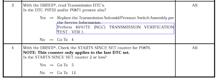

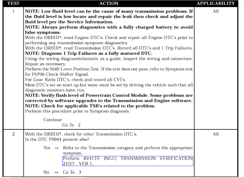

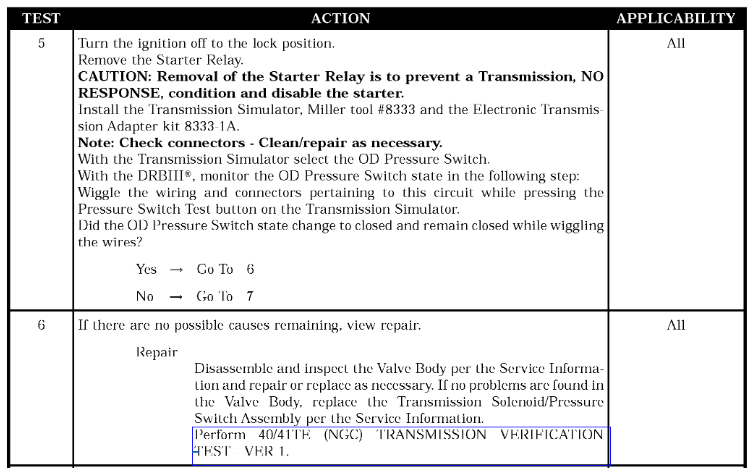

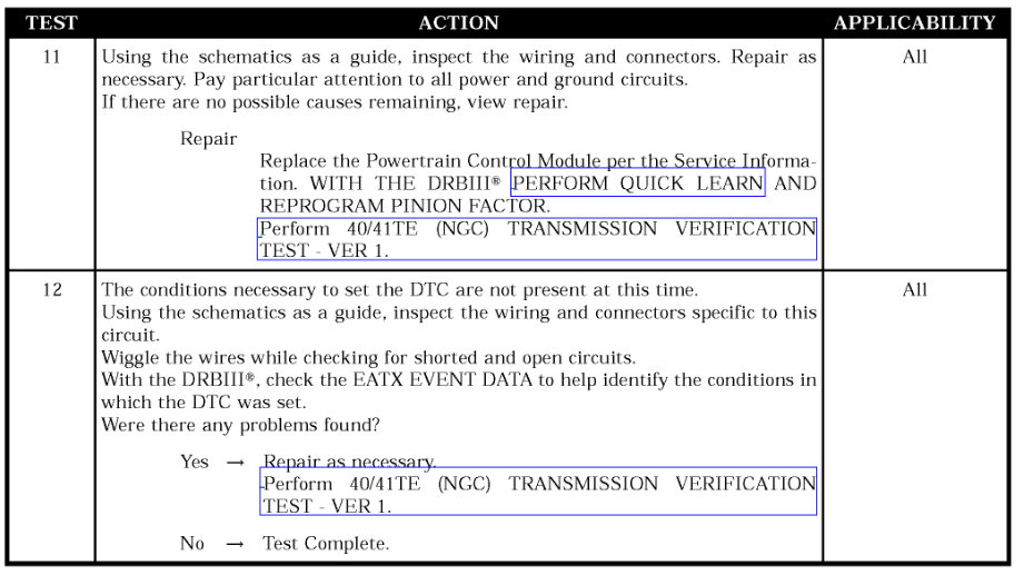

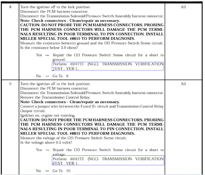

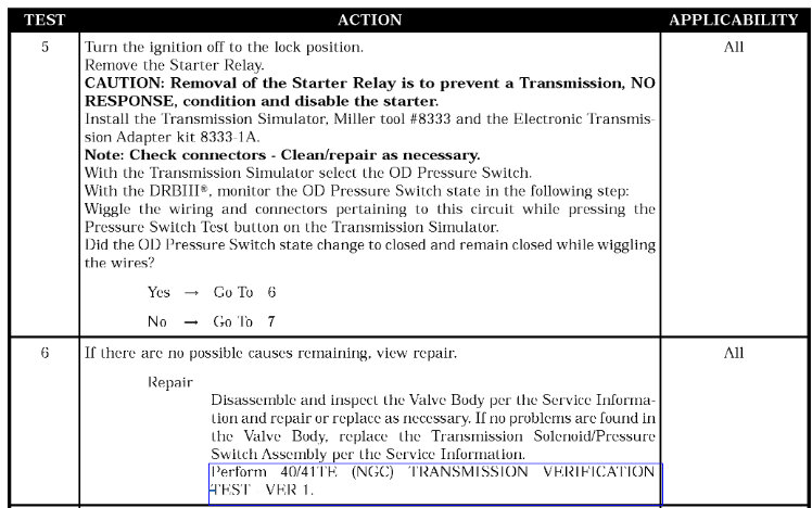

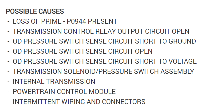

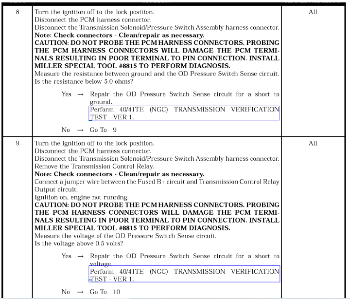

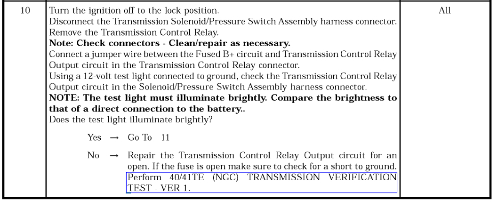

The P0700 is a generic code that simply indicates there is a code, or codes stored in the TCM. The P0870 is the one of concern and I do see why you indicated the pressure switch. However, there are several things that can be setting that code.
I attached the diagnostics for P0870 below. Take a look through them and let me know if you are comfortable performing them.

I ended up changing fluid, input and output speeds sensors and solenoid. So far it is shifting fine and no lights. I am around 100 miles in since maintenance.
Dec 3, 2024 at 11:47 PM
  • 110,244 POSTS
Thanks for the update. I'm glad to know if is working properly now. Hopefully, it will continue.
