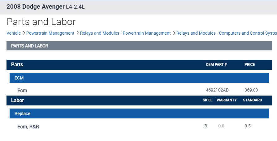

Interestingly, I'm showing a different OEM part number for the ECM. See pic 1 below. Was that number on the original component?
Oct 31, 2022 at 10:53 AM
KRZYSZTOF
  • 32 POSTS
this what i got from the dealer when i gave them vin number 40 trs transmission and the part number i send you is from original ECM what is on the labels. thanks
Oct 31, 2022 at 9:50 PM
