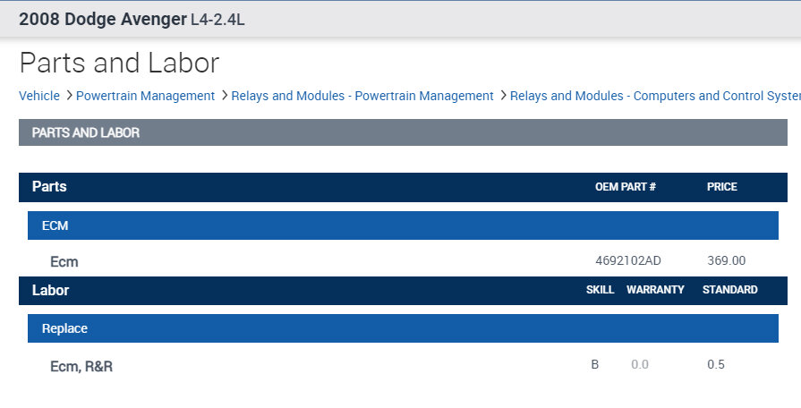

Interestingly, I'm showing a different OEM part number for the ECM. See pic 1 below. Was that number on the original component?

this what i got from the dealer when i gave them vin number 40 trs transmission and the part number i send you is from original ECM what is on the labels. thanks
