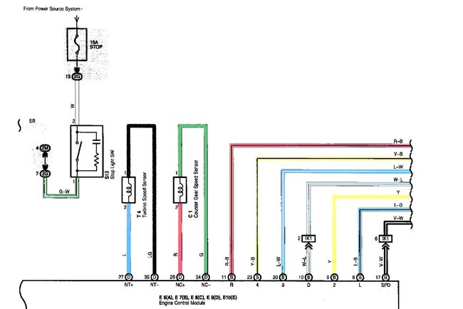

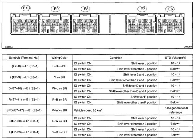

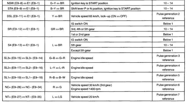

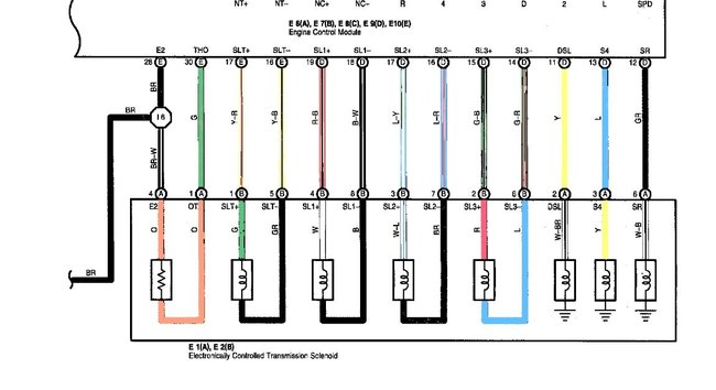

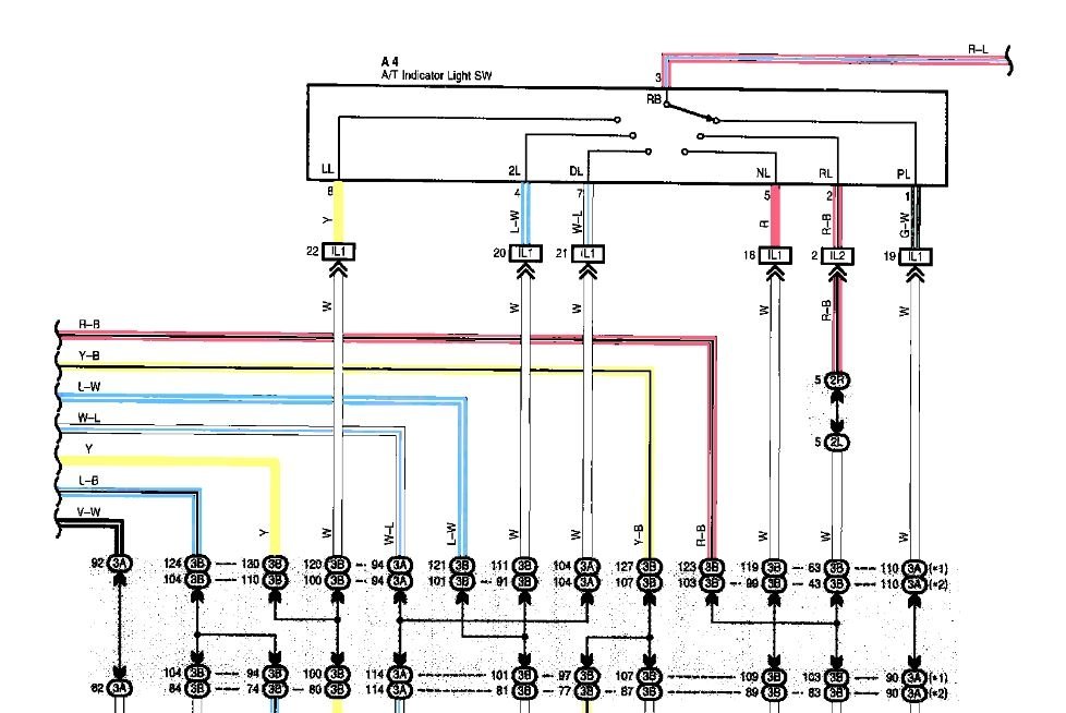

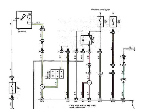

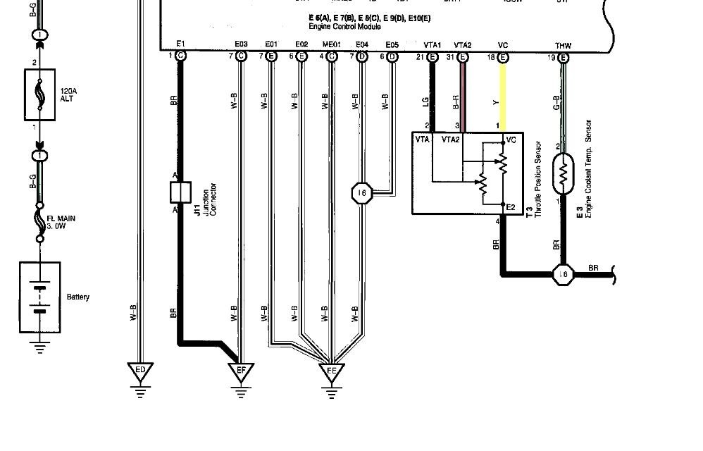

Good afternoon,
The vehicle's transmission had issues, it was replaced but during the replacement the connector of the transmission was broken which makes the pins disordered. I don't know if I can get a circuit diagram on it from the PCM to the Transmission and the PCM circuit diagram, someone has connected some wires that I understand not.
Sep 4, 2021 at 8:49 PM
STEVE W.
  • 15,418 POSTS

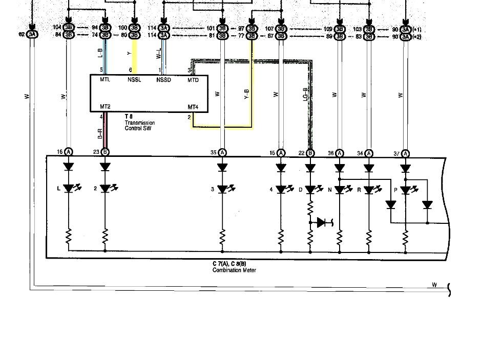

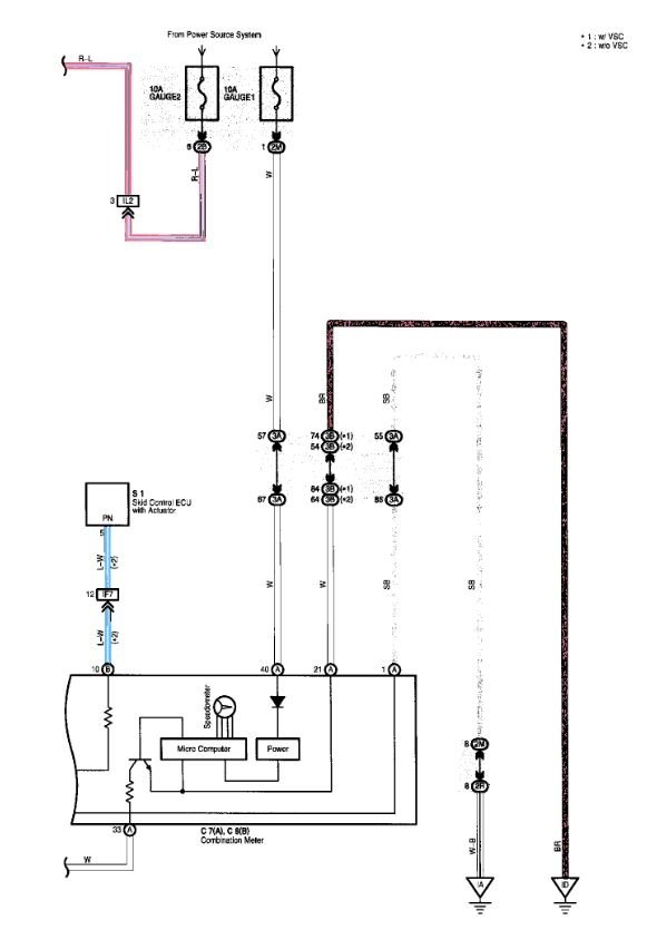

These are the wiring diagrams for the ECU to transmission circuits, and the pinouts at the ECU. I don't find a connector view for the transmission end but I'll keep looking and update this if I find one.

The vehicle is working fine now. thank you
