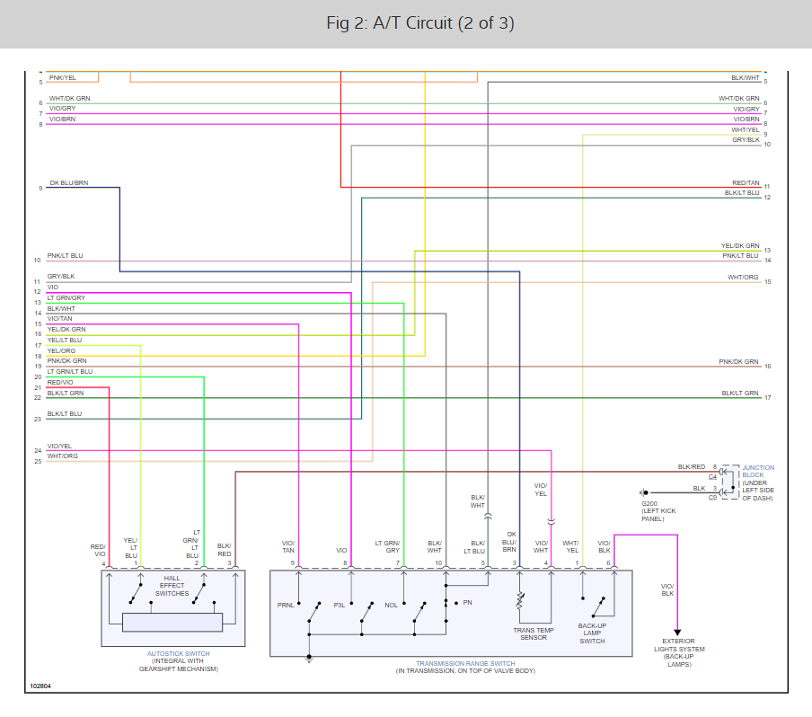

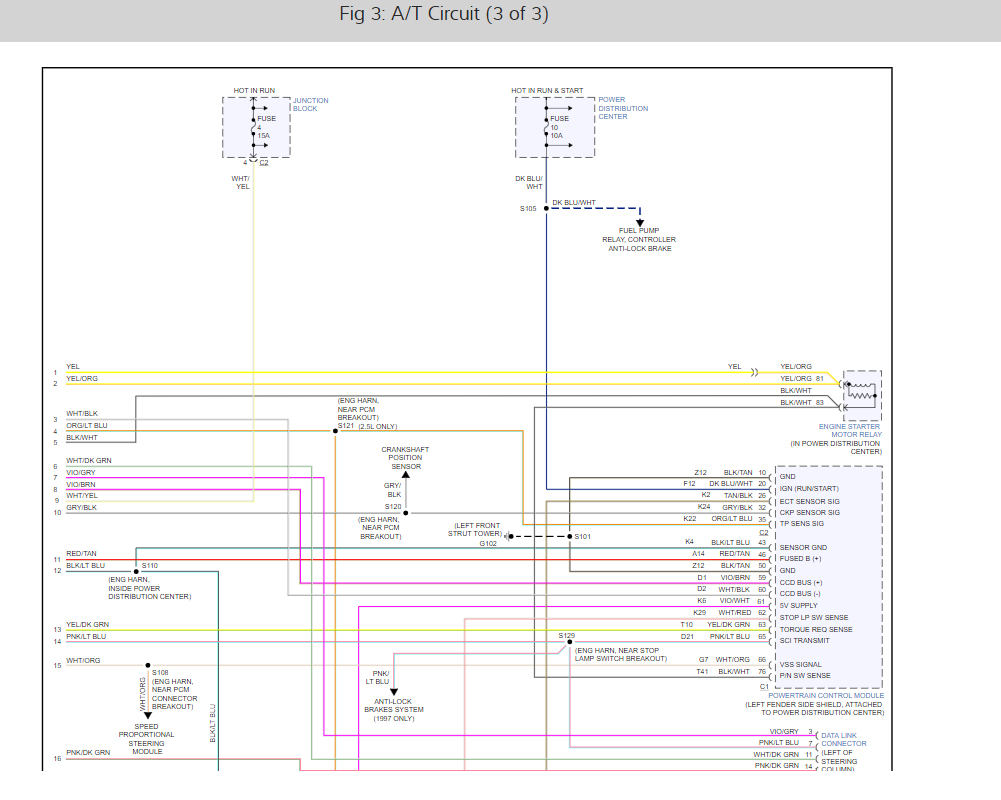

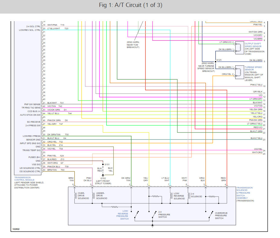

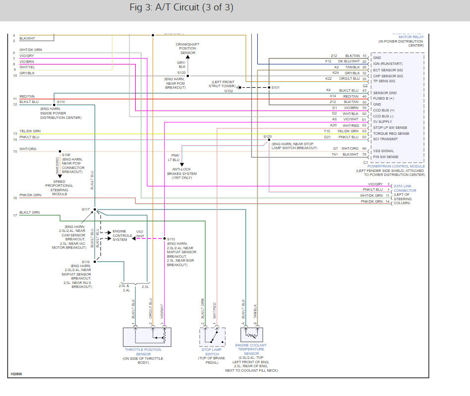

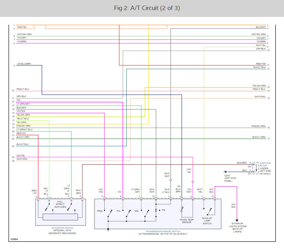

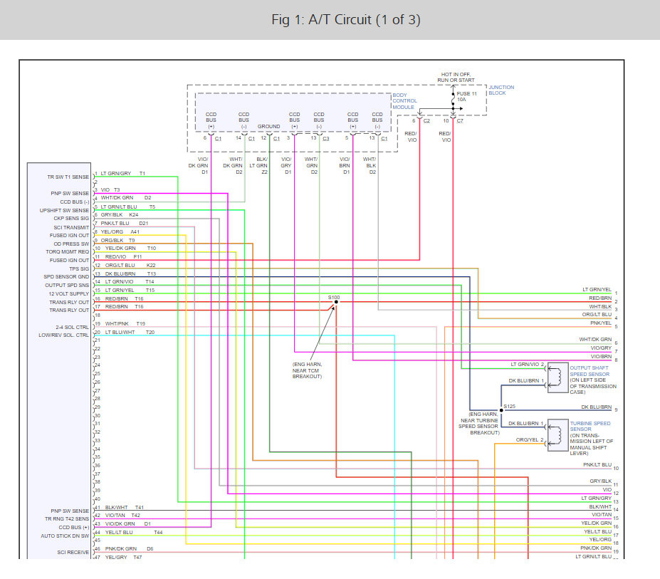

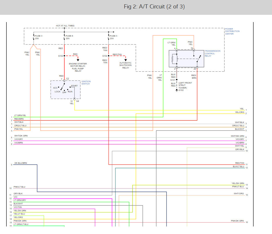

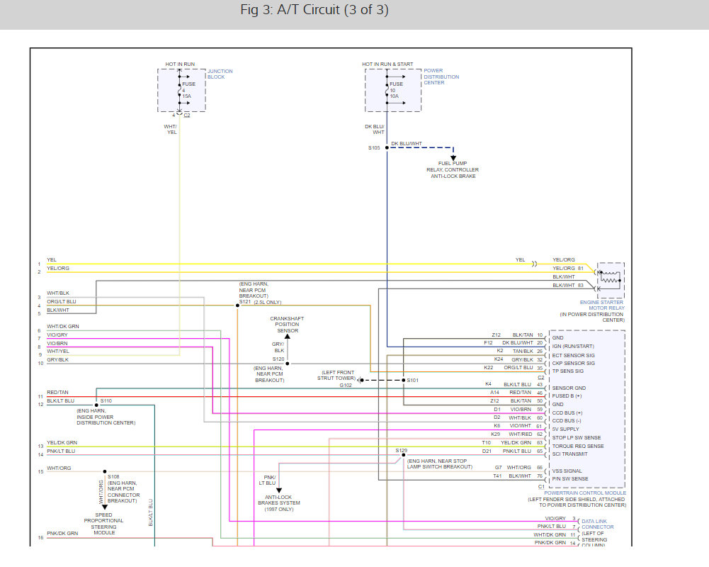

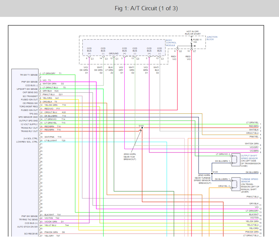

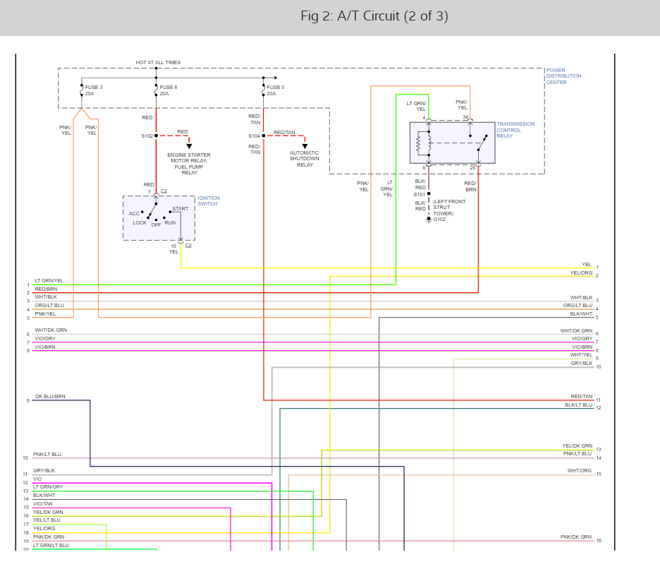

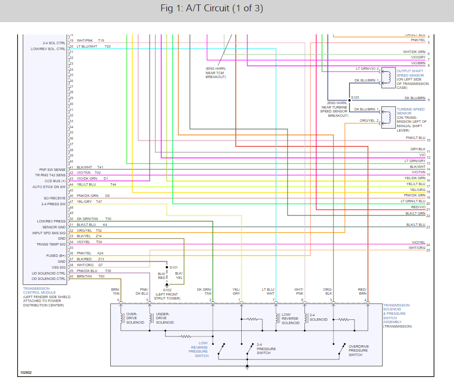

How to put transmission pin back in when it slipped out of transmission.
Sep 26, 2020 at 4:07 AM
Experienced Mechanic
55,649 POSTS
Here is a guide to help heck the wiring with the transmission wiring and pinout diagrams below:
Images (Click to enlarge)
