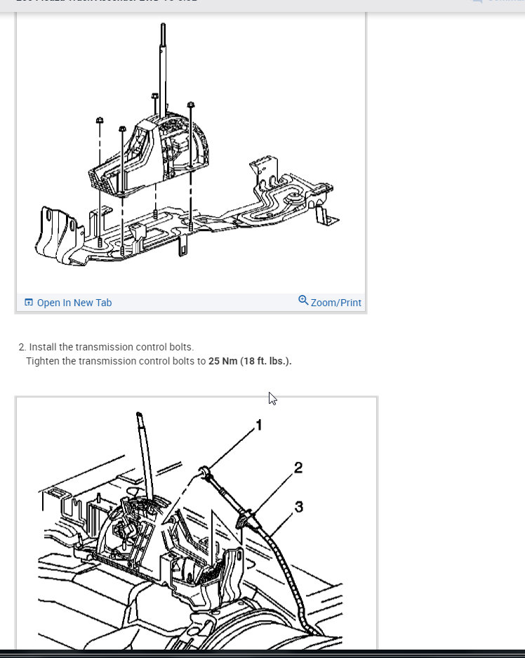

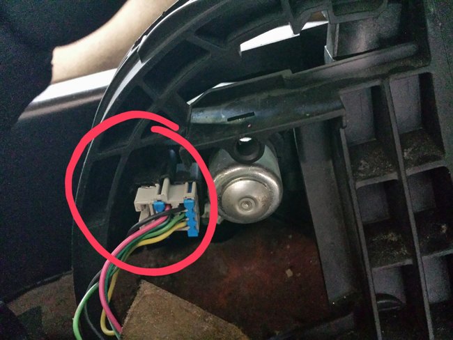

Suddenly, my car cannot be drive. Someone finds a broken piece. He told me to buy transmission control solenoid. But, the part, at its side (a plastic one with cables), a part that I don't know its name, is broken too. This piece is like grey color with something like blue pieces attached. Also, has about 4 cables, 2 like yellow, one black and one red (or pink color). I need to know the name of this piece so I can try to buy it on an auto shop or junker, maybe.
Jan 15, 2020 at 12:48 AM

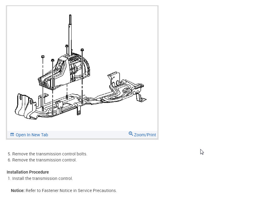

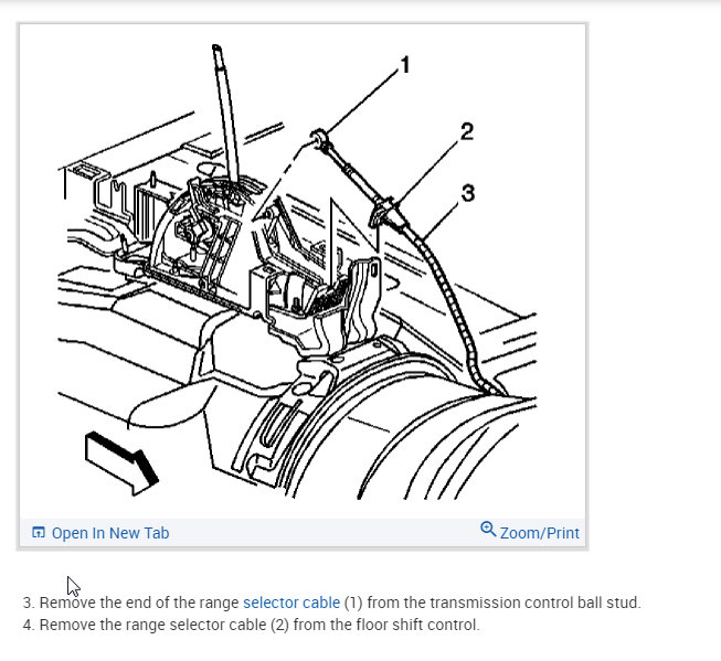

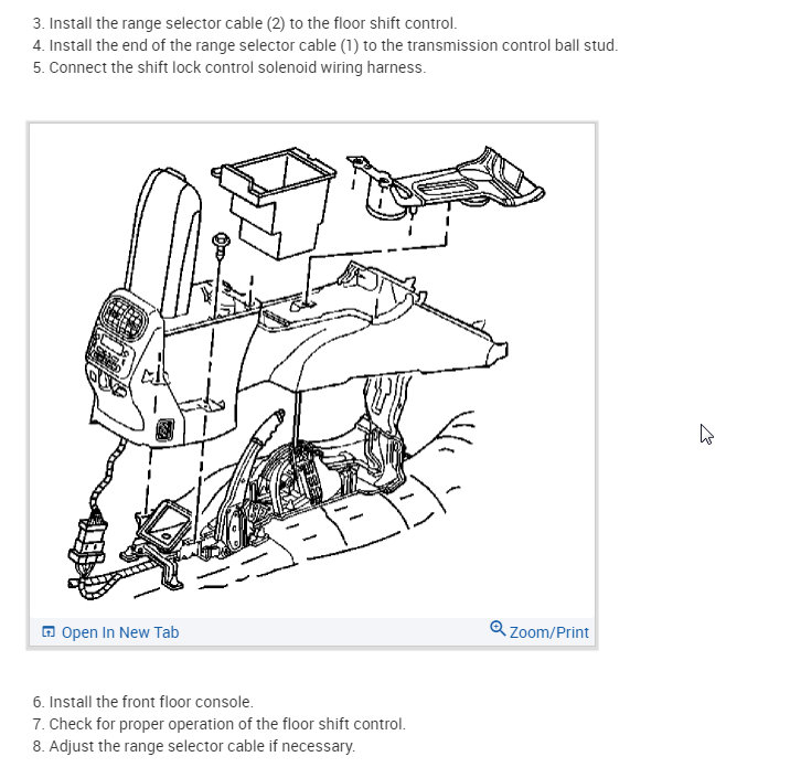

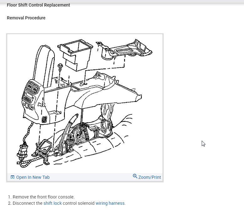

I assume you are talking about the shifter assembly. I attached the process for this which will show what the same part that I circled. Let me know if this is not what you are talking about. Thanks

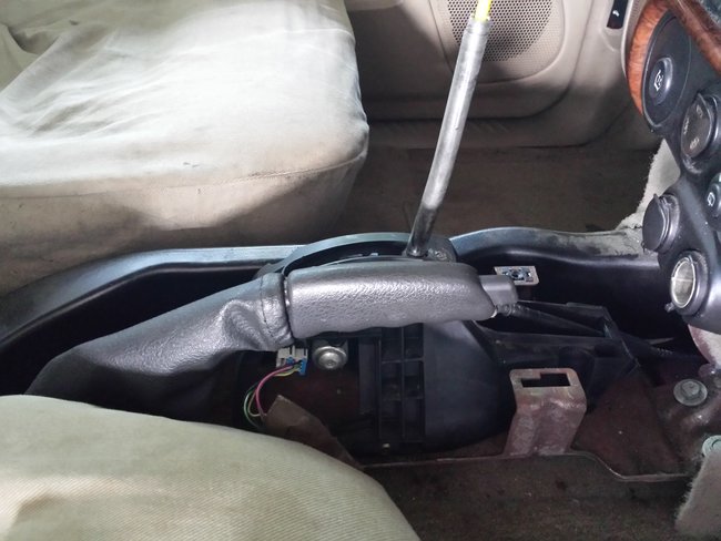

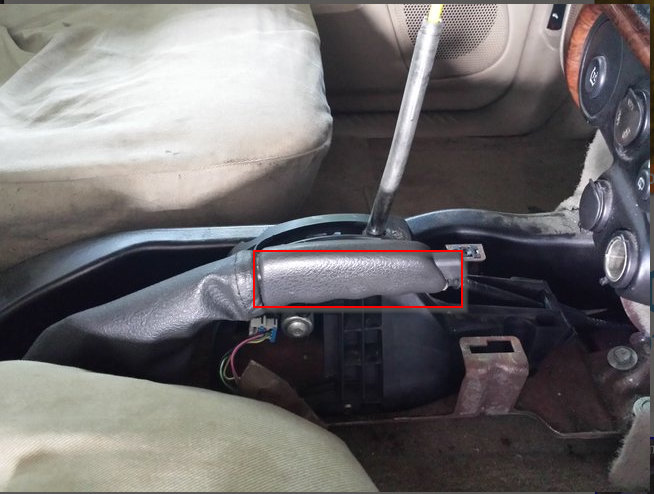

I want to know the name of the plastic gray color piece, so I can buy its replacement. Do you know it?
Jan 18, 2020 at 8:09 AM
The piece that I circled in this attachment? If so that is the parking brake handle.
If not, can you get another picture with you pointing at that piece you are looking for? Thanks
Jan 18, 2020 at 11:24 AM
MARIBELDELEON

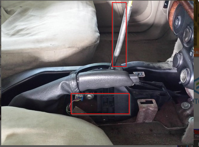

I am looking the name of this at the circle...
Jan 18, 2020 at 9:22 PM

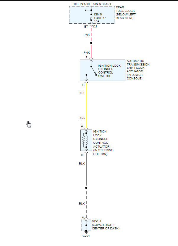

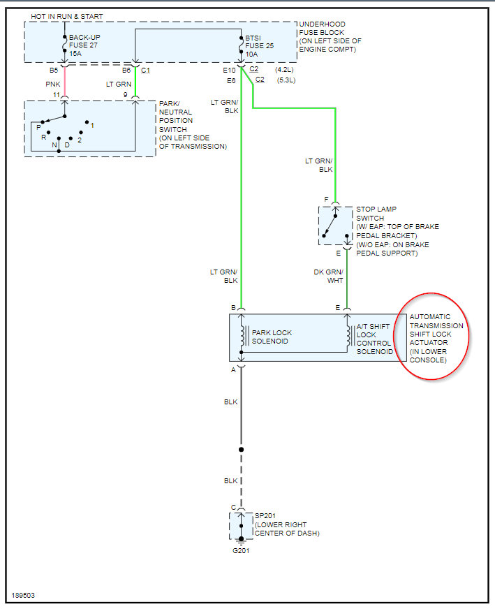

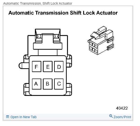

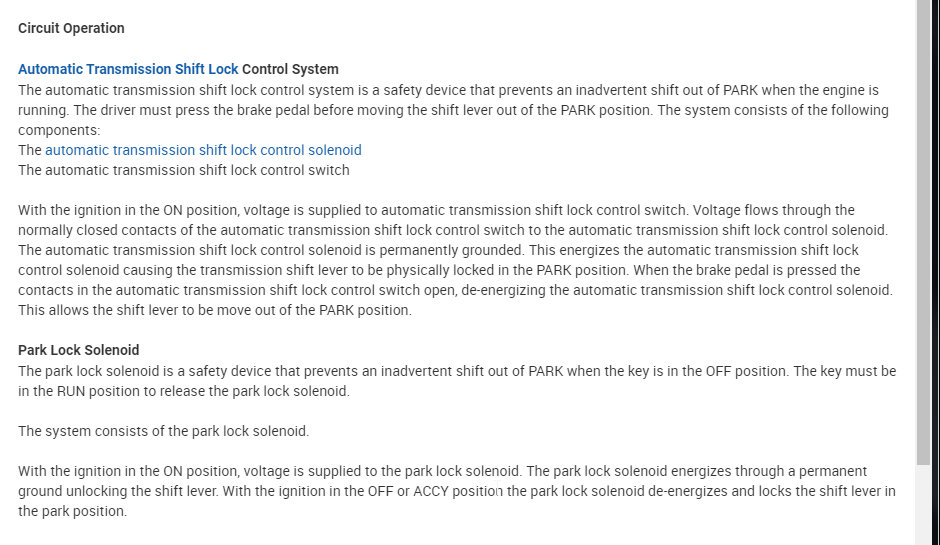

This is the shift lock actuator wiring connector. I attached the info about the shift lock system.
