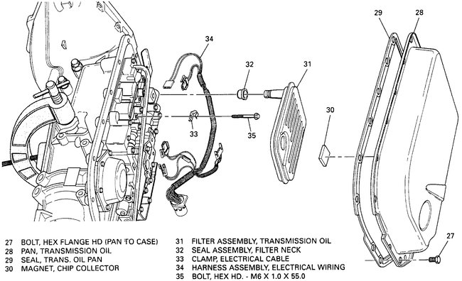

I have a turbo 350 in my k1500. And my old pan was warped and the gasket was bad. So I bought a brand new pan with a new rubber gasket. I tightened hem down to when the rubber started squeezing out. And it’s stilling at a bolt. Why?

Do you mean it is leaking where the bolts tighten the pan to the housing? Are you sure you didn't over tighten the pan and split the gasket? I attached a pic of the pan assembly. Let me know exactly where it is leaking.
Also, picture 2 is the torque specs for the pan. When I tighten them, I draw them all snug, then in a crisscross pattern work my way around the pan to final torque.

That’s not the right transmission. But yes I tightened them to 8 pounds when I did it.

Interesting. That is the one they show for this model. If it is still leaking where the bolts go through, I have one more question. Is the pan new that you installed or used? If it was used, did you peen the bolt holes flat?

The only thing you can do is check to make sure you didn't split the gasket, check the transmission case to see if it is flat and there are no hairline cracks, and take a ball peen hammer and slightly peen the bolt holes on the pan away from where it mounts. Also, check to make sure the new pan is true.
I'm confident that isn't what you wanted to hear, but it has to come off again to determine the cause. You can try to save the fluid.
