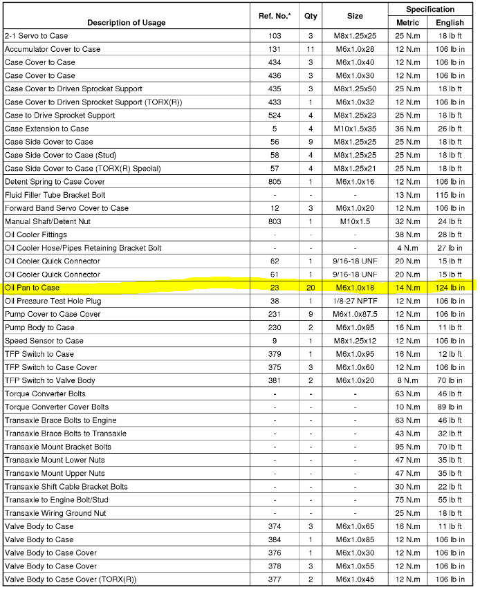

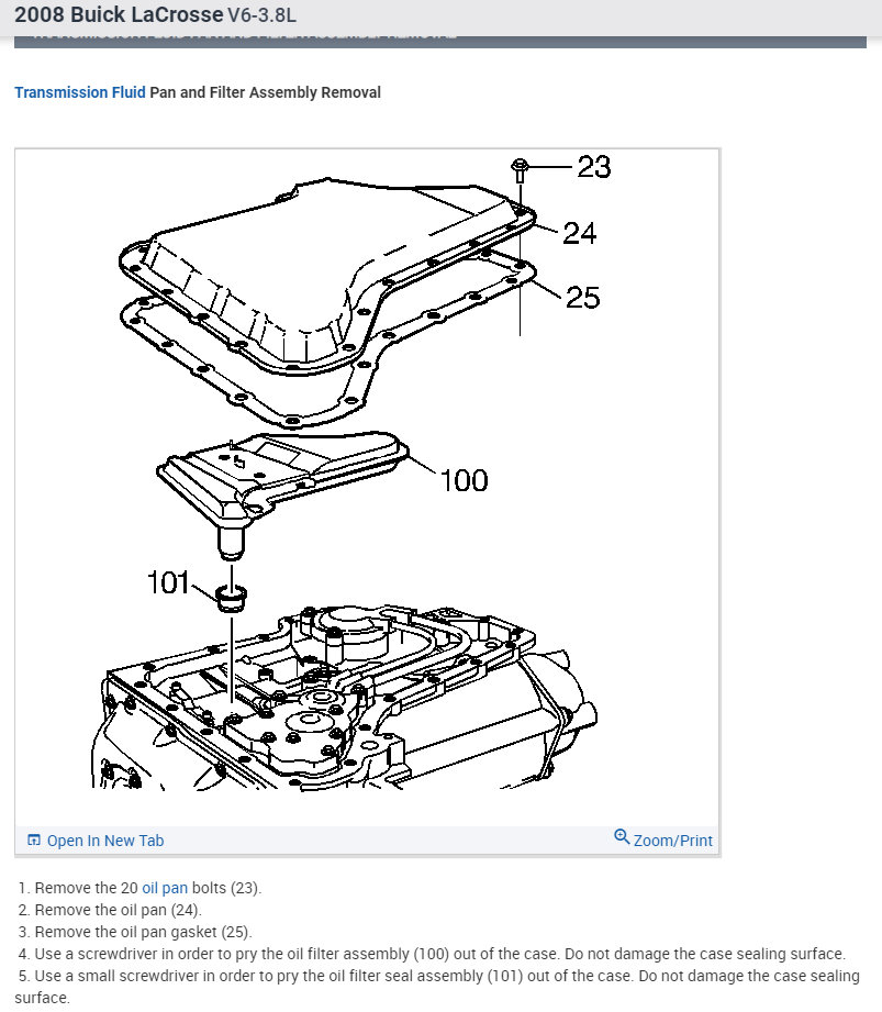

The pan gasket is a reusable one. I will replace it anyway with a new reusable gasket. When replacing the gasket do I need to use any gasket sealer on it before installing it? Thank you. Bryan Stryck.
Jun 19, 2022 at 11:52 AM
SQM
  • 6,383 POSTS
On this vehicle using a gasket sealer is not required. However, many people use gasket sealers when replacing the gasket.
I have attached the torque specification for the pan below.
Let me know of any questions.
