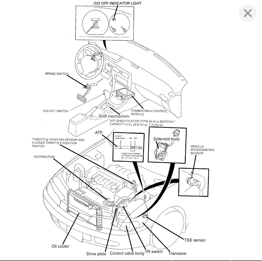

When trying to go 45-50 and hold that speed it starts slipping into neutral or into third gear. not sure where to even begin trying to figure it out or who I should take it to or if I should just get the fluid replaced. but then I was told if I replace the fluid it'll make it worse. I don't know what to do.
Oct 29, 2019 at 1:35 AM

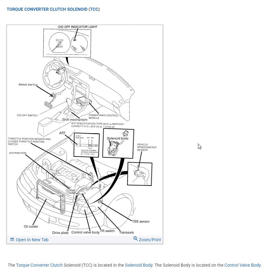

I would do just what you are suggesting. Check the fluid and make sure it is in good condition. If it is then you don't need to change it, just make sure it is full.
Then I would scan for any codes. I suspect you have a solenoid issue if all other gears are okay. However, we would need a little more proof of that before making a repair.
This guide will help
Let me know what you find and we can go from there. Thanks

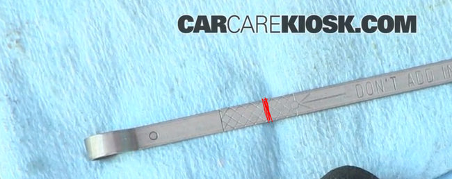

Currently with the car at operating temperature, on level surface, in park, checking the trans dipstick shows that the level is in between the hash mark, not too low, not 100% full though. The fluid is still lightly pinkish brown, no dark colors. No check engine light, would I code still be able to be present without a check engine light? Attached photo is from car care kiosk just to show you the level at which my 626 is at. Should it be topped off? Should I use something like Lucas oil trans fix to top it off?
I really have been freaking out over this as this is the last car out of 3 that was running correctly, the one I own. I have 2 roommates who also work and are now using my darn car to get around and now this is happening making 45 roads unable to be driven on. Which is most roads. It's nice to just be able to lay out my options of what to do so let me just say, thank you.
Oct 29, 2019 at 12:19 PM
I would not add any additives and the fluid level is fine but condition may be an issue. It should not be brownish. It should be brights pink. More than likely you have a solenoid issue and could have a code with no check engine light. So I would have it checked. However, if there are none there then we will need to get into some pretty heavy diagnosis. Let me know if you are going to perform this and i will send you how to test them. If not, I would just call around and take it to someone who works on Mazda's. They are pretty easy but the last thing you want is for someone to guess at this.

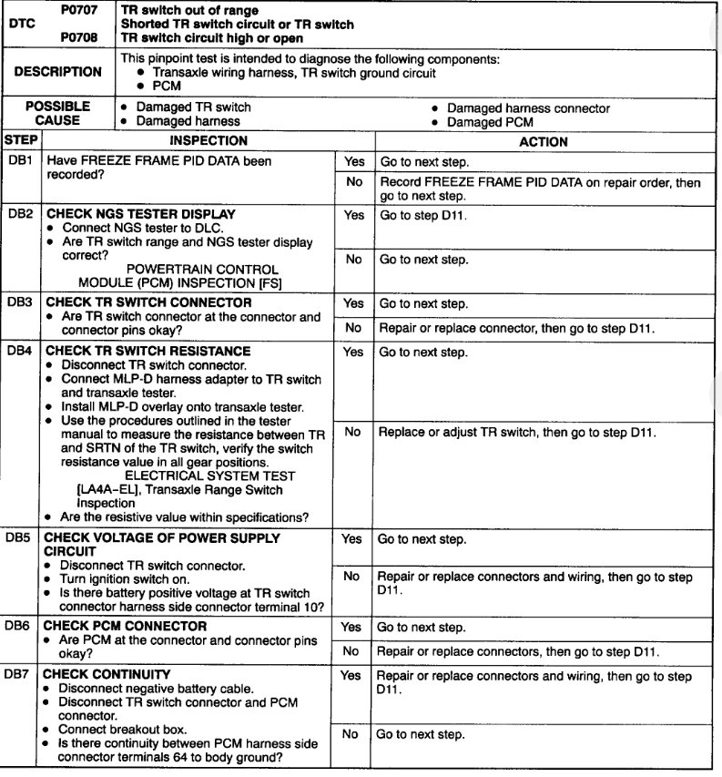

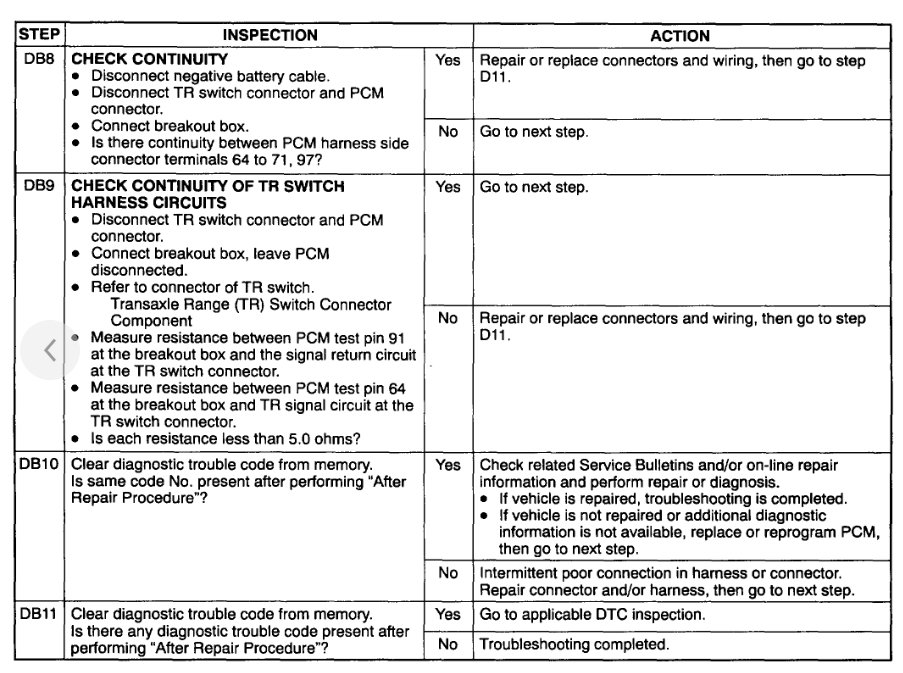

Send me the diag procedure and I'll see if I can do it. I'm worried with the shitty rep this transmission model has that it may just be slowly dying as it's worn out at 110,000.
Oct 30, 2019 at 10:19 PM

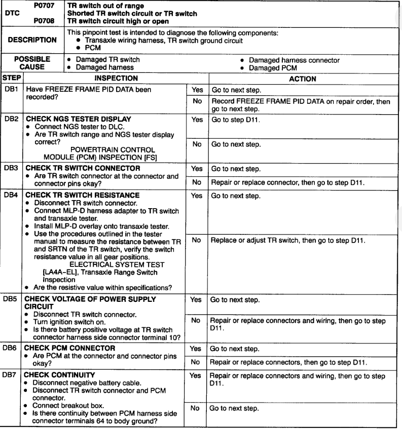

Here is the procedure for this code. Let me know what you find. Thanks
Oct 31, 2019 at 10:27 AM
TYDUDE2641
  • 5 POSTS
Just wanted to give an update on this. sorry it's so late, got a lot going on but good news is it's fixed. p0708 led me to search up very detailed about the 626. It was a faulty neutral safety switch sending wrong info to the TCM when hot. the sensors degrade over the years and then when they get hot it will cause the issue with a bad sensor. I replaced the sensor for about $22.00 and haven't had an issue.
