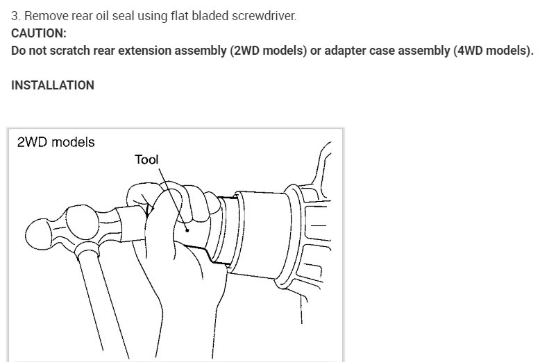

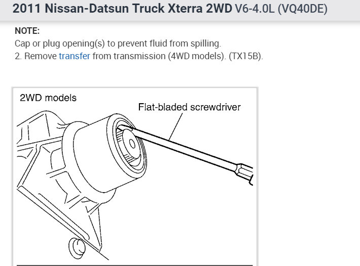

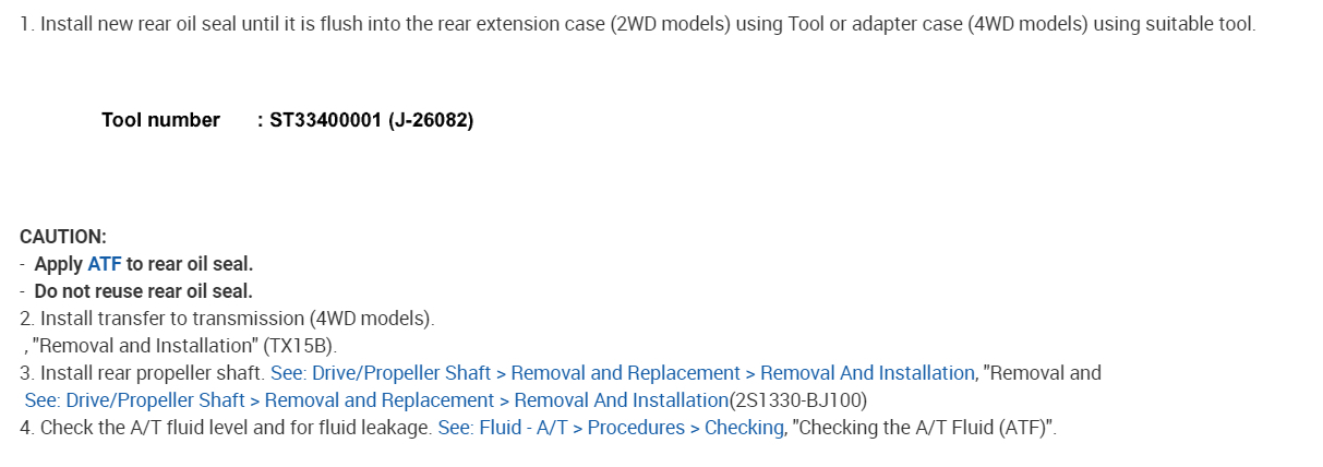

When doing the suspension the driveshaft slipped out. After sliding it back in there is ATF leaking out. What went wrong?
May 4, 2019 at 2:02 AM
  • 55,743 POSTS
What happened is the driveshaft yoke must have catch the edge of the seal and damaged it causing the leak. You must remove the driveshaft and install a new seal here is a guide and instructions and diagrams below to help you fix the car.
https://www.2carpros.com/articles/how-to-remove-a-drive-shaft
