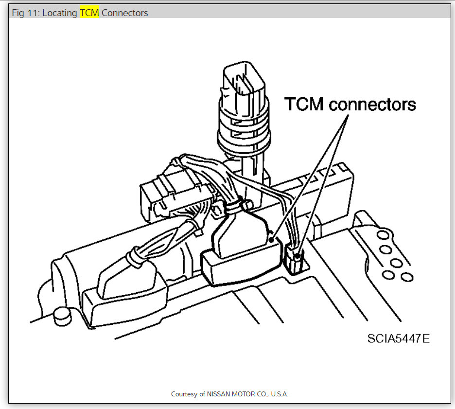

First, I want to thank you for your service, we sincerely appreciate you. :) Lets see whats going on here. The first thing we need to do is run the codes to see what comes up here is a guide to help us get started. You can get a coder reader for about $20.00 from Amazon.

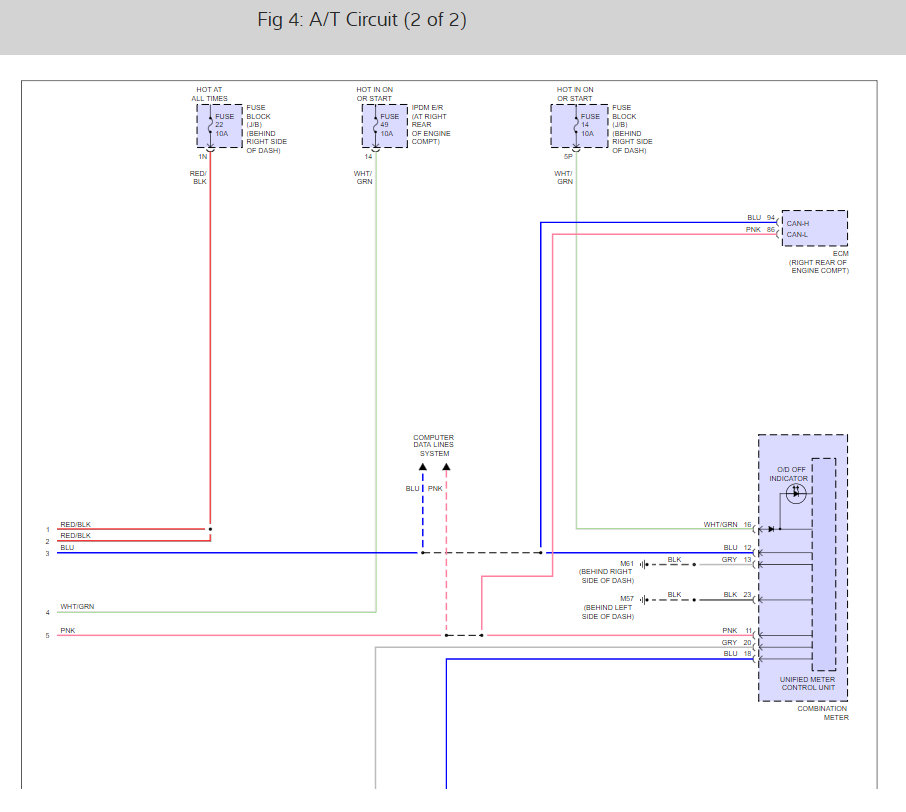

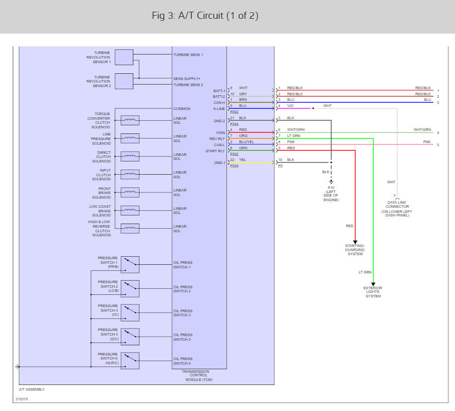

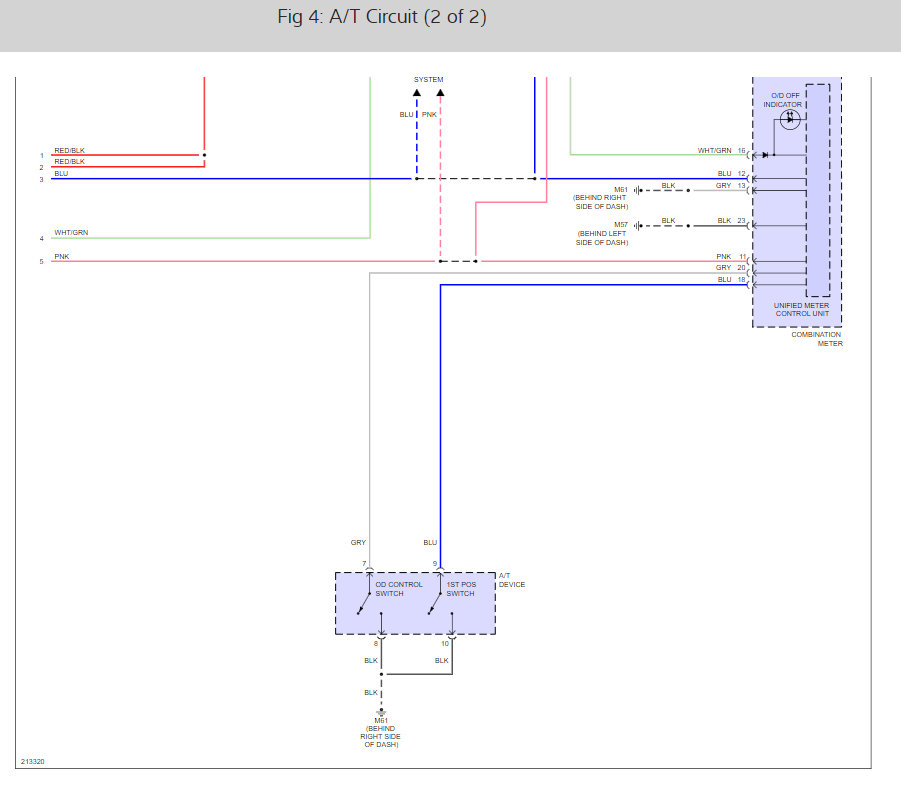

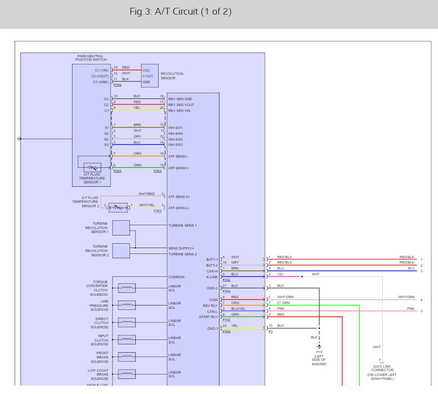

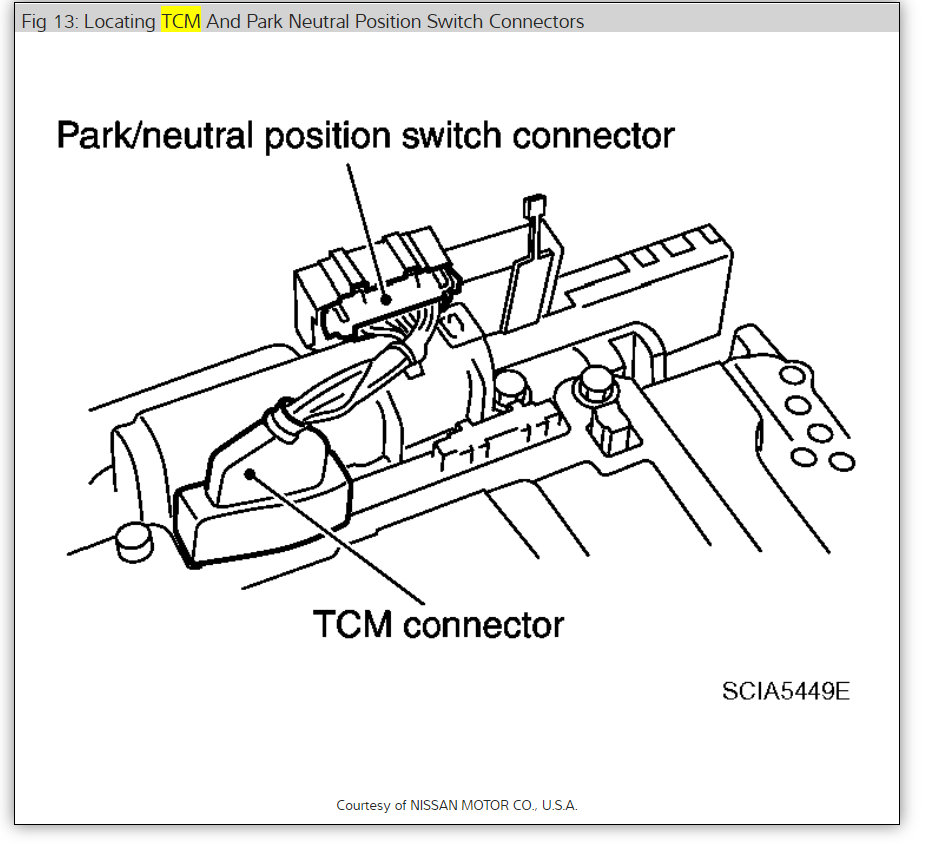

Next here is the transmission wiring diagrams so we can see how the system works. There is a transmission control module I would try removing the electrical connector and check for corrosion on the terminals here is the location of the module as well.
