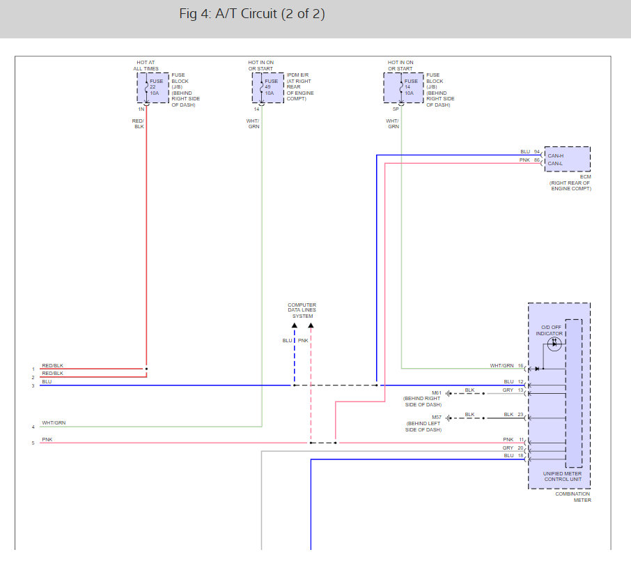

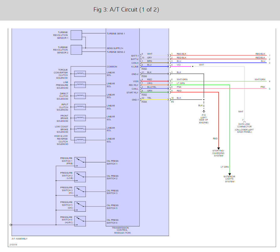

Usually my SUV works fine. Occasionally recently I have had episodes where after I start it, it would not engage in reverse. I found out after turning it off for a few minutes then back on it works perfectly fine all of a sudden. The most recent incident was this week and it would not engage in reverse, nor would it up shift past third gear. It is an automatic. I am having trouble believing it is the transmission as when it is functioning there is not any slippage or rough shifting. Scared though because I am a disabled vet and this is my families only transportation. Recently in August 2017 spent my life savings to bring my son and wife from the Philippines. I need this SUV to last a few more years to give me time to save. Horrified when I saw a $6,000.00 price tag online for a rebuilt transmission.

First, I want to thank you for your service, we sincerely appreciate you. :) Lets see whats going on here. The first thing we need to do is run the codes to see what comes up here is a guide to help us get started. You can get a coder reader for about $20.00 from Amazon.

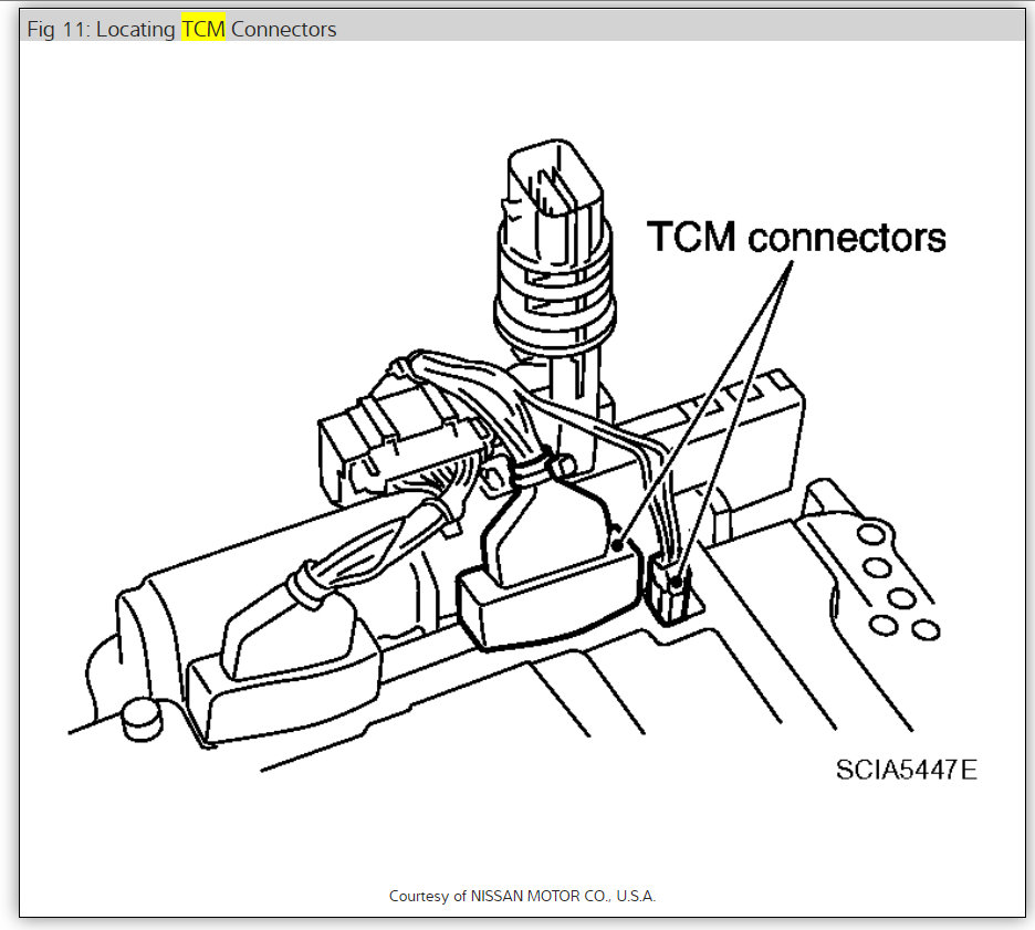

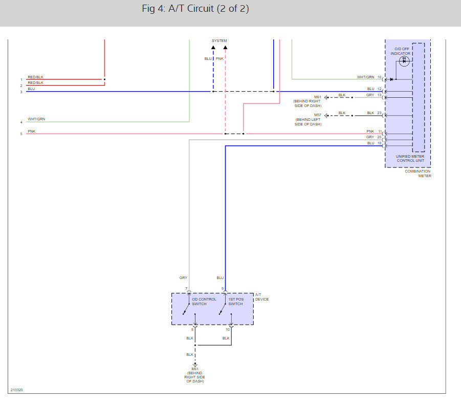

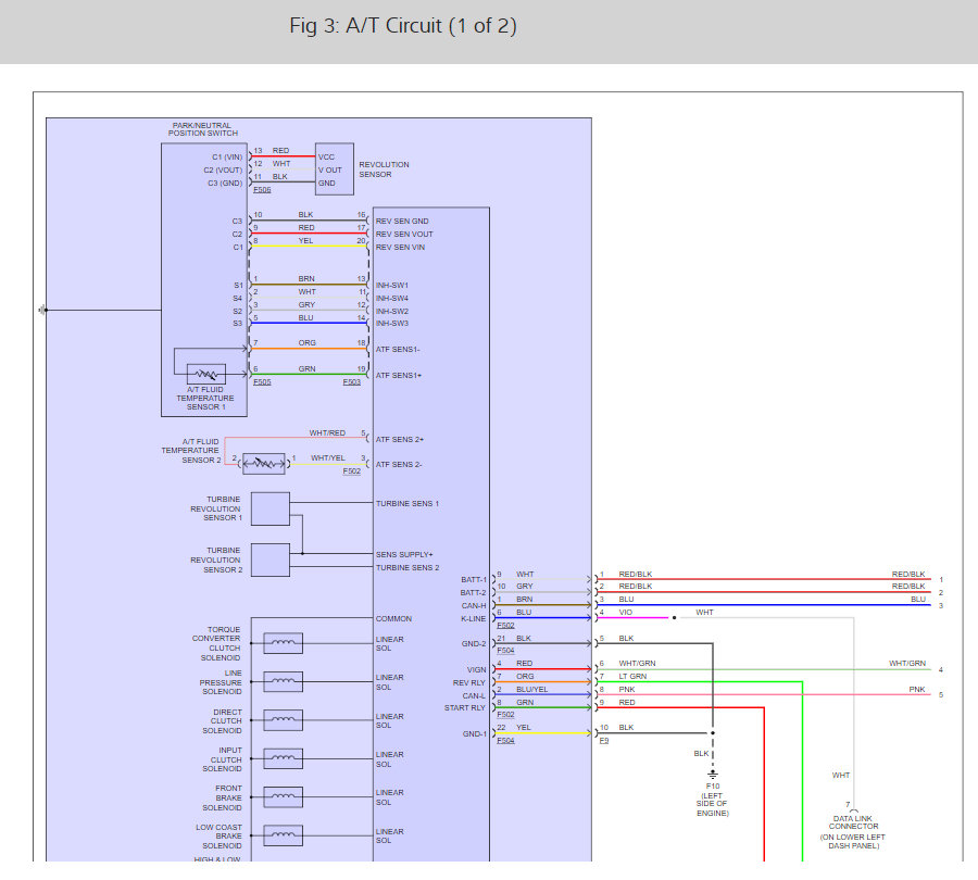

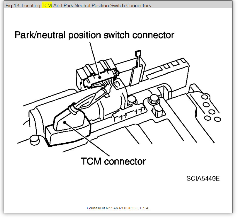

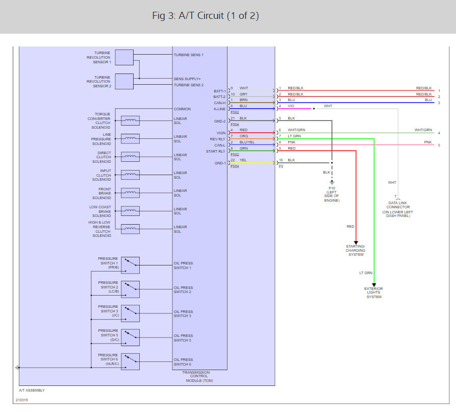

Next here is the transmission wiring diagrams so we can see how the system works. There is a transmission control module I would try removing the electrical connector and check for corrosion on the terminals here is the location of the module as well.
