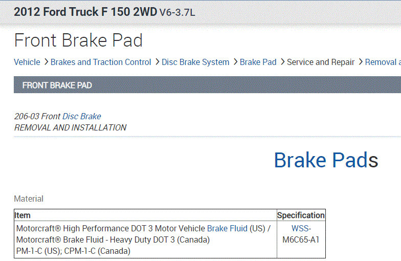

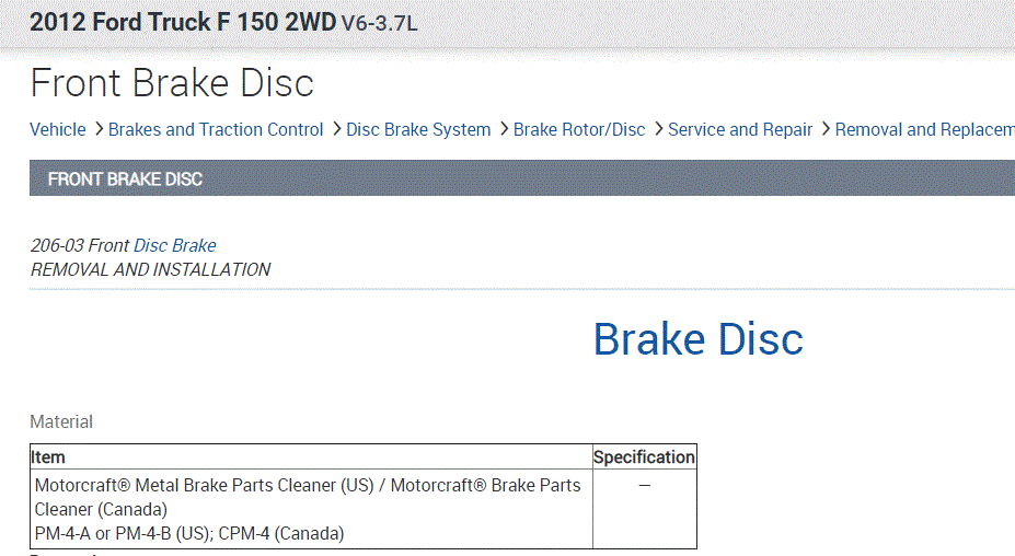

I am living in the Houston, my truck got flooded and it was not a deep water, and it is working good. drive it for forty miles sadly the brakes started to grind so I need new pads and rotors. Thanks
Feb 20, 2018 at 3:36 PM
  • 110,244 POSTS

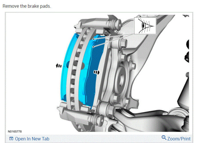

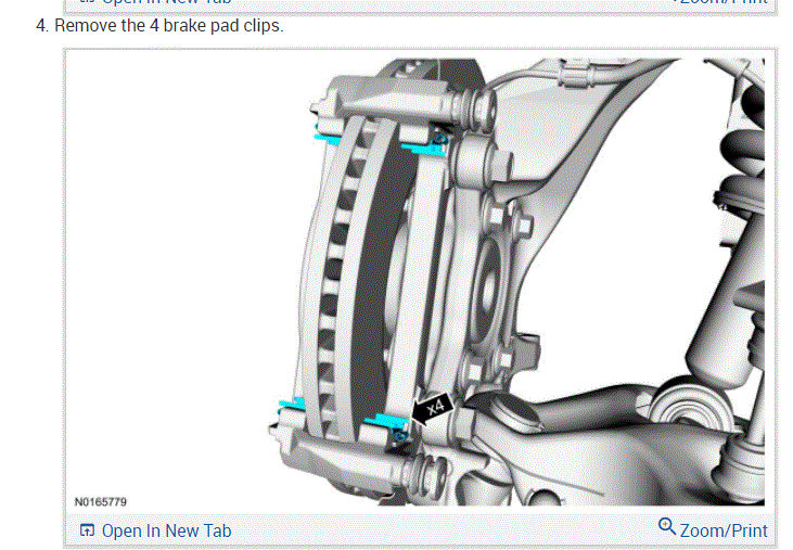

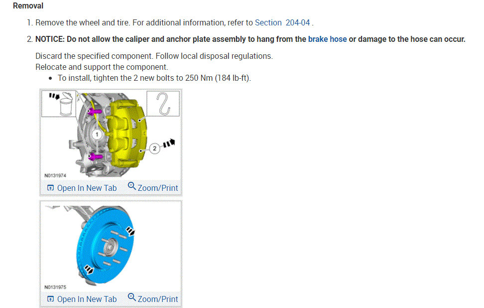

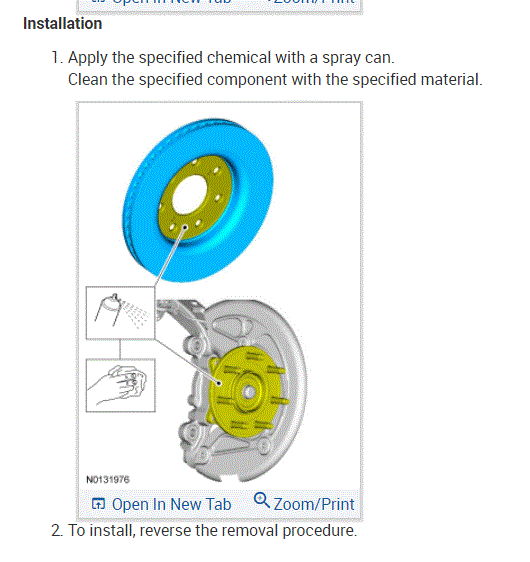

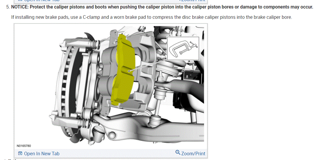

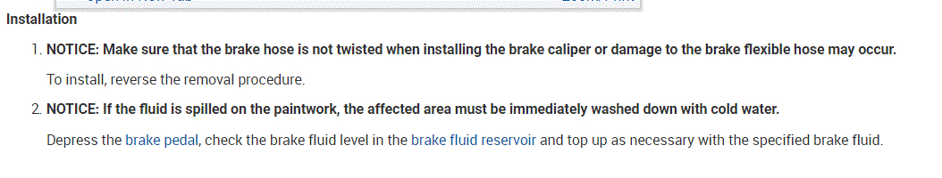

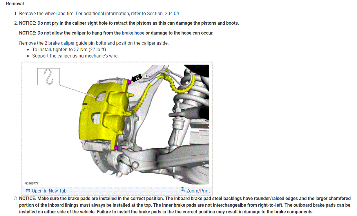

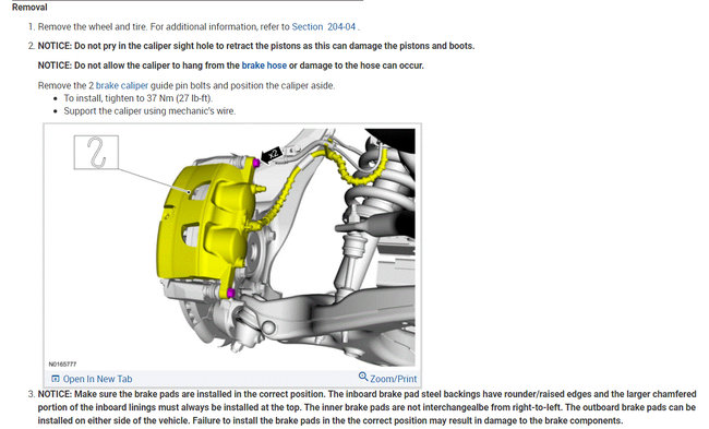

Replacing front brakes and rotors really isn't too hard of a job. You can expect them to last approx 25K miles, but that varies based on driving habits and terrain.
To get started, here is a link that shows in general how it is done. You can use this as a guide.
Here is a video showing it done on a slightly older F-150. However, the process is very similar.
https://youtu.be/Iv9mWLv9QLM
If you look at the attached pics, they provide the directions and pics specific to your vehicle.
See pics below
