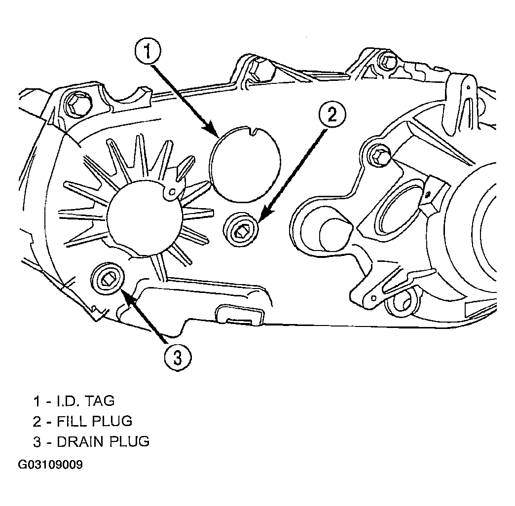

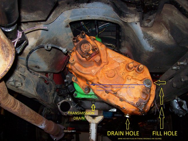

Your transfer case and differentials do not have dipsticks, you must remove a fill plug (if fluid runs out, it;s full!) if none runs out, you must top it off.
Your owners manual/ repair manual will tell you what type fluid goes in it.

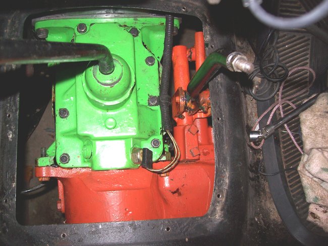

I'm gonna show you my JEEP CJ-5 Manual tranny and transfer case, your transfer case is similar BUT on the back of your automatic transmission
1) Manual Tranny Green / Transfer Case Orange INSTALLED IN MY JEEP ('hump' cover is removed)

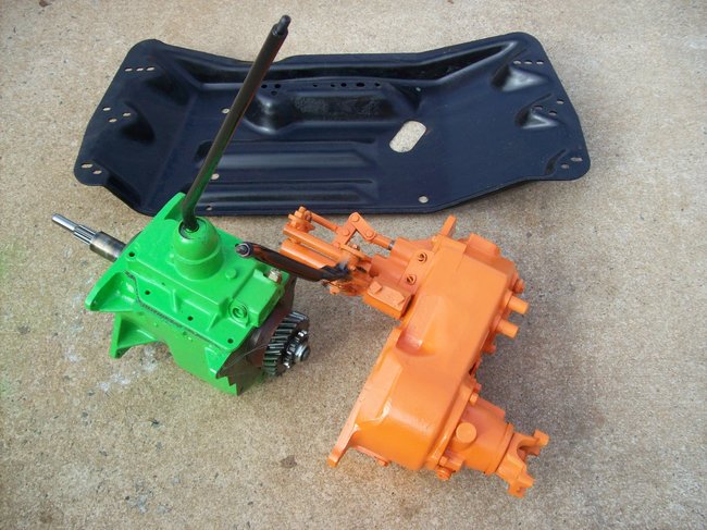

2) My tranny/ transfer case/ skid plate freshly rebuilt ready to install
3) Pic of rear of my transfer case (JEEP) See MY fill hole? (Hope you can see my writing)

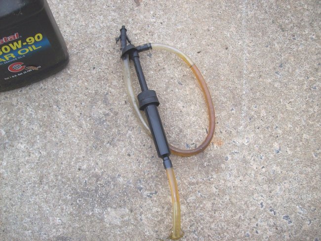

4) $5 pump from auto store to install "MY" kinda fluid from under Jeep

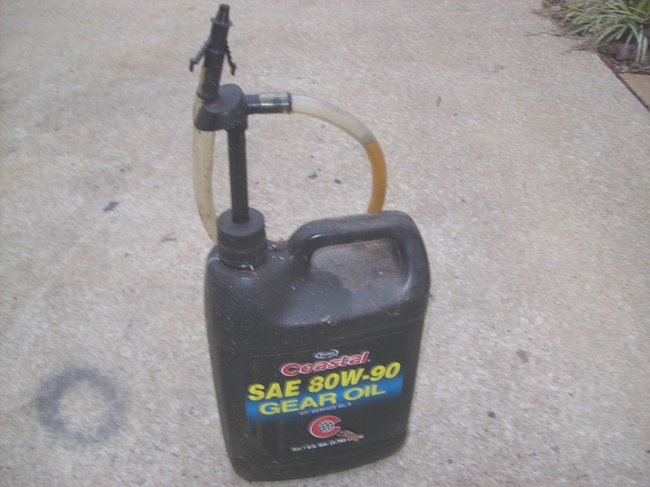

5) Pump mounted on my kinda gear oil jug
6) THIS IS A DIAGRAM I GOT FROM "PRODEMAND" OF YOUR TRANSFER CASE!

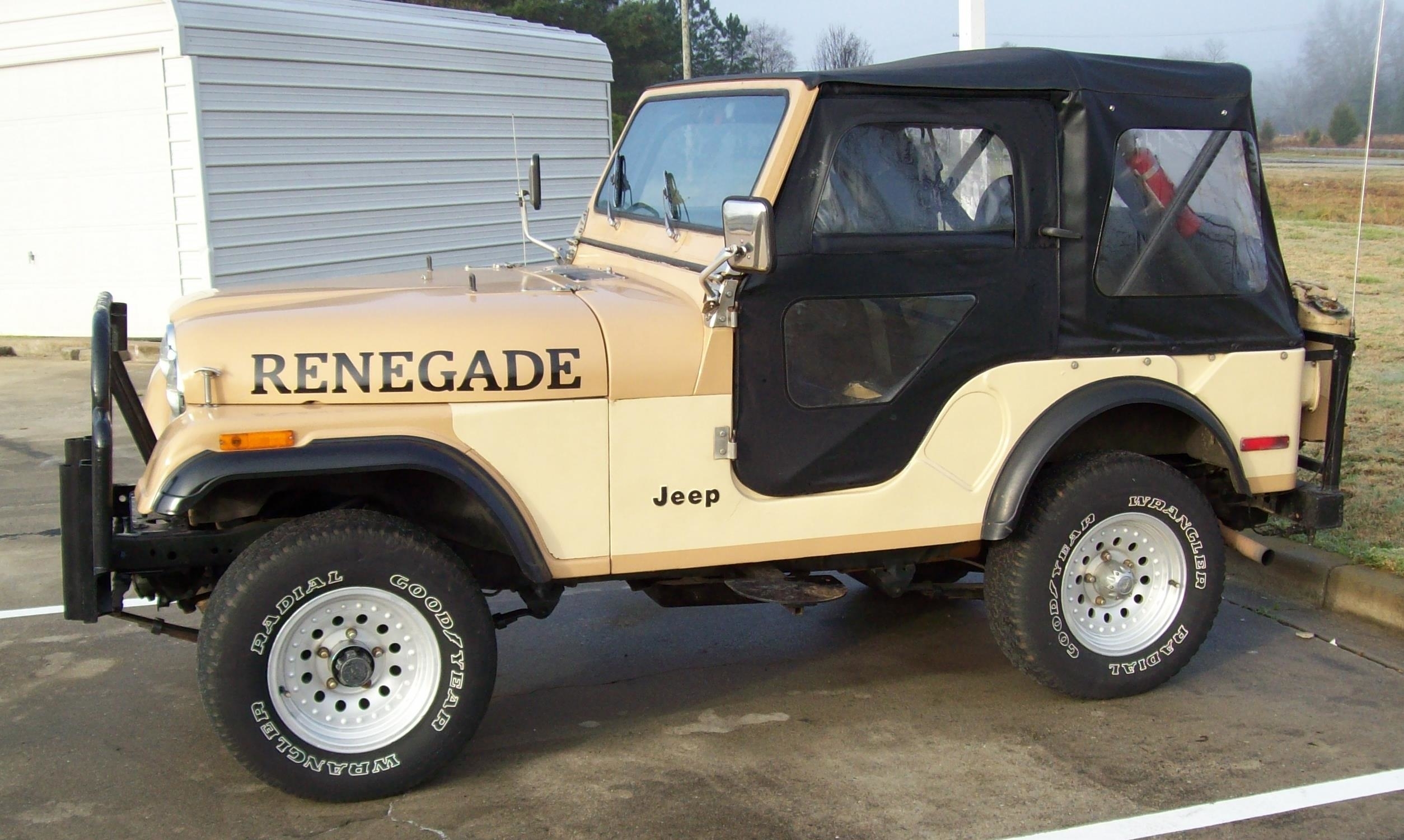

8) "Mr. Jeep" 1977 CJ-5 (39 years old)

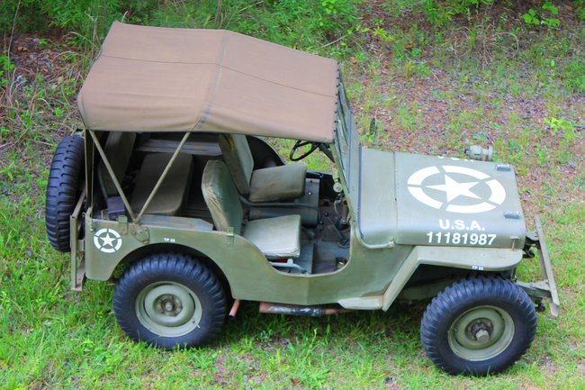

9) "Willy" 1946 Willys Jeep (70 years old)
I've pretty much rebuilt both of these, both obtained in 1991, since then, The 1st, is my everyday driver, the 2nd every chance I get!
