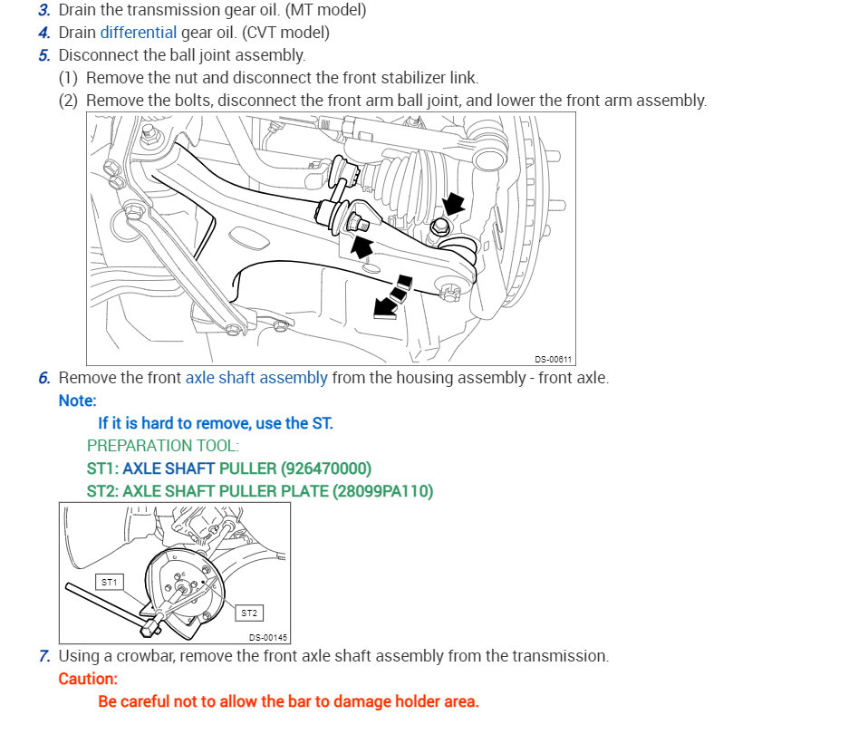

Few issues, not sure if they are related, but in order to by which started first
Slight knocking sound clearly coming from front right tire area, sounds related to cv joint. This started occurring when i turned sharp right (not all the time). Now it is still not all the time, but definitely more frequent and happens when i accelerate and turn right.

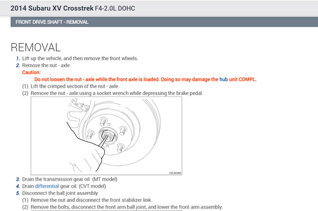

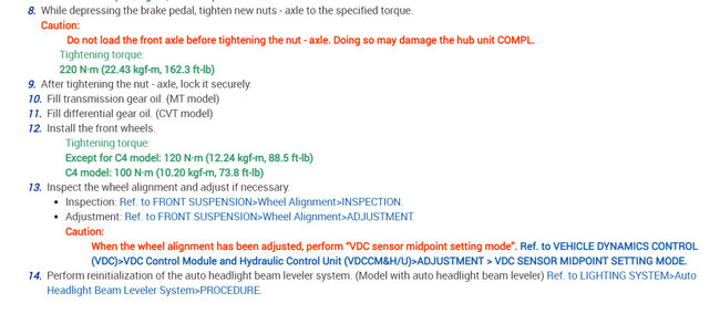

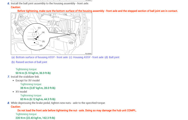

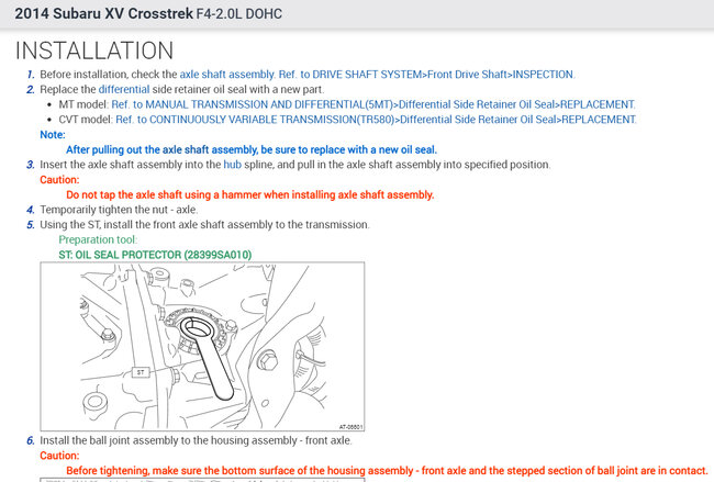

Please start a new question for the additional problems, one handle one problem per thread. It does sound like the CV axle is worn out. You can get a new axle from Amazon for $79.00.
Here is a link:
https://amzn.to/3Kwu6HC
Here are the instructions to change it out in the images below. Check out the images (below). Please let us know what happens.
