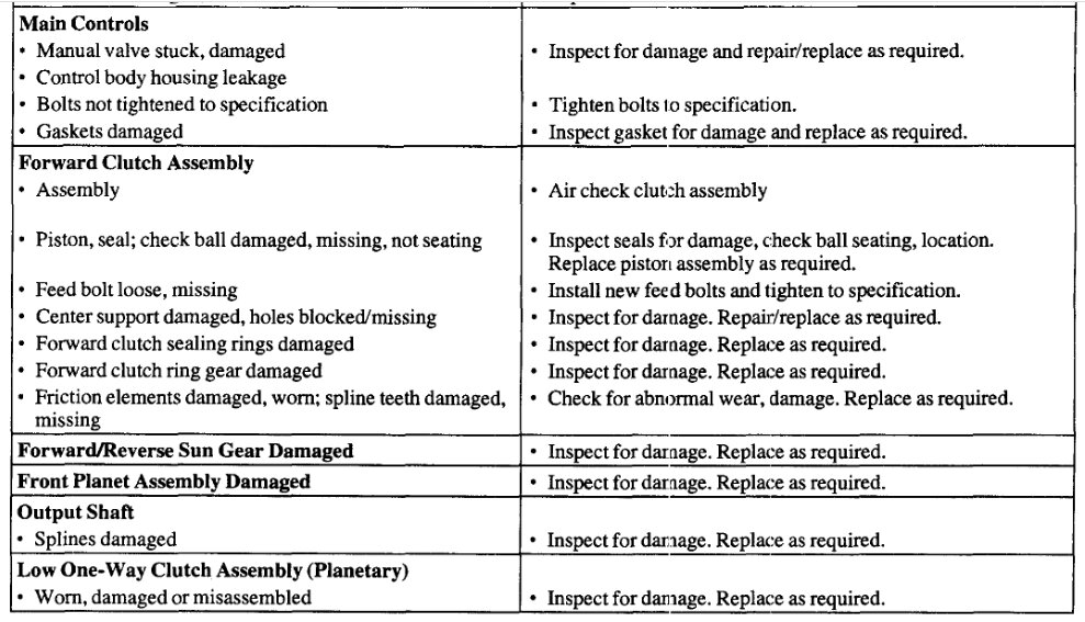

If you have no forward gears, the switch isn't the cause. I have a question. Does the gear indicator indicate the correct gear selection? There could be an issue with the transmission range sensor.

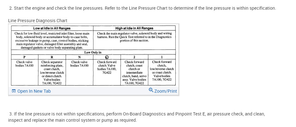

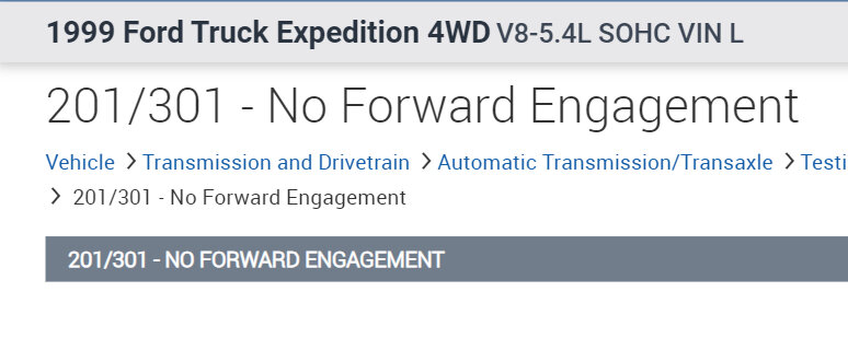

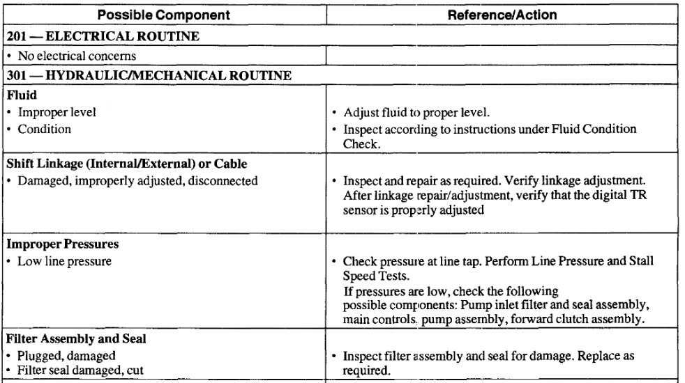

On the other hand, we may have lost transmission line pressure due to something such as a partially plugged transmission cooler.
What you described doesn't sound like the transmission itself has failed. It sounds like we lost the pressure needed to engage forward gears. Will it move forward if you put it in low 1 or first gear?

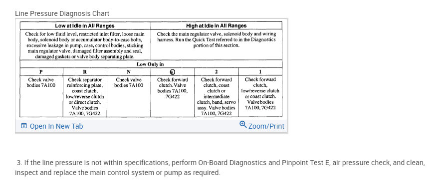

Let me know. Also, if you look at pics 1-3 below, it indicates possible causes of no forward gears. The remaining pictures are the directions for testing line pressure. Let me know if that is something you are comfortable doing.

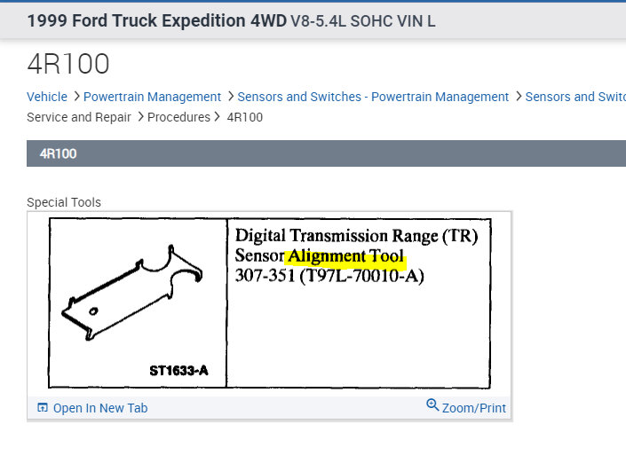

* The gear indicator does indicate the correct gear. I checked the linkage under the steering column and that was a little loose, so I tightened it. I don't know what to check underneath the vehicle, and I don't know what it means to "verify the TR sensor is properly adjusted".
*No, it will not move forward in low1 or first gear (nor in low or high 4wd).

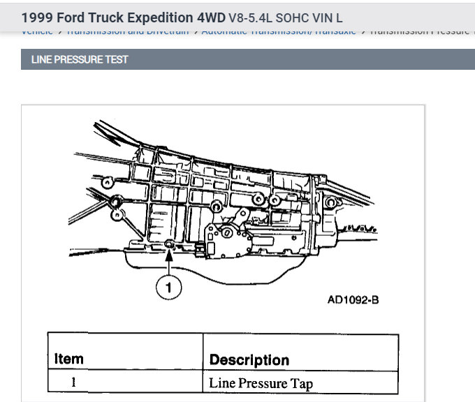

As far as testing the line for pressure, I am not opposed to trying it but I might need some hand holding or a YouTube video to watch how to do that. Is the tap for the line on the outside of the bellhousing or do I have to get up in there to access the line and the filters? Also, what kind of pressure gauge do I need, and can i borrow one from O'Reilly's or Auto Zone?

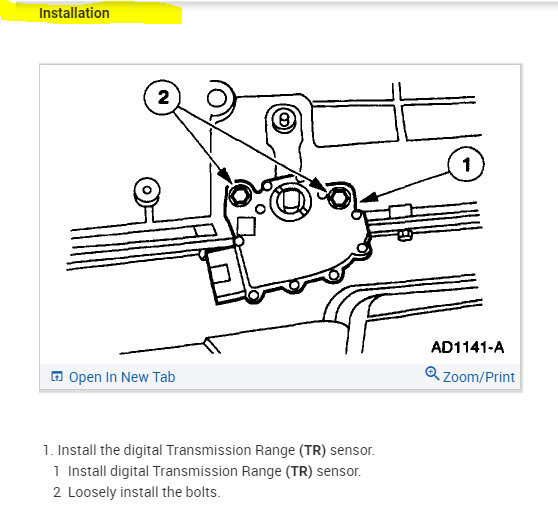

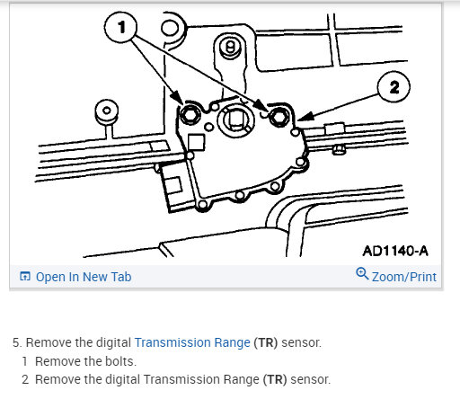

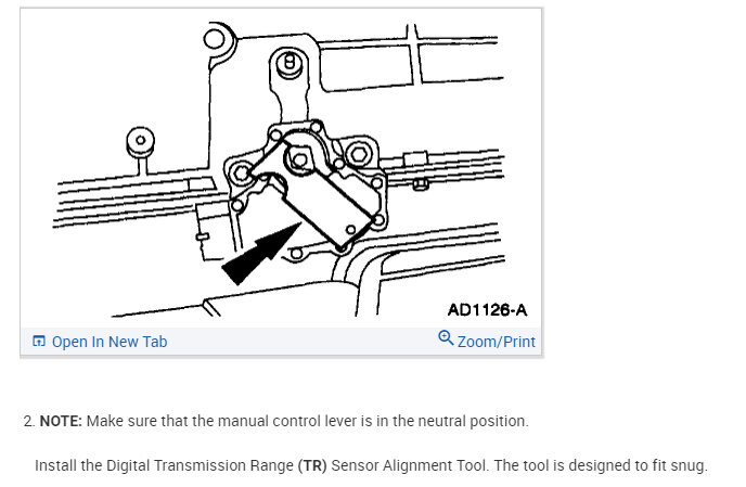

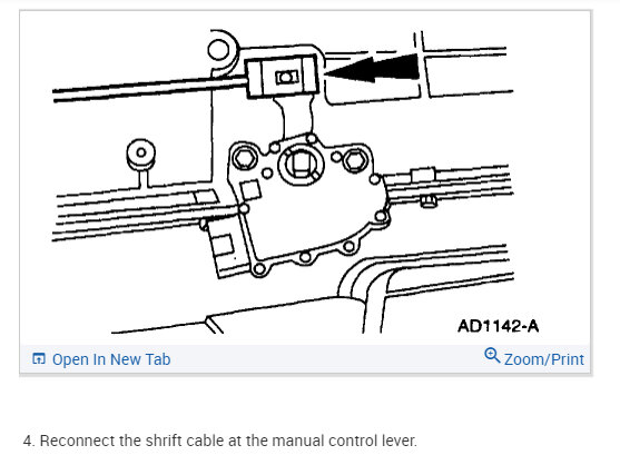

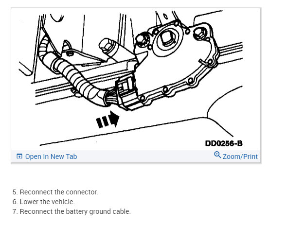

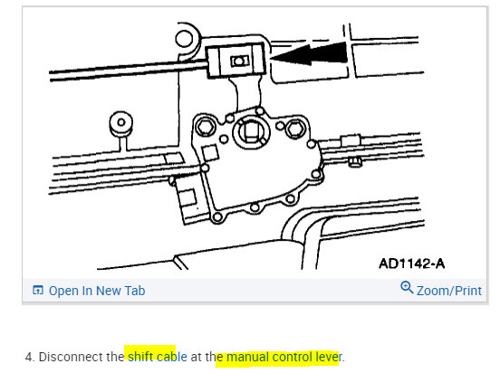

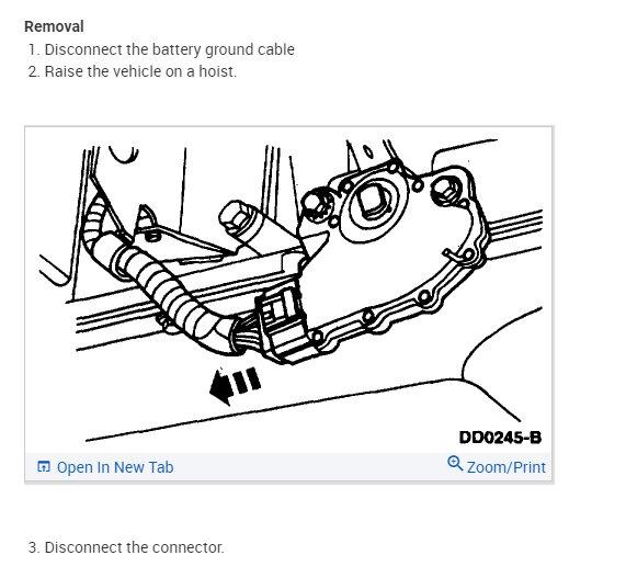

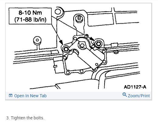

For now, skip the pressure testing. If you are not seeing the gear indicator light up, there is likely an issue with the transmission range sensor.
The first thing to do is confirm there are no issues with the wiring and connector. The TR sensor is located on the side of the transmission and a manual shift cable attaches to it.
I attached the directions below for replacing it so you can see the steps for adjustment (if needed). Adjustment does require a specialized tool. However, if there is no light indicator, we need to confirm the wiring is okay.

Sorry it's been a while since I've had time to email... Okay, I did get under my Expedition and checked the alignment of the Transmission Range Sensor. In neutral, it was a little bit off, so I adjusted it a little in order to line up the two marks. Also, I re-attached the "overdrive" button that had broken off the end of the gear shifter (why would somebody put it right there at the end of the shifter?? duh!). So now that indicator light turns on/off when the o/d button is pushed.
Started up the truck, shifted. Still, the only gear that moved the wheels was reversed. No check engine light coming on. Are there other things I could check-out? Sensors that affect the TCM? Is there a way to re-set the Transmission Control Modulator? I've seen a couple of different ways to do it online, but none of them have worked on my vehicle.

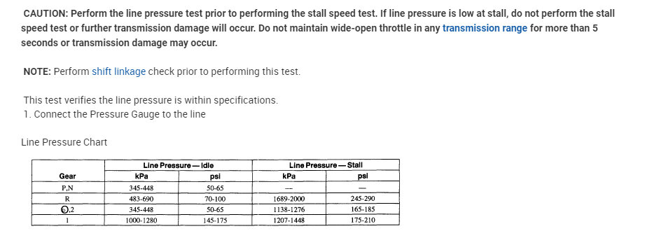

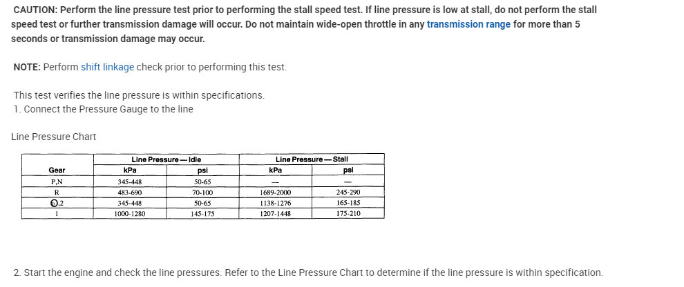

It would be a good time to check the line pressure. If it is low, that would cause this as well.
If you look below, I attached the directions and specifications for testing transmission line pressure. Take a look through them and let me know if you are comfortable performing them.
