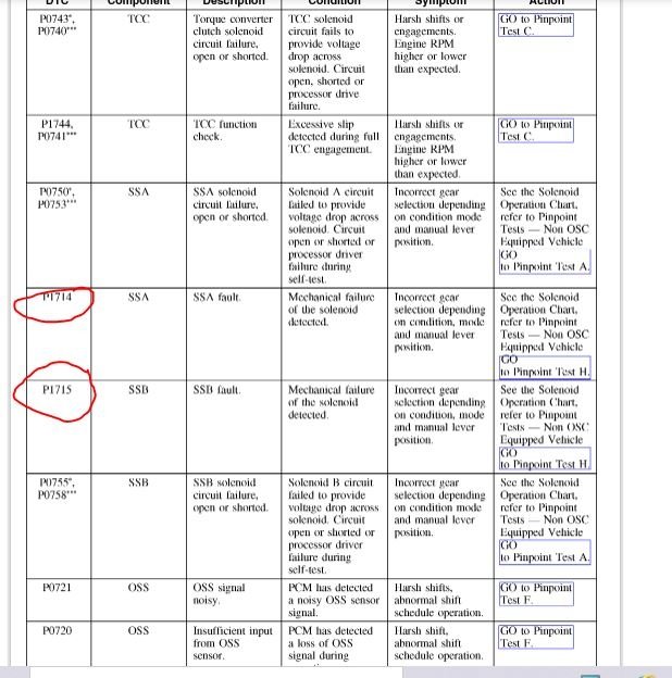

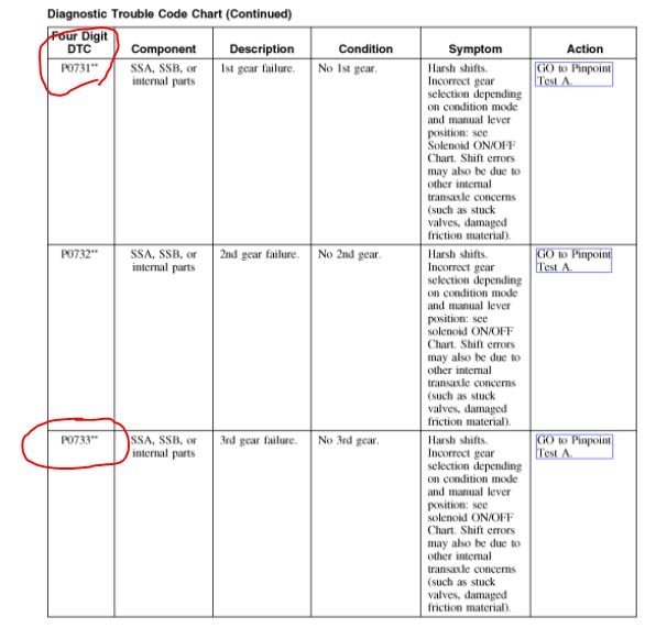

these are the codes it's throwing:
P0731
P21696
P1714
P17515
P0732
P1000
It started with going into limp mode only had 3rd gear did a fluid flush and refill and then lost all gears. Engine is a V6.

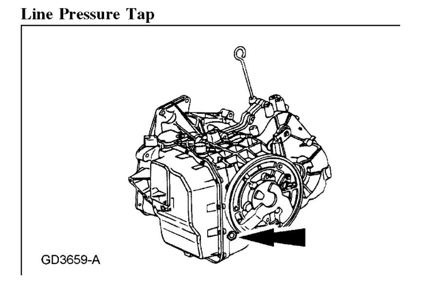

I attached the procedure for testing the line pressure to verify the actual pressures.
I also attached the possibilities for the codes. There is no 21696 code at all. Can you double-check that?

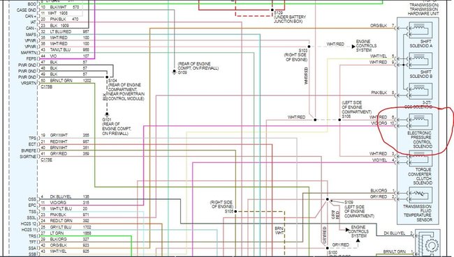

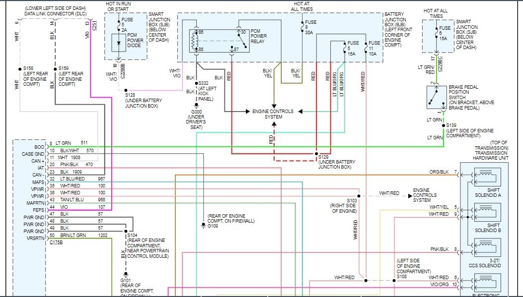

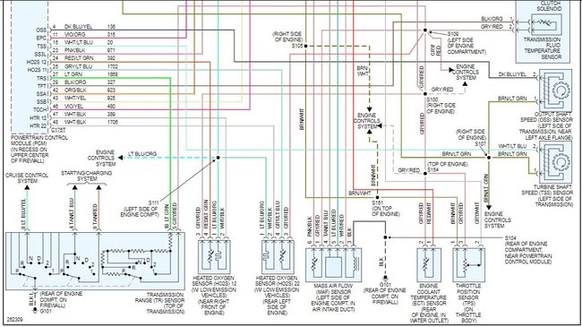

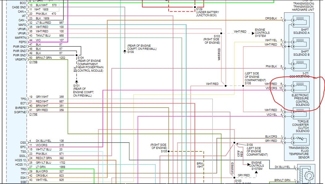

This could be a solenoid issue but needs to be confirmed. You will need an advanced scan tool that can activate the solenoids to verify they are functioning correctly. I attached a wiring diagram as well for you of the transmission.

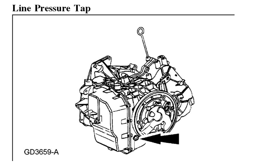

Line Pressure Test
CAUTION: Carry out Line Pressure Test before carrying out Stall Speed Test. If line pressure is low at stall, do not carry out stall test or further transaxle damage can occur. Do not maintain WOT in any gear range for more than 5 seconds.
CAUTION: The Transmission Tester must be removed from the transaxle and the vehicle harness connected to verify these pressures.
The Line Pressure Test verifies that the line pressure is within specifications.
1. Connect pressure gauge to line pressure tap.
Line Pressure Tap
2. Start engine and check line pressures. Refer to following the Line Pressure Chart to determine if line pressure is within specifications.
3. If line pressure is not within specifications, carry out on-board diagnostics and pinpoint test, air pressure check and repair main control system or pump as required.

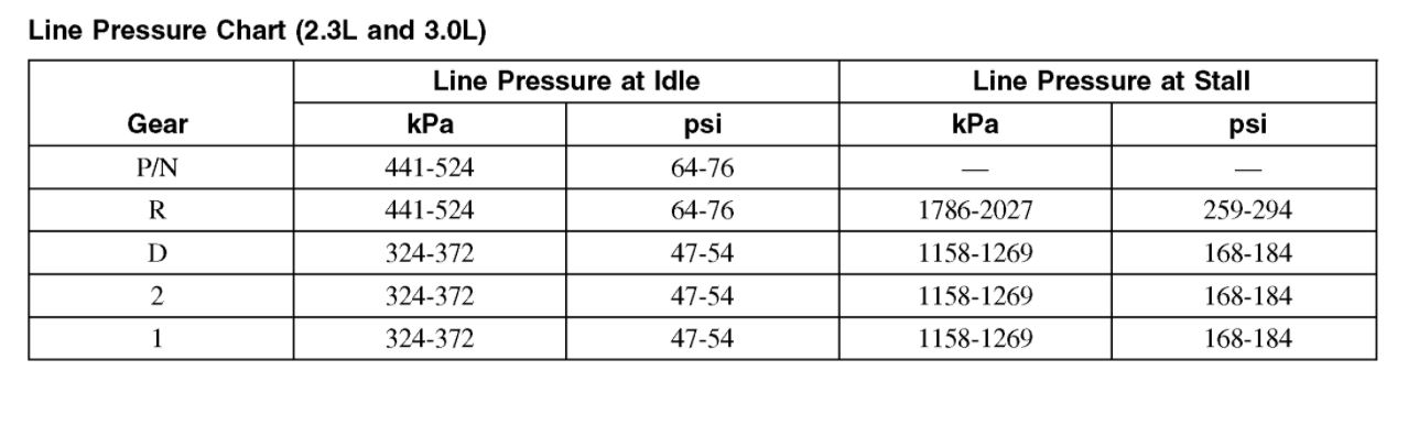

Line Pressure Chart (2.3L and 3.0L)
Line Pressure Diagnosis
If the line pressure is low at idle in all ranges check the following items:
^ Low fluid level
^ Restricted inlet filter
^ Loose main body
^ Solenoid body or accumulator body to case bolts
^ Excessive leakage in pump
^ Case
^ Control bodies
^ Sticking main regulator valve or damaged inlet tube seal on inlet filter
^ Damaged gaskets or separator plate

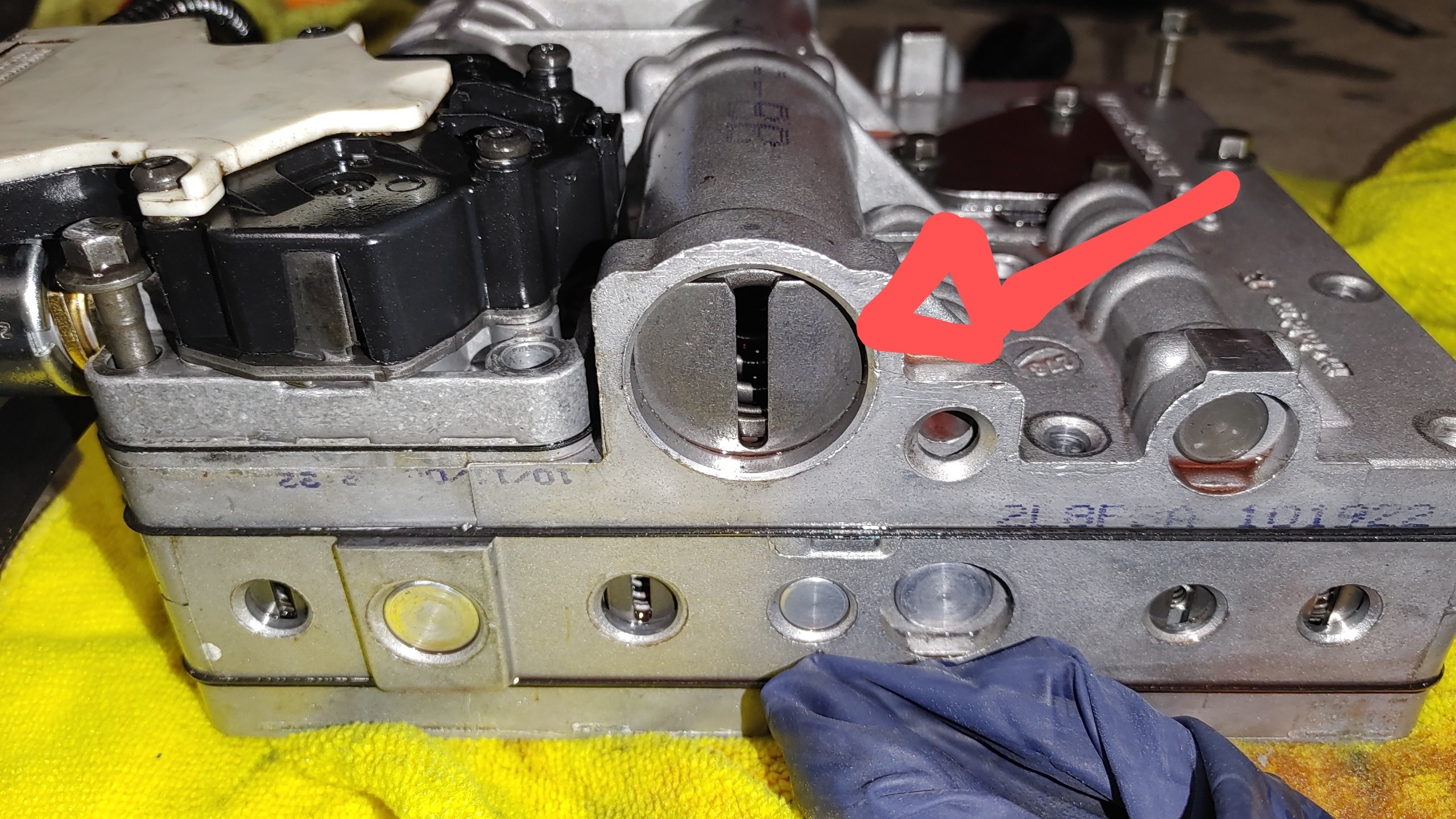

I decided to pull the valve body out to see if I could visibly see any blockage I'm not a transmission guy so this is relatively new to me should the springs be loose and bouncing around inside the valve body?
Also the solenoid on the face of the body plastic is loose don't know if that matters much .
I've attached a picture where the spring is loose and bouncing back and forth if you move it marked by the red arrow.
Mar 29, 2021 at 1:51 AM
I would remove that and make sure it is not broken.
The first thing you should have done is the pressure test to see if the front pump is working.
Mar 29, 2021 at 2:13 AM
MERCURYESCAPé
  • 13 POSTS
So I take it a loose spring is a bad thing.
Mar 29, 2021 at 9:45 AM
There should be some tension there.

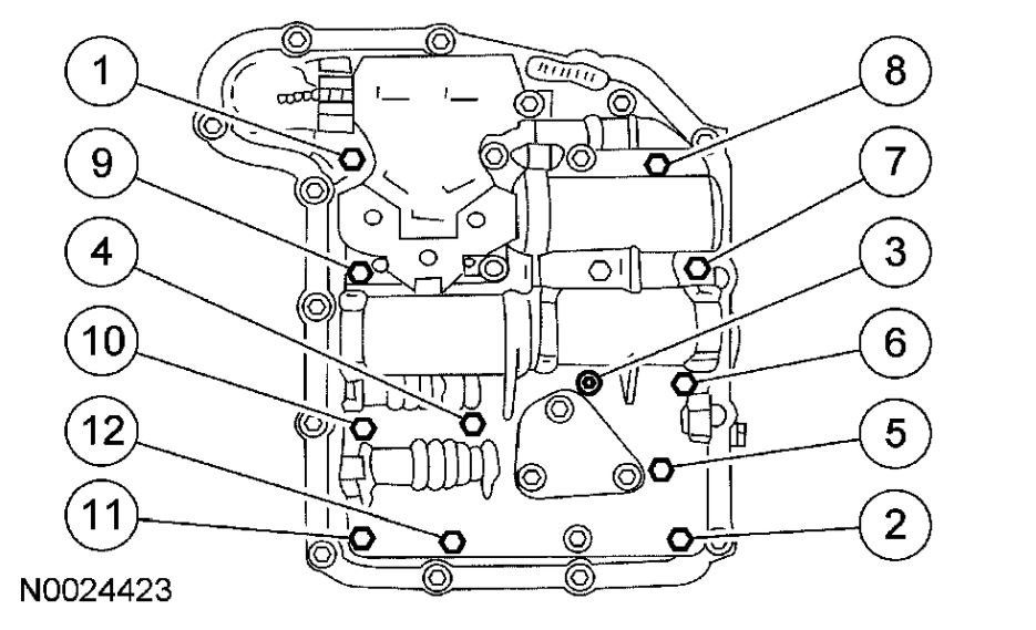

I posted the torque below for you for the valve body.
. Install the main control valve body assembly. Tighten the bolts in the sequence indicated.
^ Tighten to 10 Nm (89 inch lbs.).
I also attached the bolt tightening sequence for the valve body as well.

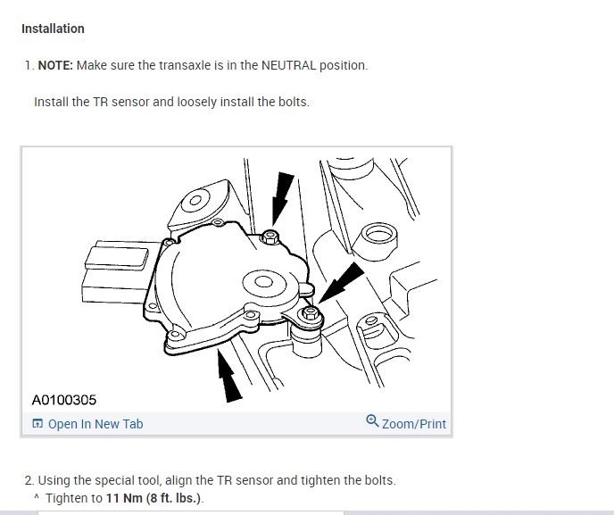

Well, this is frustrating. Not sure where I went wrong here but replaced the valve body torqued it to spec and in correct sequence hooked it up put everything back together and it won't even try to start the relays click but no crank. Any ideas?
Mar 31, 2021 at 6:13 AM

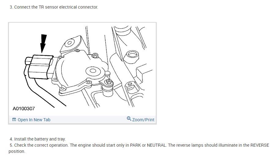

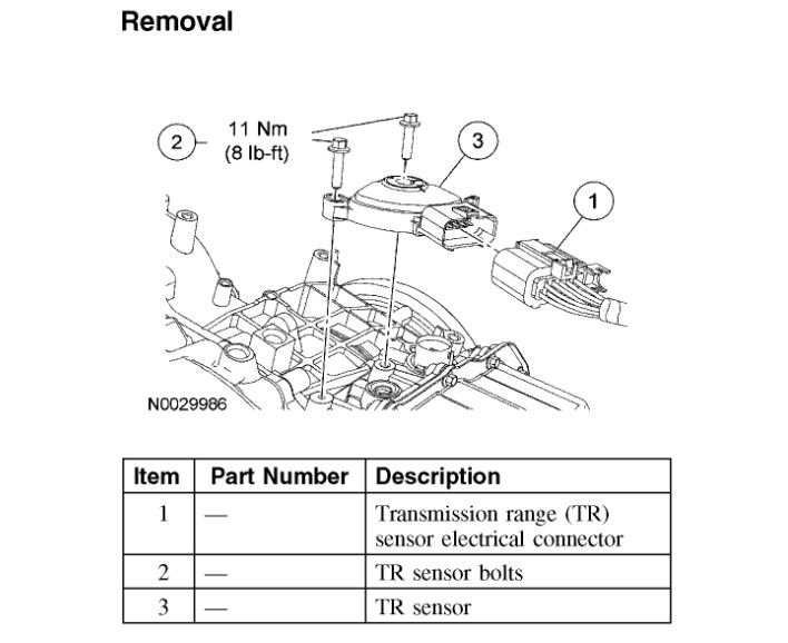

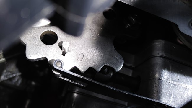

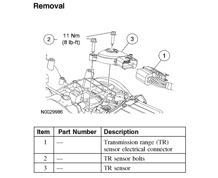

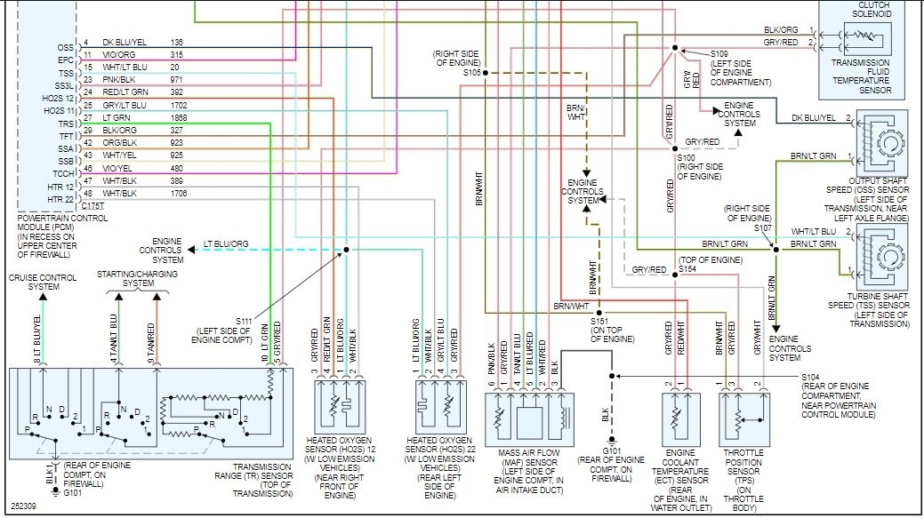

Okay, I attached a wiring diagram of the starting system for you to view.

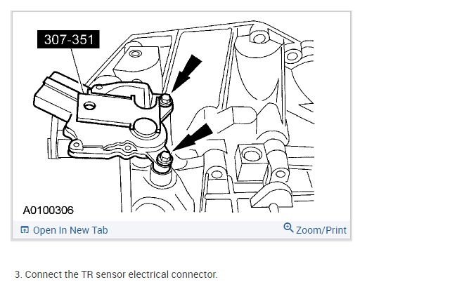

Make sure the range sensor on top of the transmission is tight and the connector is all the way in. This would be the only connection with the starting system from this repair. I attached some pictures for you below.
Mar 31, 2021 at 6:27 AM
MERCURYESCAPé
  • 13 POSTS
Is this in drive or neutral the pictures? I've looked at it's hard to tell.
Mar 31, 2021 at 2:00 PM
I cannot tell from that picture. Have someone in the car with their foot on the brake and start it and run through the gears. Then you can be sure what gear it is in.

Okay so did the test .
Idle. Stall
P/n. 60-75. 0-60
R. 60-75. 120-150
D. 30-90. 0-30
2. 30-50. 0-20
1. 30-50. 0+
Apr 22, 2021 at 11:24 AM
As you can see, the drive is too low. It is under half of what it should be.
Looks to be an internal failure. You will need to replace it with either a rebuilt unit or a used unit.
