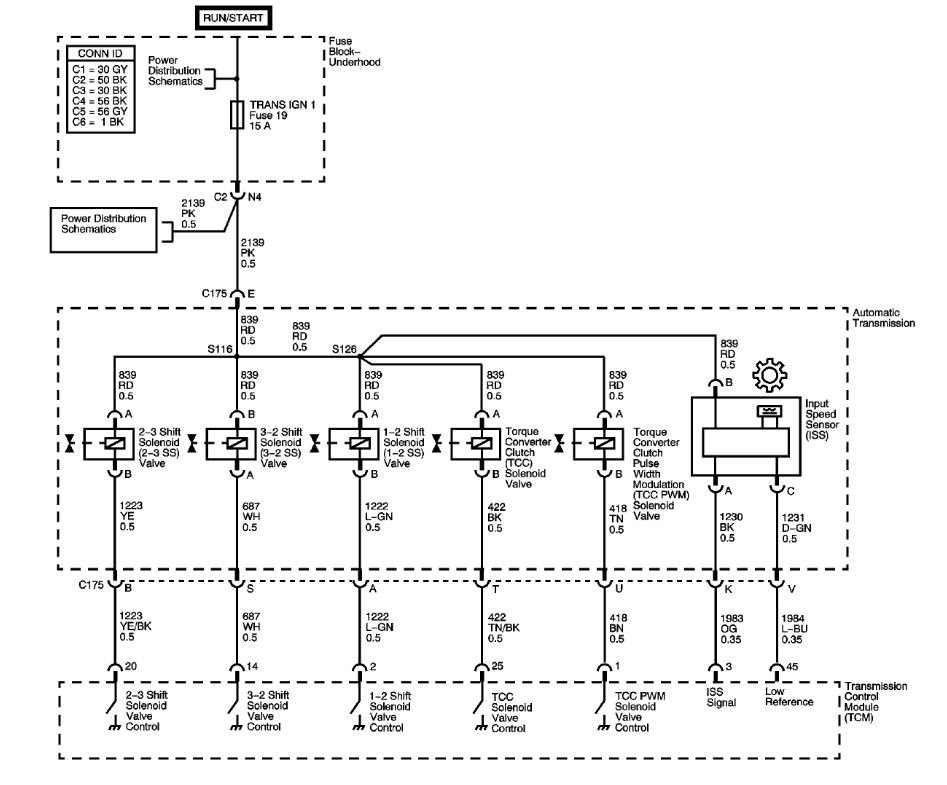

My transmission lost all gears besides second. I pulled it had it rebuilt by a very reputable mechanic who specializes in transmission repair. I put the transmission back in and drove it a total of seven miles before I lost all gears. the engine just revs but the vehicle will not move. It threw 2 DTC's p0700 and p0717 (input turbine speed sensor low reference). The SUV is an LT model with a generation 3 4l60-E. Should I be focused on the transmission or the TCM?

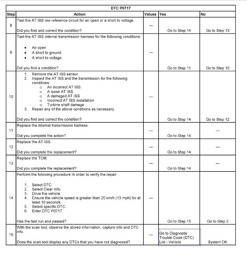

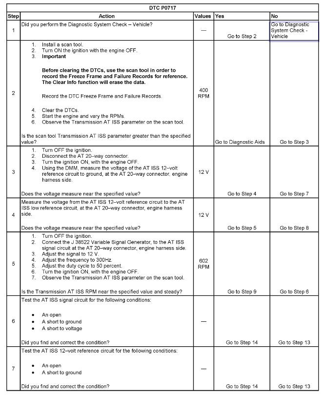

I would concentrate on transmission and wiring issues. The PO700 is just the TCM signaling the check engine light to come on. The 717 shouldn't cause a loss of all gears. I would troubleshoot that code following the information below and also check for voltage on the pink wire at the transmission, this powers the solenoids.

The automatic transmission input shaft speed (AT ISS) sensor assembly is a three-wire hall-effect sensor that is mounted internally to the transmission on the oil pump assembly. The AT ISS utilizes the gear teeth, located on the turbine shaft, to generate a voltage signal of varying frequency that corresponds to the rotational speed of the turbine shaft. The AT ISS signal is an input to the transmission control module (TCM) and is used to determine line pressure, transmission shift patterns, torque converter clutch (TCC) slip speed and gear ratio.
If the TCM detects AT ISS input less than 100 RPM with the engine running, DTC P0717 sets. DTC P0717 is a type B DTC.

^ Inspect the connectors at the TCM, the AT ISS, and all other circuit connecting points for an intermittent condition. Refer to Testing for Intermittent Conditions and Poor Connections. See: Vehicle > Component Tests and General Diagnostics
^ Inspect the circuit wiring for an intermittent condition. Refer to Testing for Electrical Intermittents. See: Vehicle > Component Tests and General Diagnostics
^ Road test the vehicle while monitoring the Transmission ISS parameter on the scan tool. The Transmission ISS parameter should vary with engine speed changes and not abruptly drop out.
^ Inspect for an open or shorted AT ISS wire.
^ Inspect for a disconnected AT ISS connector.
^ Inspect for a faulty AT ISS.

Doing these test procedures considering the transmission just had an overhaul this will tell me weather the TCM or at ISS is bad and or wiring. Would the TCM or short in the wiring cause my suburban to act like its in neutral? Does a fault in the transfer case cause DTC and symptoms that are similar? I only ask due to the symptoms it had before the trans. Went out. At varying speeds a grinding noise would happen periodically followed by a clunk and a slight pull or torque feeling throughout the vehicle then it was fine but would repeat several times while driving at all speeds.
Apr 24, 2019 at 11:39 AM
KENW1
  • 213 POSTS
Thanks for the additional information. It's possible the chain has popped in the transfer case, place the truck in park and see if you can push it.
