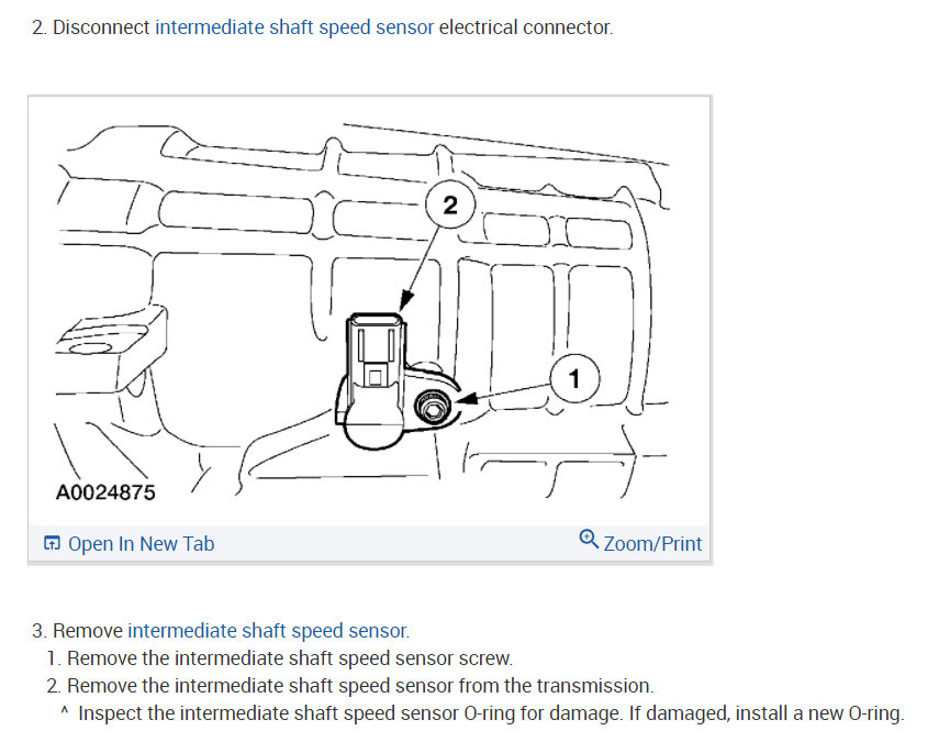

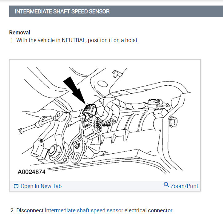

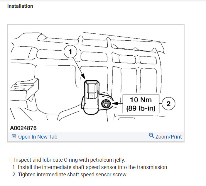

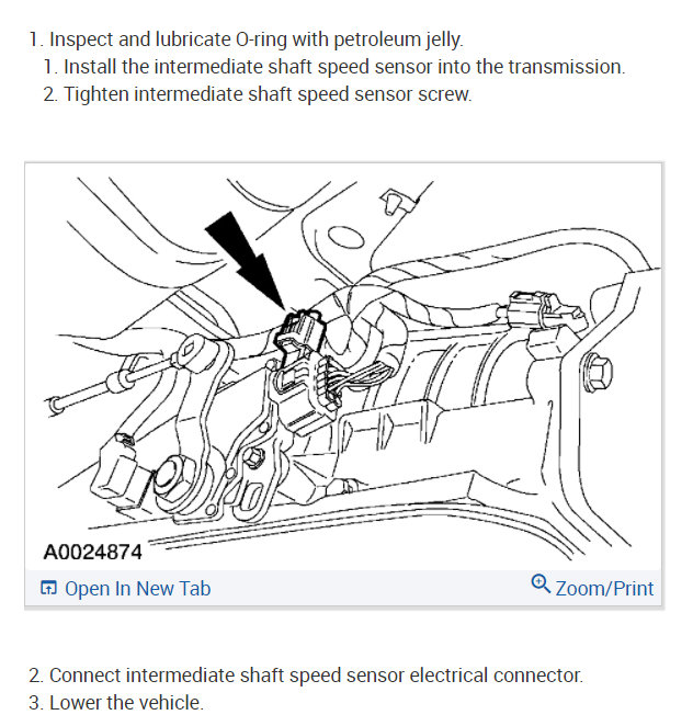

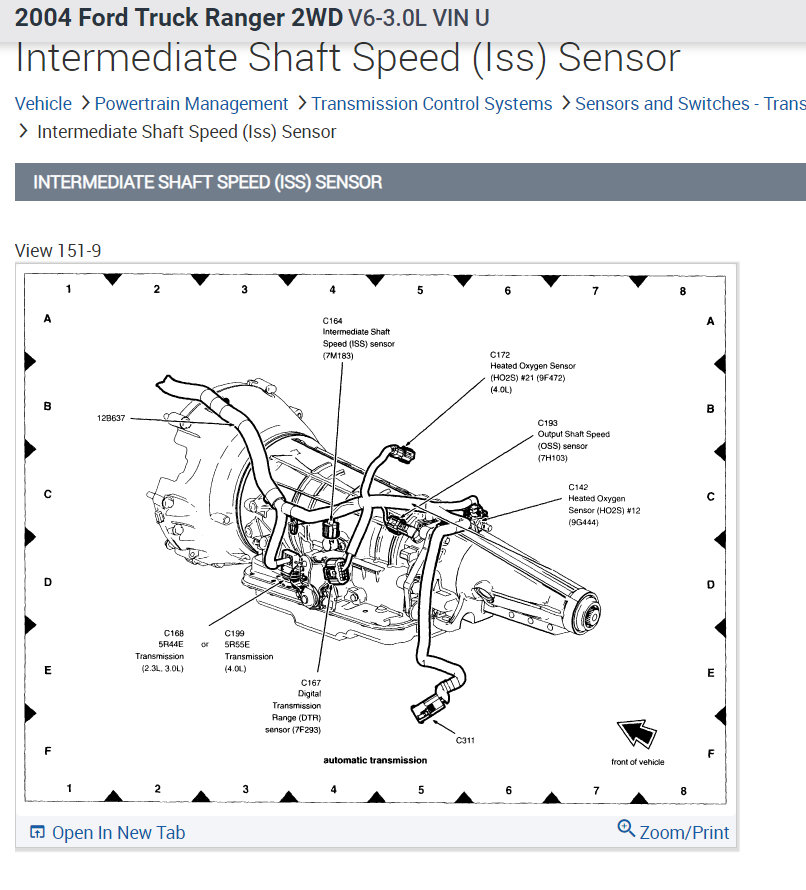

Good morning,
it sounds like it could be the intermediate speed sensor when they go bad they may or may not leave a code. Here is the location and replacement instruction in the diagrams below.
and
Check out the diagrams (Below). Please let us know what you find.
