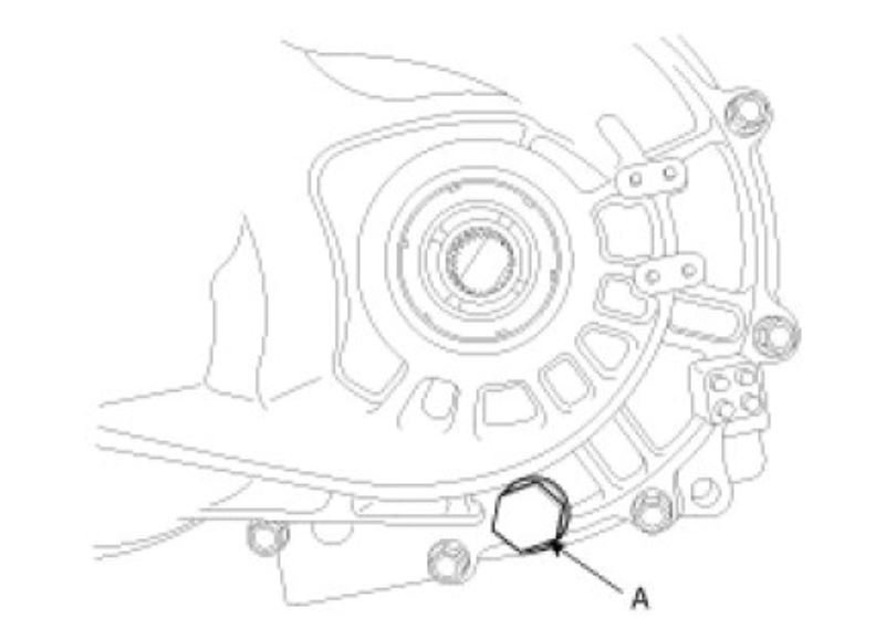

Hi,i was wondering where is the drain hole for transmission oil in my car hatchback. Please let me know how to do change of transmission oil correctly. Thanks

Good morning,
I attached a picture of the drain plug for draining the fluid.
It takes two quarts to refill the system.
