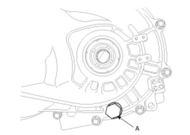

Hi,i was wondering where is the drain hole for transmission oil in my car hatchback. Please let me know how to do change of transmission oil correctly. Thanks
Jul 10, 2019 at 4:57 AM
Good morning,
I attached a picture of the drain plug for draining the fluid.
It takes two quarts to refill the system.
