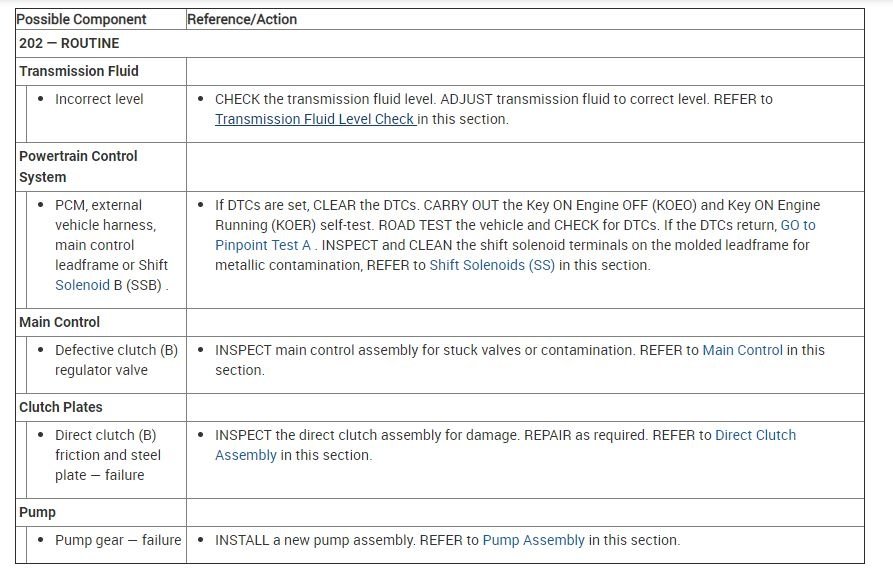

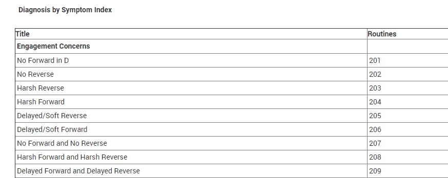

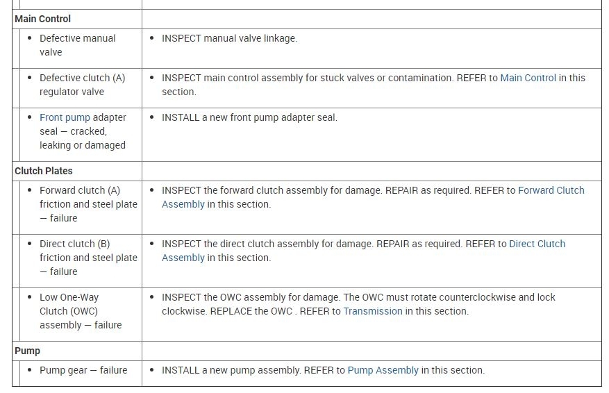

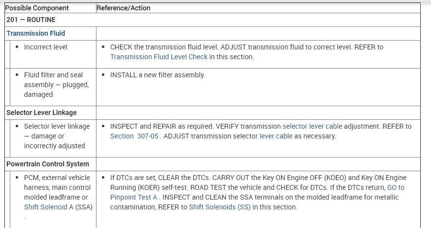

Good afternoon,
If you changed the fluid and filter and the transmission will not engage, then either the front pump or the torque converter has failed internally.
Did you have this issue prior to changing the fluid?
Did you try changing from 2 to 4 wheel drive to be the transfer case is good?
I attached possibilities for you below.

You would need to do a mainline pressure test to look for output from the pump. I attached a procedure for you to determine if the front pump has failed.
You will need an advanced scan tool to read and perform this procedure. Otherwise, you would need a shop to check it for you.
A no-drive condition can exist with correct transmission fluid pressure because of inoperative clutches. Refer to the Clutch Application Chart to determine the appropriate elements. A clutch concern can be located through a series of checks by substituting air pressure for fluid pressure to determine the location of the concern.
Example: When the selector lever is in a forward gear range, a no-drive condition may be caused by an inoperative clutch.
