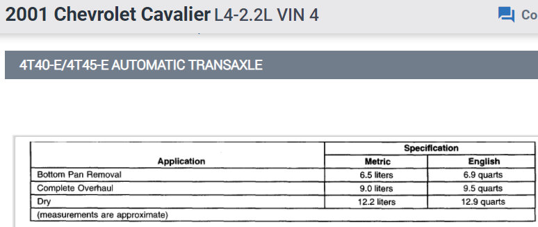

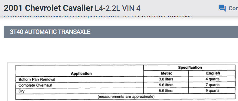

How many quarts of transmission fluid when changing fluid and filter? Book says four quarts.

I've attached 2 pictures below of the transmission capacities you've requested. One is for a 3 speed automatic and the second is for a 4 speed automatic. I've attached both below. Both use DEXRON- III type transmission fluid. Hope this helps and thanks for using 2CarPros.
