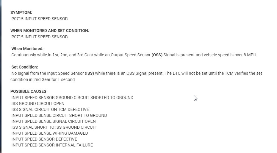

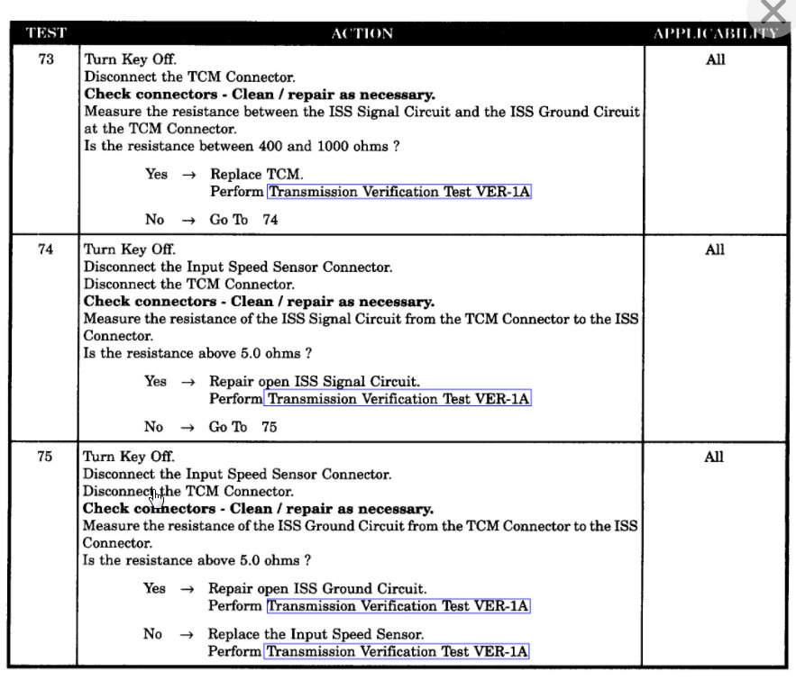

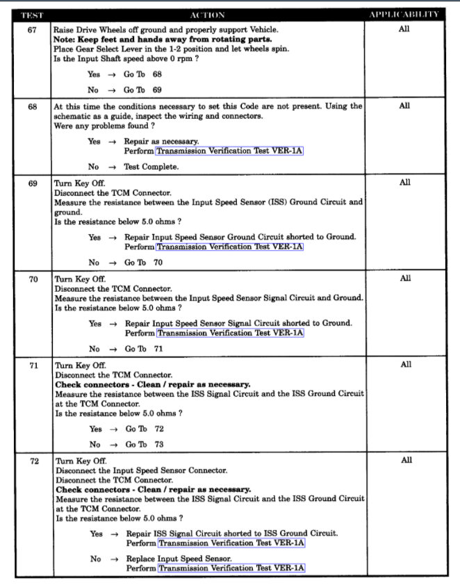

JJONES3235
Get codes codes p0740 and p0715.

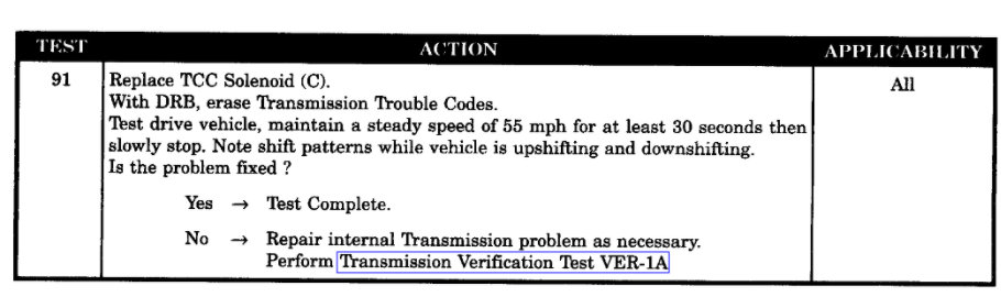

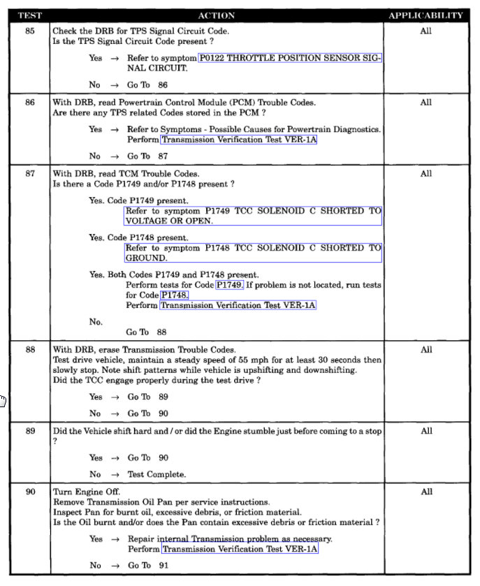

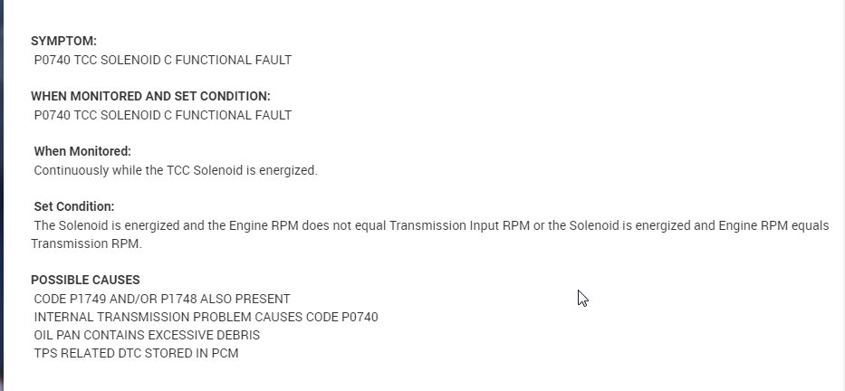

Okay. More then likely the P0740 is causing the main issue. It is basically creating heat in the transmission which is causing the fluid to get hot.
I would suggest diagnosing that code first and then retest the transmission. If the other remains we can chase that but I suspect the Torque Converter clutch is the main issue.
Let me know if you have questions. Thanks
Oct 11, 2020 at 6:49 AM
JJONES3235
Changed out the solenoids. No more overheating transmission fluid.
