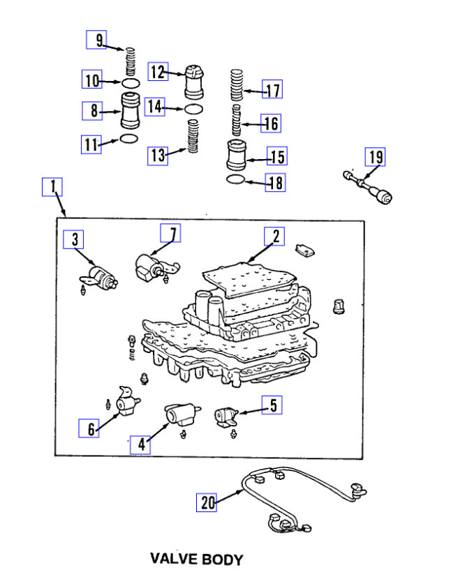

The transmission shifts normally but when I get within 110 and 120km/h. A/T oil temperature warning light comes on, because transmission refuses to shift into the last gear. Note no CEL on the dashboard. Please help
Mar 3, 2021 at 4:42 PM
  • 55,859 POSTS
It could still have a code, I would run the codes to see. this guide can help:
If no codes still it sounds like the pressure regulating solenoid is out which is in the valve body so if you get a rebuilt unit it should fix the problem. Check out the diagrams (below). Please let us know what happens.

Thanks, but I have scanned it several times but no code yet. I just got a new transmission as the other one was burnt due to oil leakage from the torque converter while I was traveling.

Hi, no progress yet. Yes, I have a scanner capable of reading the codes but no codes.
Am yet to open it up to check the pressure regulating solenoid.

I suspect it is related to the pressure regulating solenoid as well. If you can, let me know what you find. I would be really interested in knowing.
