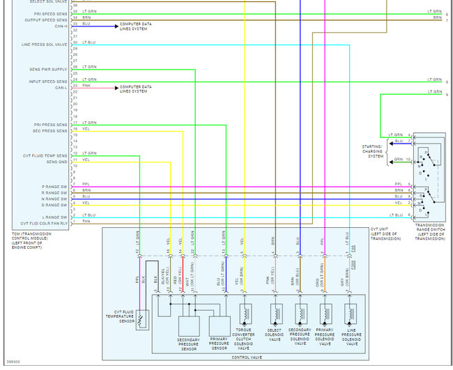

The transmission job was done on this vehicle and the cause was that the CVT chain was broken, and it was replaced. So, I need the troubleshooting of this fault code, wire diagram and fuse box diagram to do the basic inspection.

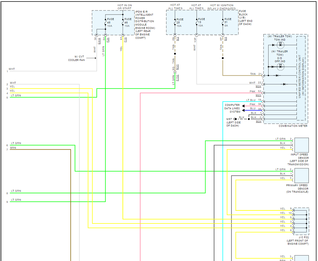

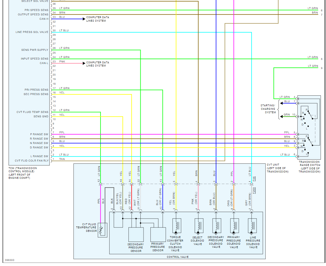

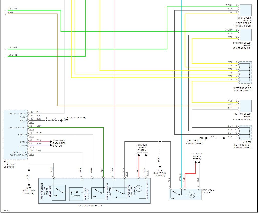

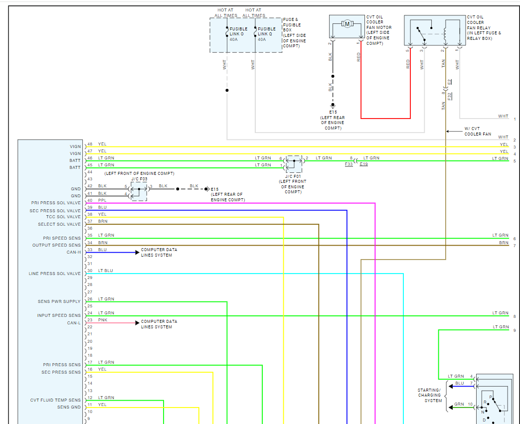

I need the wire diagram for the CVT assembly, both how to drop the valve, fuse box diagram and CVT connector view to do the troubleshooting.
Dec 19, 2023 at 10:17 PM
  • 54,840 POSTS
Sure, here is the transmission wiring diagrams and how to change out the valve body is not available. This guide can help you with the wire testing:
Check out the images (below). Let us know how it goes.
