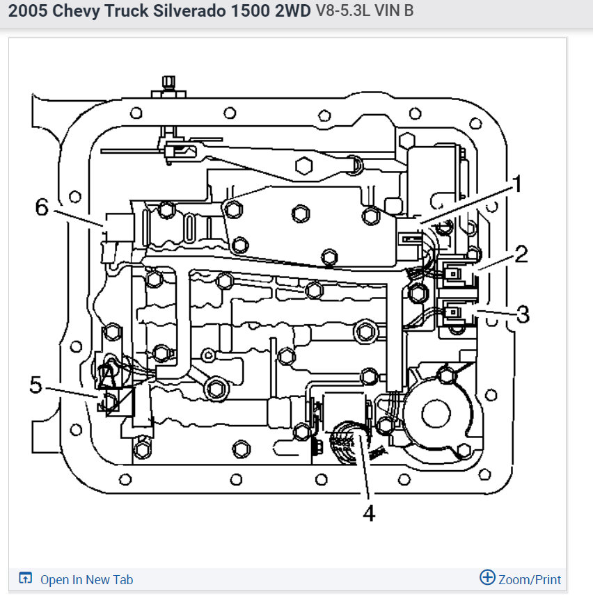

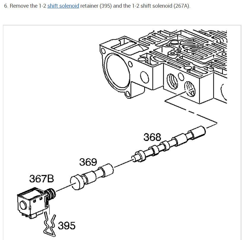

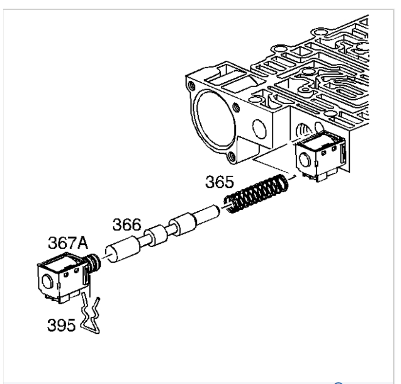

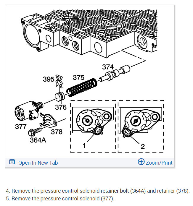

  • 55,447 POSTS
We need to run the codes to see if any are stored, to me it sounds like the 1/2 shift solenoid is getting weak which is common. Please go over this guide and I have included how to change the solenoid out in case code comes up for it.

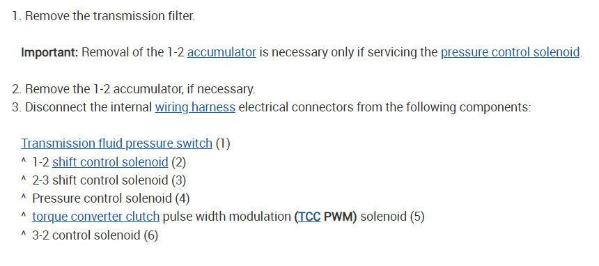

  • 5 POSTS
I had actually put new shift solenoids in it as soon as I got the truck a week ago, I changed all the fluid and changed the filter also. I hooked up my Snap-On scanner and it wasn't throwing any codes, and the live data was showing everything was functioning properly.

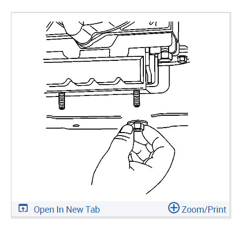

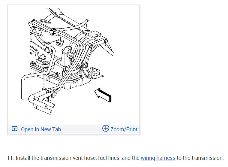

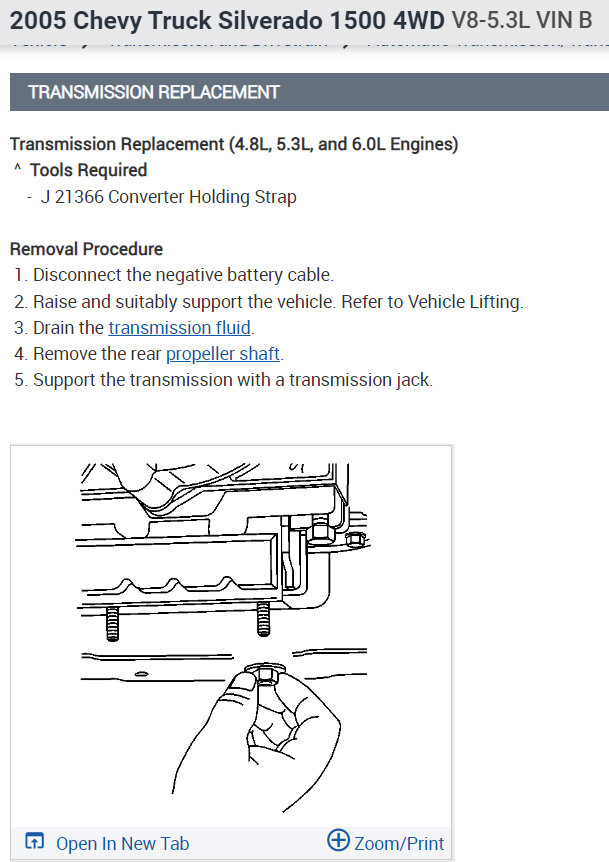

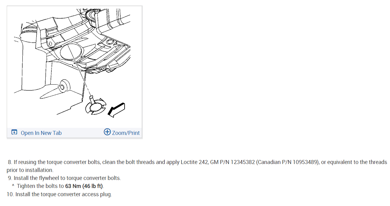

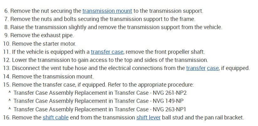

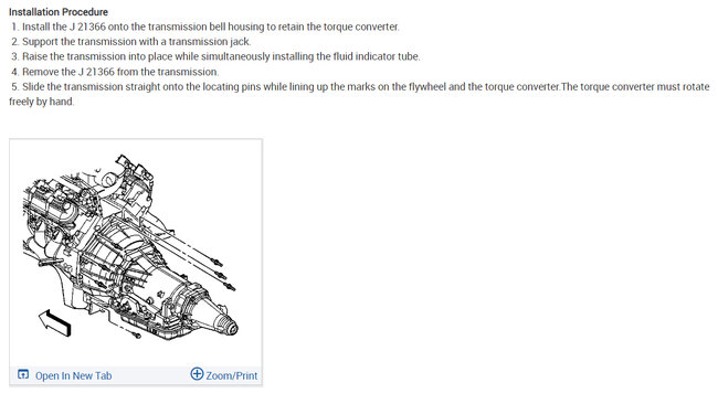

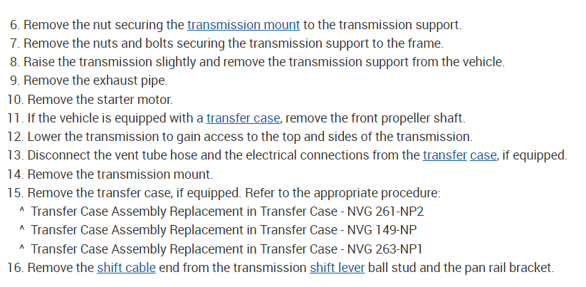

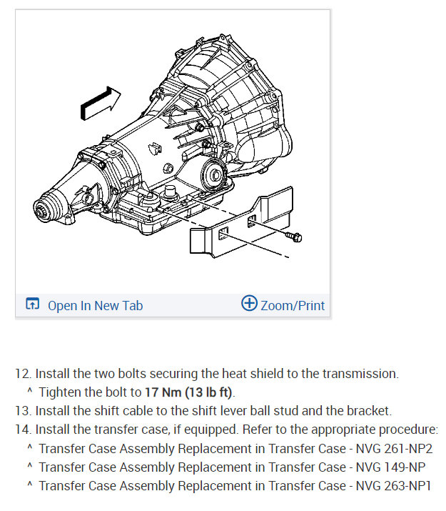

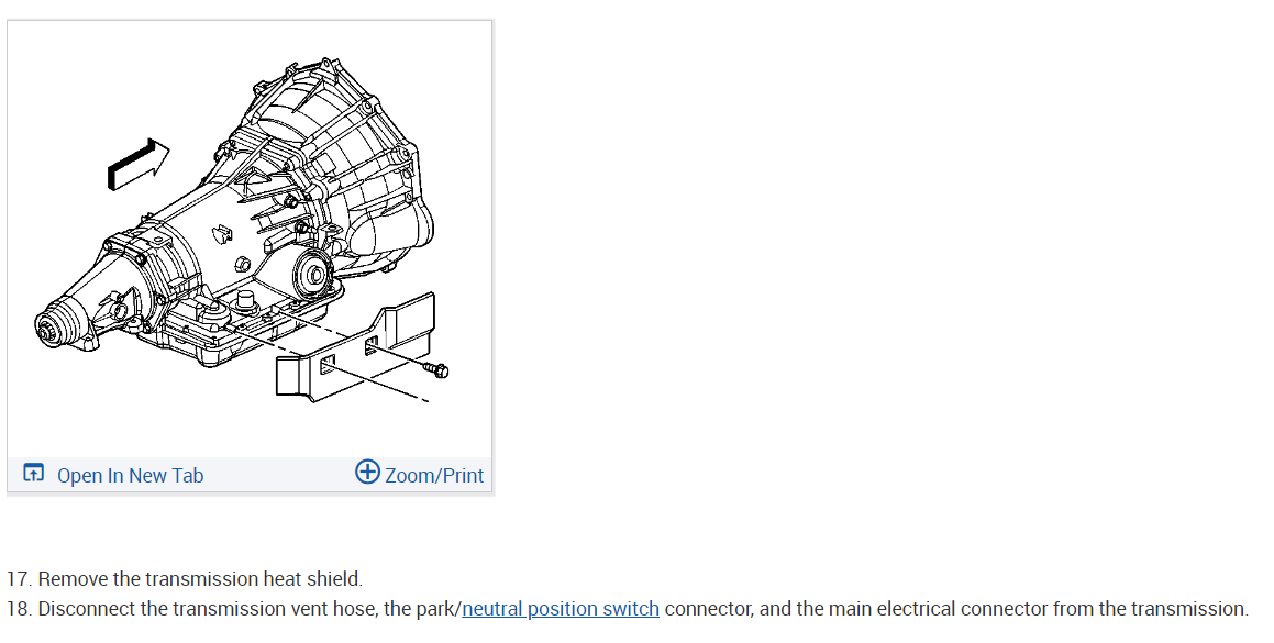

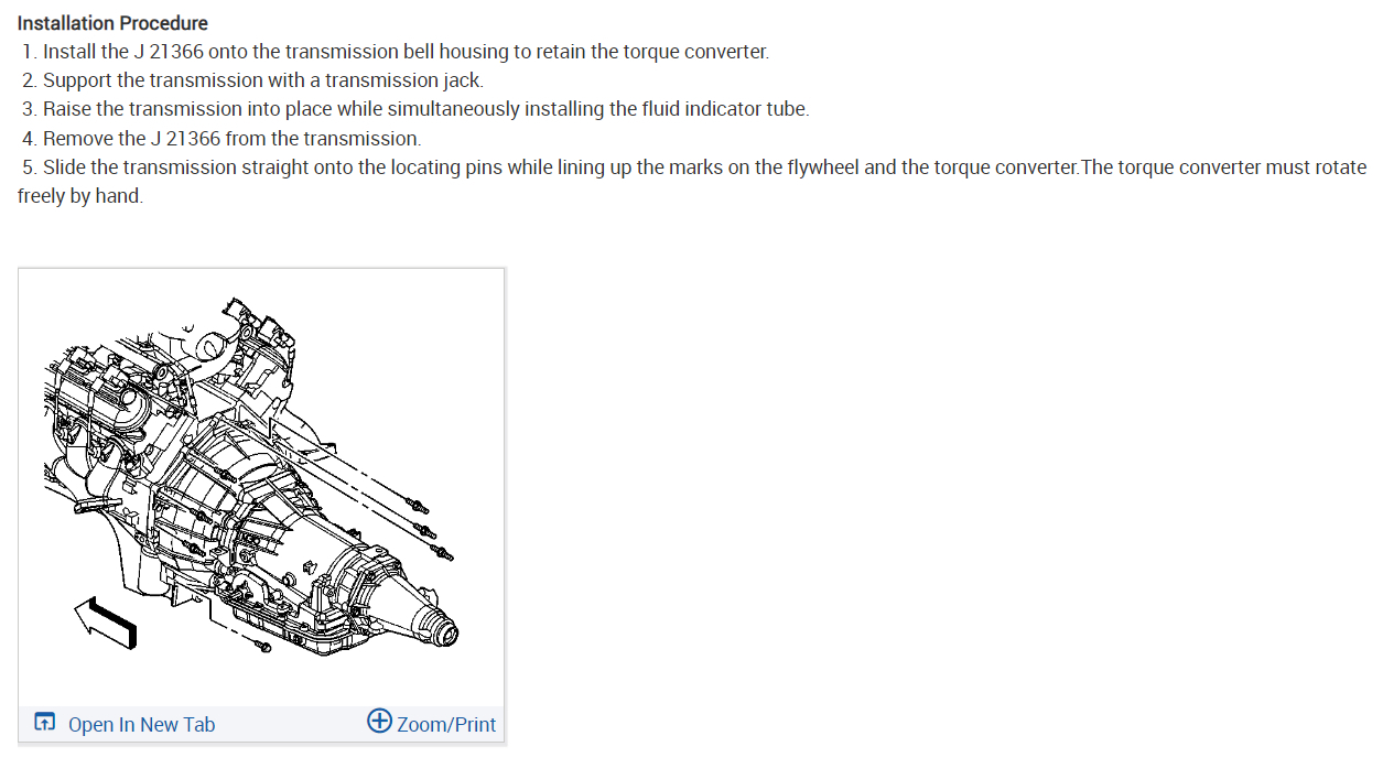

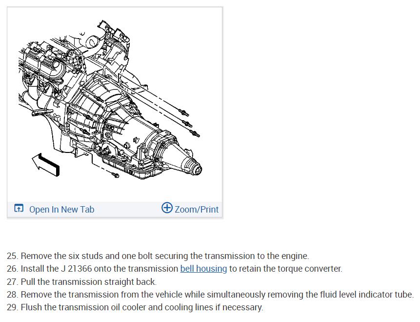

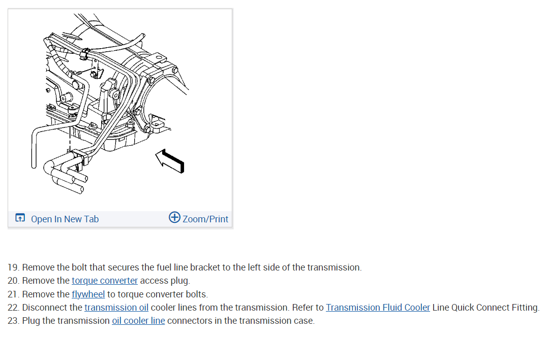

  • 55,447 POSTS

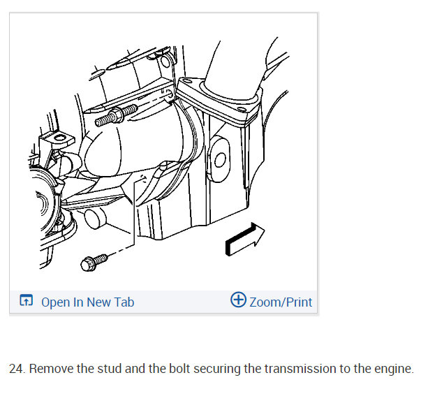

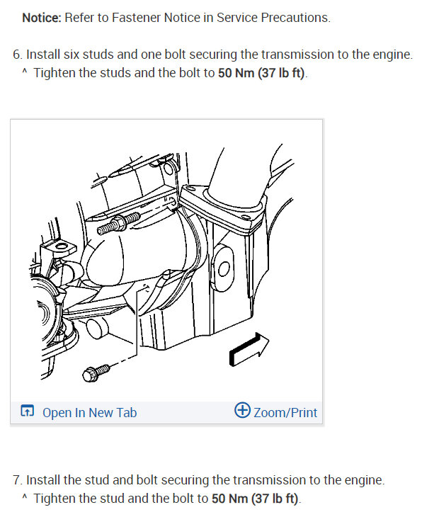

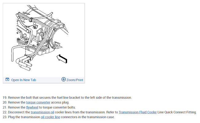

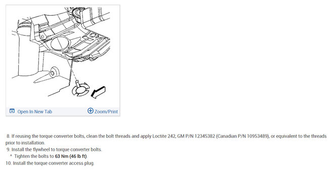

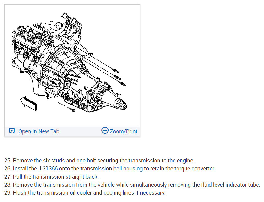

Okay, then chances are there is something wrong internally and the transmission will need to be disassembled for inspection. This video will show you step by step what to do on a similar vehicle and instructions in the image below for your truck.
https://youtu.be/3vJAojsrfuU?si=geobbNxiaqFUf_7o
