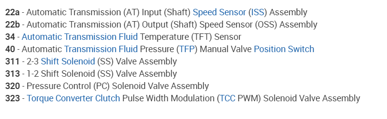

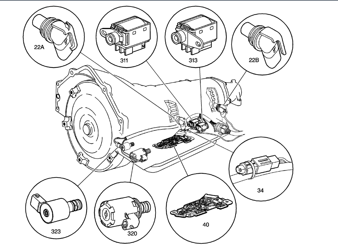

It is common for the 2-3 shift solenoid (#311) to go out or become clogged. here is the location so you can check it out and replace it. Also, this guide will show you how to drop the transmission pan which will need to be done to get at the solenoid:
Aug 15, 2022 at 4:49 AM
