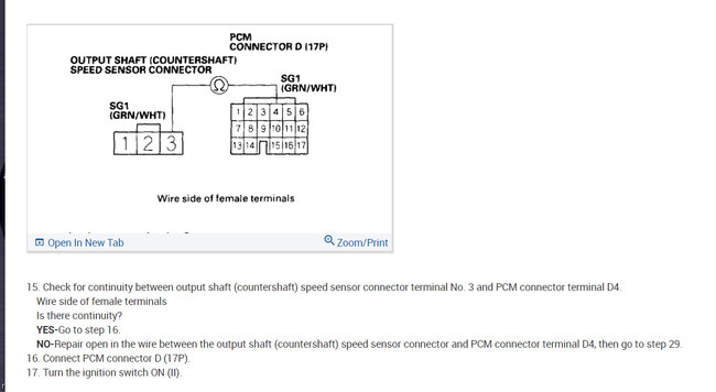

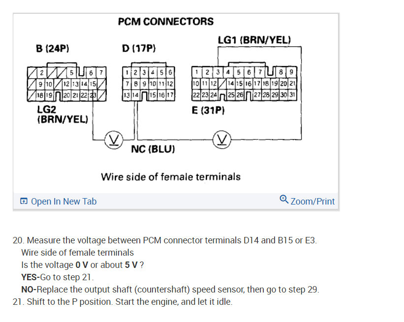

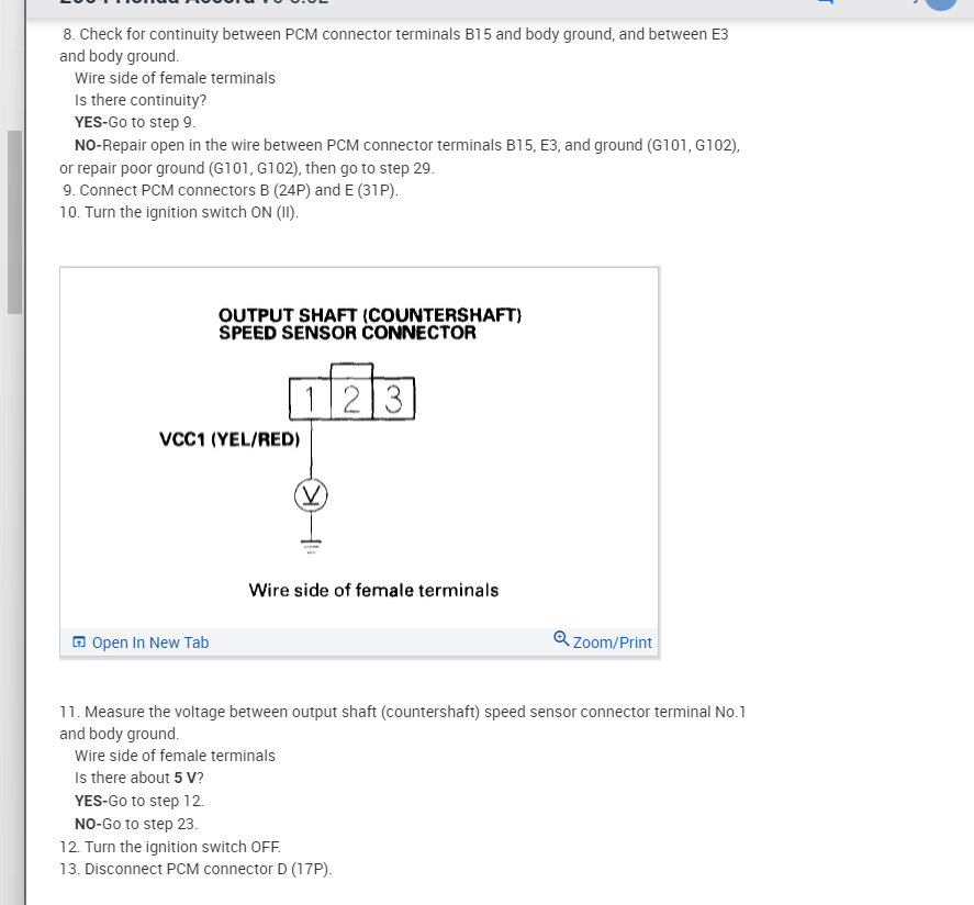

here are the codes i have:
po134
p2251
po741
po721
po741 is pending

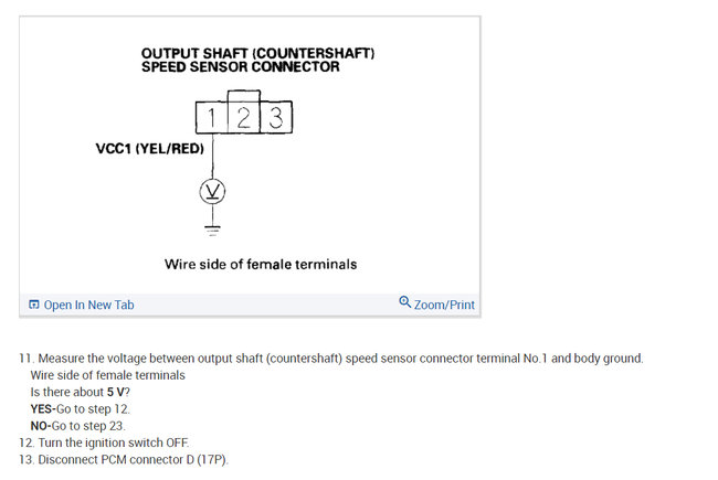

i replaced the output shaft sensor i had to drill it out and now it wont move or delays shift or not at all like it's not registering gears.
Sep 3, 2021 at 8:10 AM

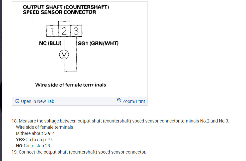

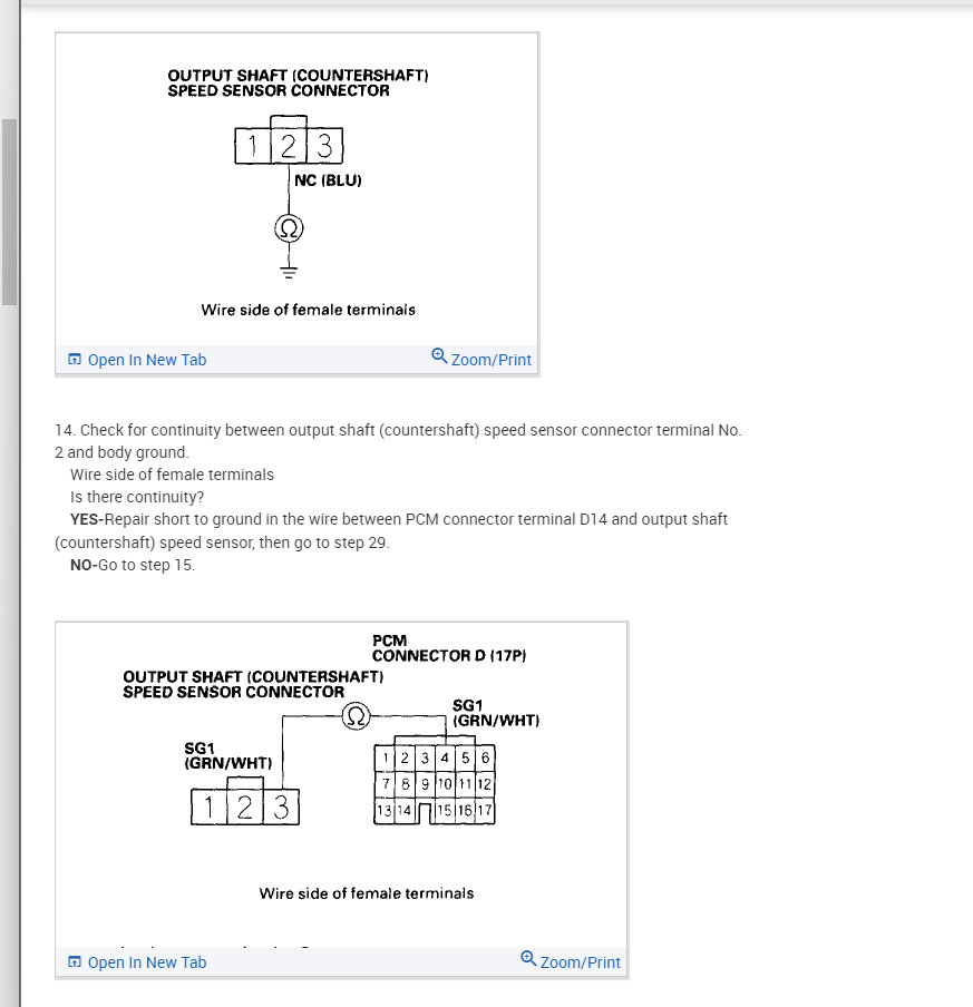

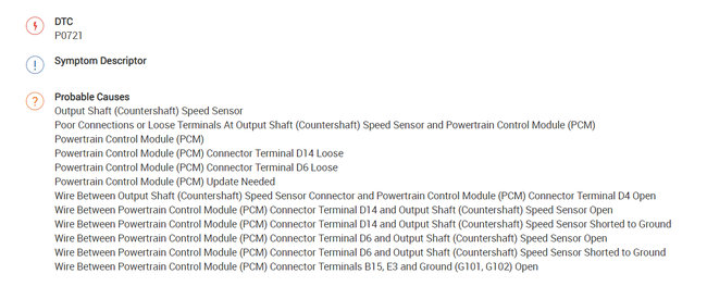

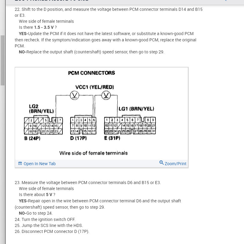

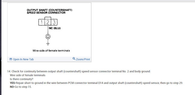

Good evening,

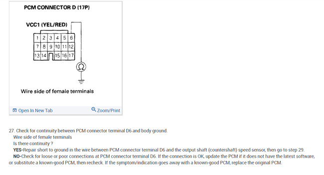

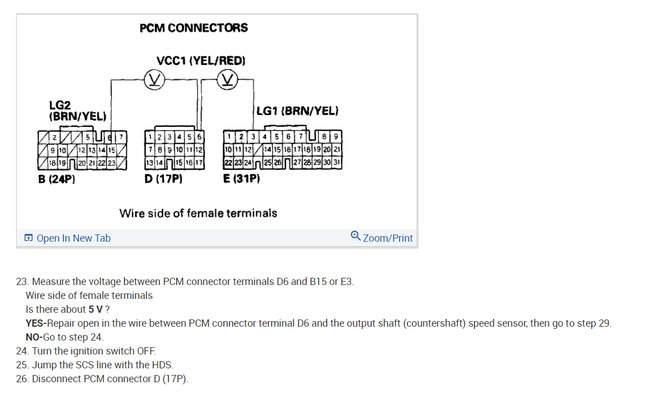

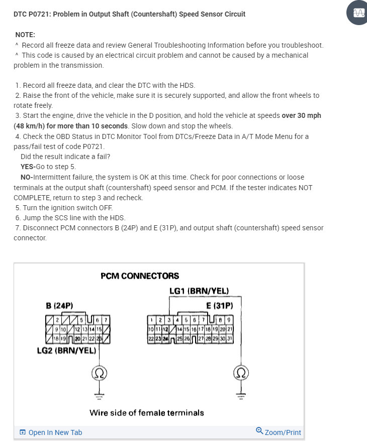

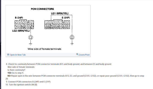

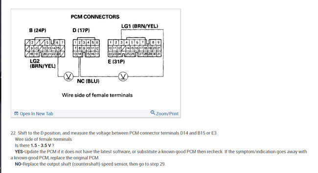

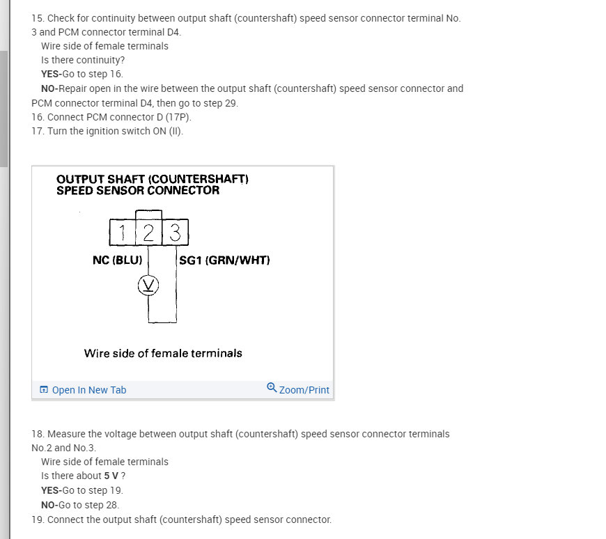

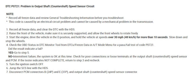

The 721 code is for the output speed sensor circuit. It could be wiring but if it moved prior to you replacing the sensor, I doubt that it is it.
Are you sure you did not damage anything inside the transmission when you drilled it out?
I attached the flow chart for you for the code below.
Sep 3, 2021 at 10:47 AM

What exactly is the transmission doing? Is it not shifting, not shifting correctly, or some other issue?
Any time we have a transmission issue, we must start with checking the fluid.
https://www.2carpros.com/articles/how-to-check-and-add-transmission-fluid
If the fluid is low, then we need to add proper amount of fluid and then retest this issue.
The P0134 - is an air fuel sensor (o2 sensor) bank 1 sensor 1
P2251 - rear o2 sensor bank 1 sensor 1

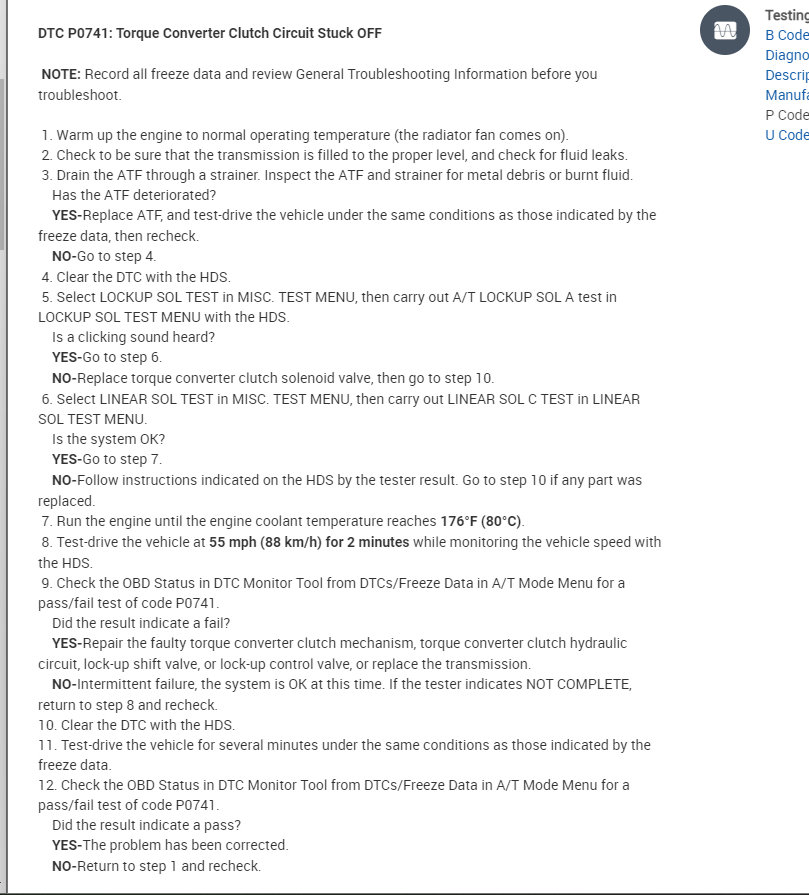

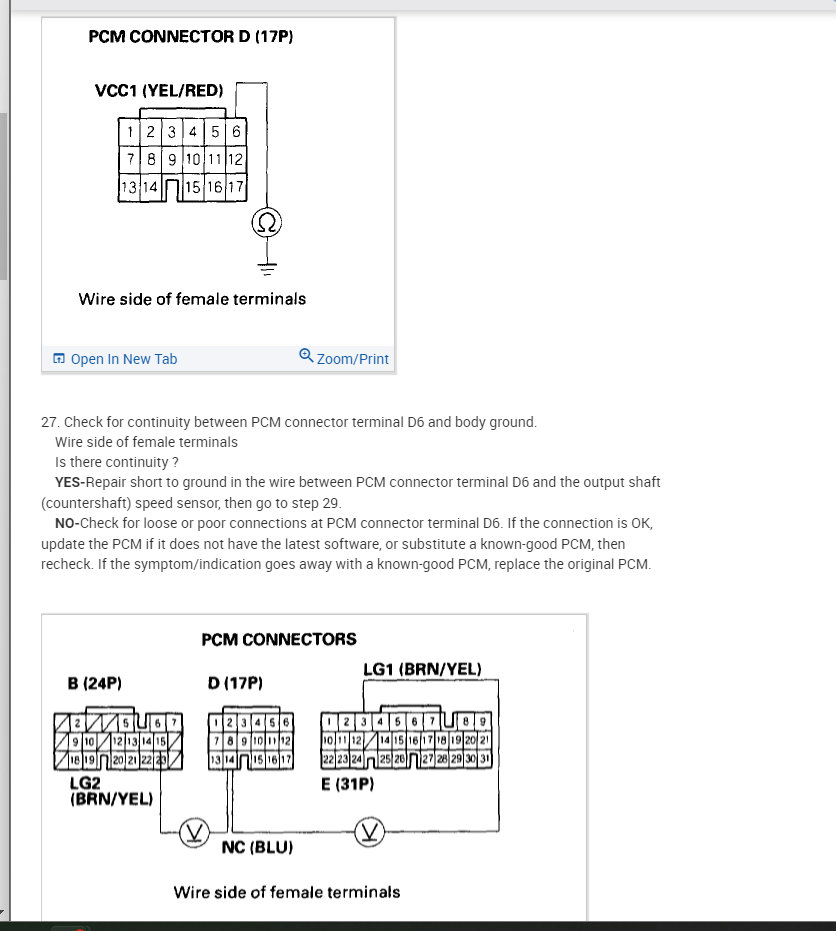

The P0741 is for the torque converter clutch solenoid getting stuck off. Clearly this is going to be related, so I attached the testing below.

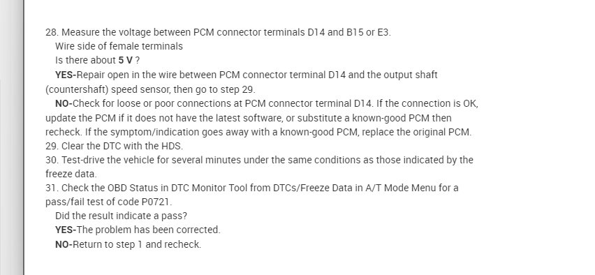

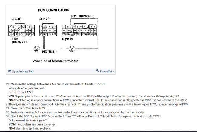

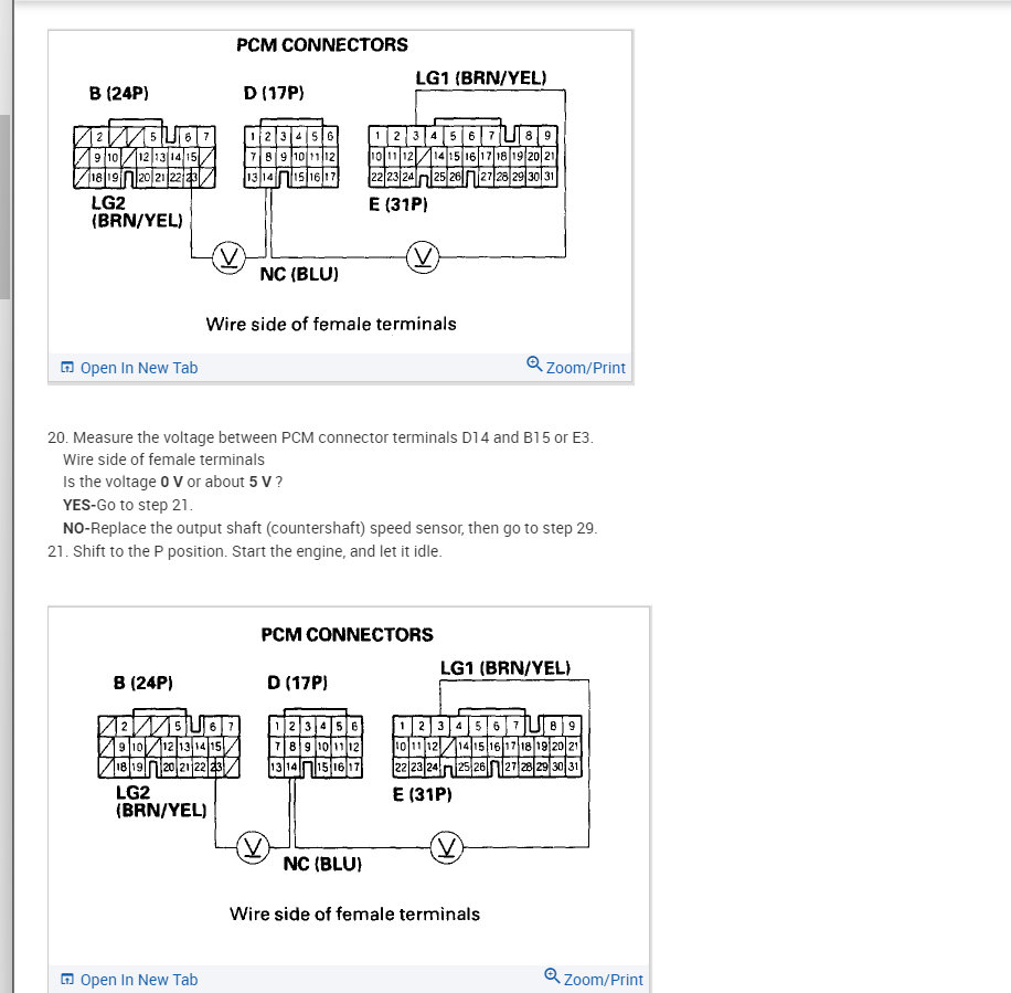

However, the P0721 is the one we need to chase. I am attaching this testing as well.
Here is a guide that will help with testing the wiring:
Please run through the info below and let us know what you find.
Thanks
Nov 11, 2021 at 5:57 AM (Merged)
